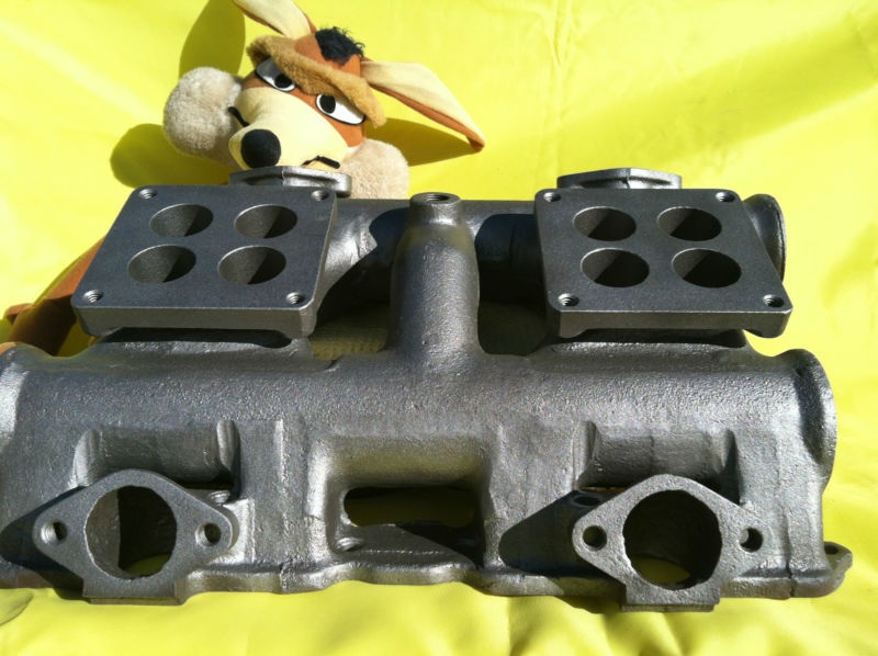

    I have rebuilt the 341 DeSoto engine for my 34 and got lucky and picked a factory dual quad inlet and a pair of AFB's , then I got thinking about a pair of cross ram adapters and picked up a pair , then I got thinking about using four Strombergs instead of the AFB's but instead of them running across the engine I am going to have them in line with the cylinders . What I'm wondering is as anyone else tried this and what do you think are my chances of getting this streetable ?

    Here's a pic

    That looks like a cluster, maybe a twin log 4X2 cross ram or single log would be better, but this probably should be in a seperate Thread.

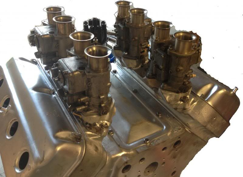

    heres where I am with my cross-ram effort - if this is in the wrong thread please delete or move at will

    Really isn't a crossram. A crossram would have the right side carbs feeding the left bank & vice versa, not going into a common plenum. This is just what I'd call wiard, adaptors for putting 4 2 bls on a dual quad intake. Never been too impressed with such things except one guy who used 2bl to 1 bl adaptors to get a 2X2 set up on a 2X1 intake. Wonder how much of a drop in power vs the 2 4 bls you'll get.

    I've got a pair of AFB's when I get it up on the dyno I will be able to compare , as for weird I love weird

    Besty34, all I can say is that setup looks impressive. Better plan on setting the motor low in the frame, or you will never see where you are going. OBYW a little tape will keep the overspray down.

    I agree, that is not a crossram. It's paying a price - probably 20 HP or more - to be weird.

    Thanks - it will be painted , polished and plated before it goes in the car . I can live with losing twenty horse power but we will see . It's not as high as a blower .

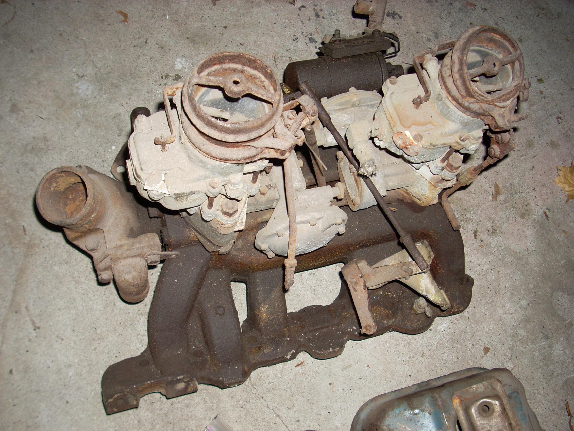

    Heres 2 x 1's was told off a truck.
