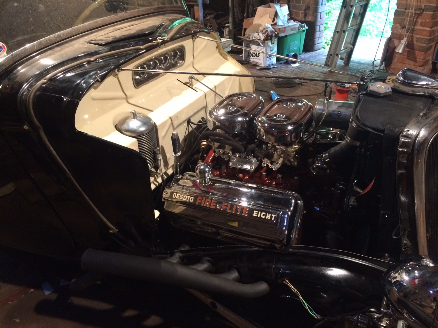

    Here’s my 56 330 DeSoto , it’s been bored out to 341, Ross Racing pistons 101/2:1 comp, Racer Brown cam, DeSoto Adventurer dual quad inlet, two 500 Edelbrocks, Joe Hunt mag, ported and polished heads, larger stainless valves, this is the nicest Hemi I have ever owned .

    Saw this on FB, check out the valve covers. [​IMG]
