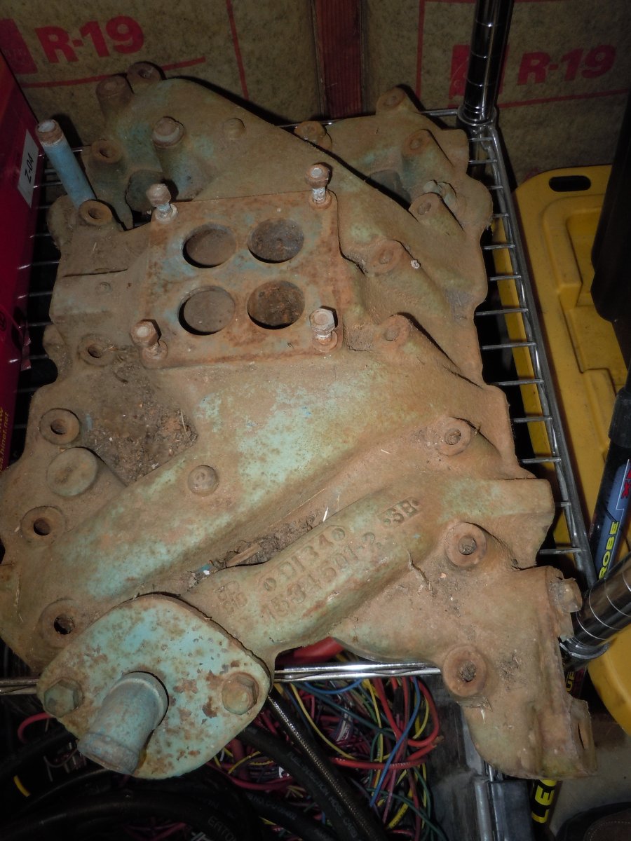

    I actually got lucky buying my 2 motors. Both came with intakes that are probably worth more than I paid for everything
  8. So for heads with water ports , that would be be 55 and up you need a water crossover and it has the thermostat housing. Check the link.
    https://www.jalopyjournal.com/forum...overs-whatcha-got-because-this-sucks.1044305/
    For the ‘54 down, truck, or industrial heads you need to run an intake with the thermostat housing built in, or run a remote with hoses by utilize the intakes ports or drill holes in the heads and tap for npt fittings or if you can get TR waters to let loose of some of his super cool water blocks.
    That 1954 intake is the only factory 4bbl with the thermostat housing. It fits but doesn’t function so good on the 53 heads with small ports. The 51-53 heads have smaller ports and valves. Great for building low end torque but run out of breath on the top end. Great for a street car geared right. Not good for high rpm race car.
    The 54 heads have the bigger ports and same core castings as ‘ 55 heads (555) but no water ports.

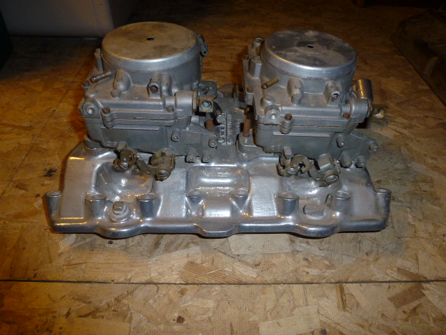

    Right now I have 2 options with what I have.
    51 heads and 54 4bbl intake. Easy and all bolts together with no extra water cross overs etc. Then sell my Weiand 2x4 and Carter carbs.
    Or
    51 heads with my Weiand 2x4. Looks cooler than the single 4bbl. But have to add tstat and water crossover.

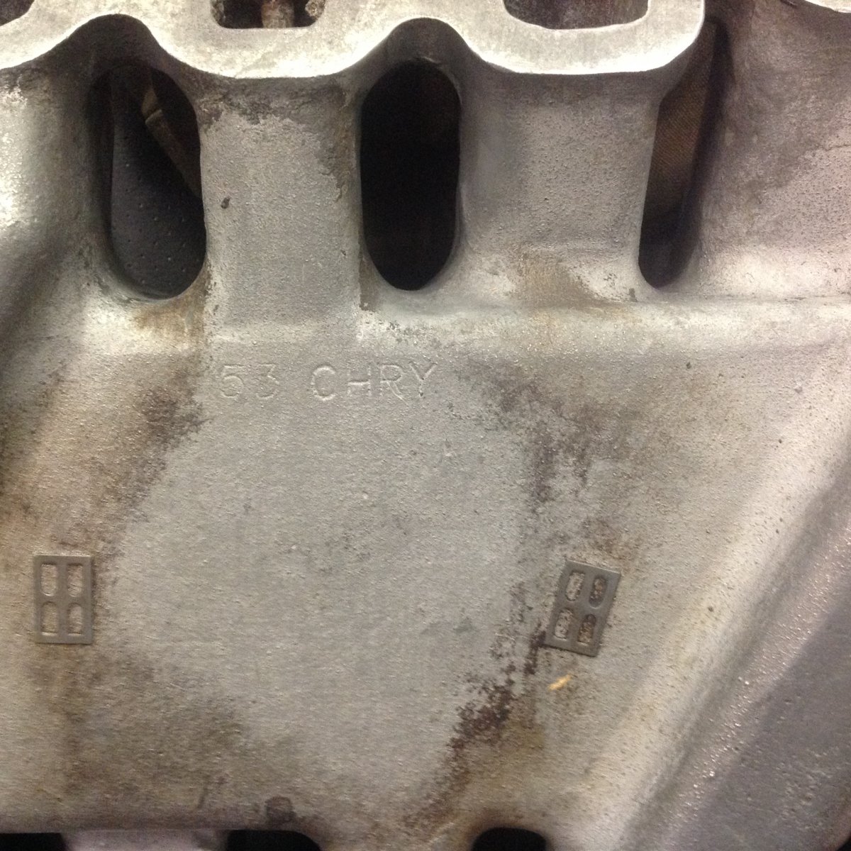

  16. 2x4 design for 51-53 heads
    Edmonds took the ‘52 4 bbl carbs and made the manifold to fit hemi in 53. Then Chrysler switched up the heads in 54. There’s another manifold just like it for 54 heads but it’s different looking with larger runners.
    They’re kinda rare because it’s sorta like 1 year production. The 2x2 had a longer production run from edmunds

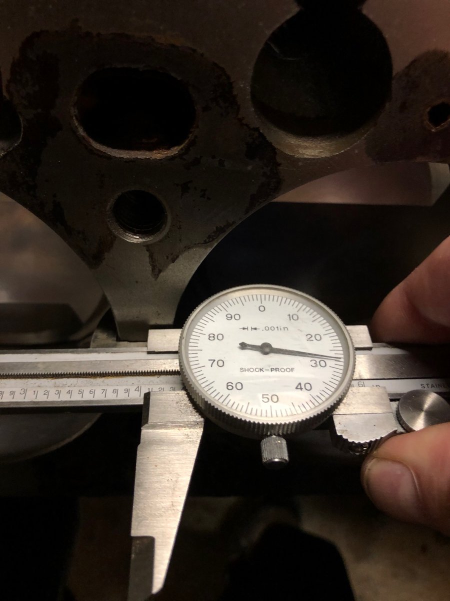

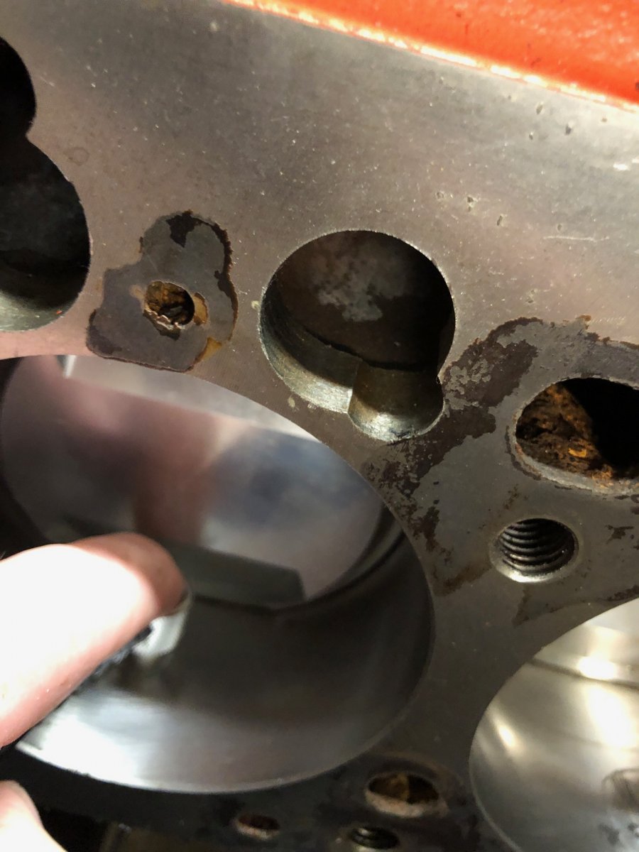

    Known engine facts: 58 354 truck block #1619829 / 54 large port heads (no water outlets) / Venolia pistons .40 dome / Sat for 15 years + after rebuild. Disassembling it to check and clean everything and piece of mind.
    I am hoping for a little more help on this engine I bought many years ago. Never, never, never buy an already "built" engine without hearing it run or a complete breakdown of what was done!!! That said, I broke my own rules because the price was right and emotions made the purchase happen. I got some great advice earlier in the valvetrain section and now I'm down to the short block and I got scared with what I saw...
    When I measured the cylinders, it is bored to 4.030, yeah an .090 overbore. When I saw this my hopes all sank into the toilet waiting to be flushed. I had no other blocks and life can't allow the funds to start over :( I kept my chin up and purchased a sonic tester to confirm the worst. I also spent a lot of time reading about max overbore, wall thickness, cylinder failures Including one from Scooter on and 4.040 354 truck block failure. When I got my sonic tester and started measuring the mystery deepened and I just don't know what to make of this thing anymore. Granted I still need to measure the bottoms of the cylinders after the pistons come out but here is what have...
    Bore size
    Bottom thrust side
    Measurement - 7.3mm = .287 inches
    Upper thrust side - 6.1mm = .240
    IMG_4895.JPG I measured all the cylinders and they all measure within 1mm of each other. I set my tester up for both hard cast iron and steel, readings withing 1mm of each other. I calibrated it, I checked a portion of the deck where I can get a micrometer in and it's really close to an actual measured thickness, I cannot see any evidence of sleeving, but I just may not be able to see them on the deck. I realize more comprehensive measurements are needed once it is apart but I never thought I would see these thicknesses. Thoughts?

    Joined: Jan 1, 2005
    Posts: 7,265
    George
    .040 too much, even using "Rule of Thumb". Sleeve it or junk it. @ $100 per cyl (typical) that gets expensive. Scooter's was a 331.:eek:
    Work In Progress likes this.
  20. Work In Progress
    Joined: Dec 14, 2010
    Posts: 153
    Work In Progress
    Even though I still have that much meat left in the cylinder walls?
  21. I don’t see a problem,
    That’s thicker than sleeves are .
  22. You really don't know much yet. Once you have it apart, then you need to sonic test every cylinder - in about 12 places each. You do every 90 degrees around the cylinder and then top, middle and bottom. Pay particular attention to the major-thrust side of the cylinders - it is a different side of the cylinder on the Driver's versus Passenger's side. On the drivers side the major thrust is the intake side of the cylinder on the passenger side it is the exhaust side of the cylinder (clockwise rotation). These are the two sides of the cylinders that take the most load and therefore you're most concerned about cylinder wall thickness. Once you've done all these measurements, then you'll have a much better idea as to what you're working with, is there any "core shift" in the block, etc..
    73RR and Work In Progress like this.
  23. from an article,,,,
    ,,,,with a ball-peen hammer to get a closer look at the damaged area. Though the cylinder wall generally showed plenty of meat, the source of the problem was readily apparent-a thin spot in the wall about the size of a nickel was not as thick. The flaw was in the highly loaded thrust side and provided a spot for the wall to let go.
    So sonic check it like your hunting that elusive thin spot. Fill it to the core plug holes with Hard block.
    Most selves are 0.125 or less.
    There’s story after story with proof the overbores can be stupid and still the engine thrives. Then there’s story after story with proof that overbores fail. How Lucky are you feeling? What’s your alternative? How will you find out? What’s the worst that can happen?

    Is filling the block to the core plugs ok for a street use?
    Since I have the tester and my time is my time, I plan to do very thorough testing with it.
    At this point, not much more of a risk. Either way it will become an expensive conversation piece. I can part it out for what I have in it but it would be sad.
  25. check it the best you can, of course.
    After you’ve checked every square centimeter of the bores, then worry when you find the thin spots. Core shift happens.
    If it passes sonic and The thing breaks, then you worry about fixing it or sleeves or like do everyone else does when their shit breaks.
    Yes you can fill the bottom of the block on a street car.
    A great big bunch of street cars have their block bottoms filled with rust, crud, scale and casting sand. Some are even hard block filled.
