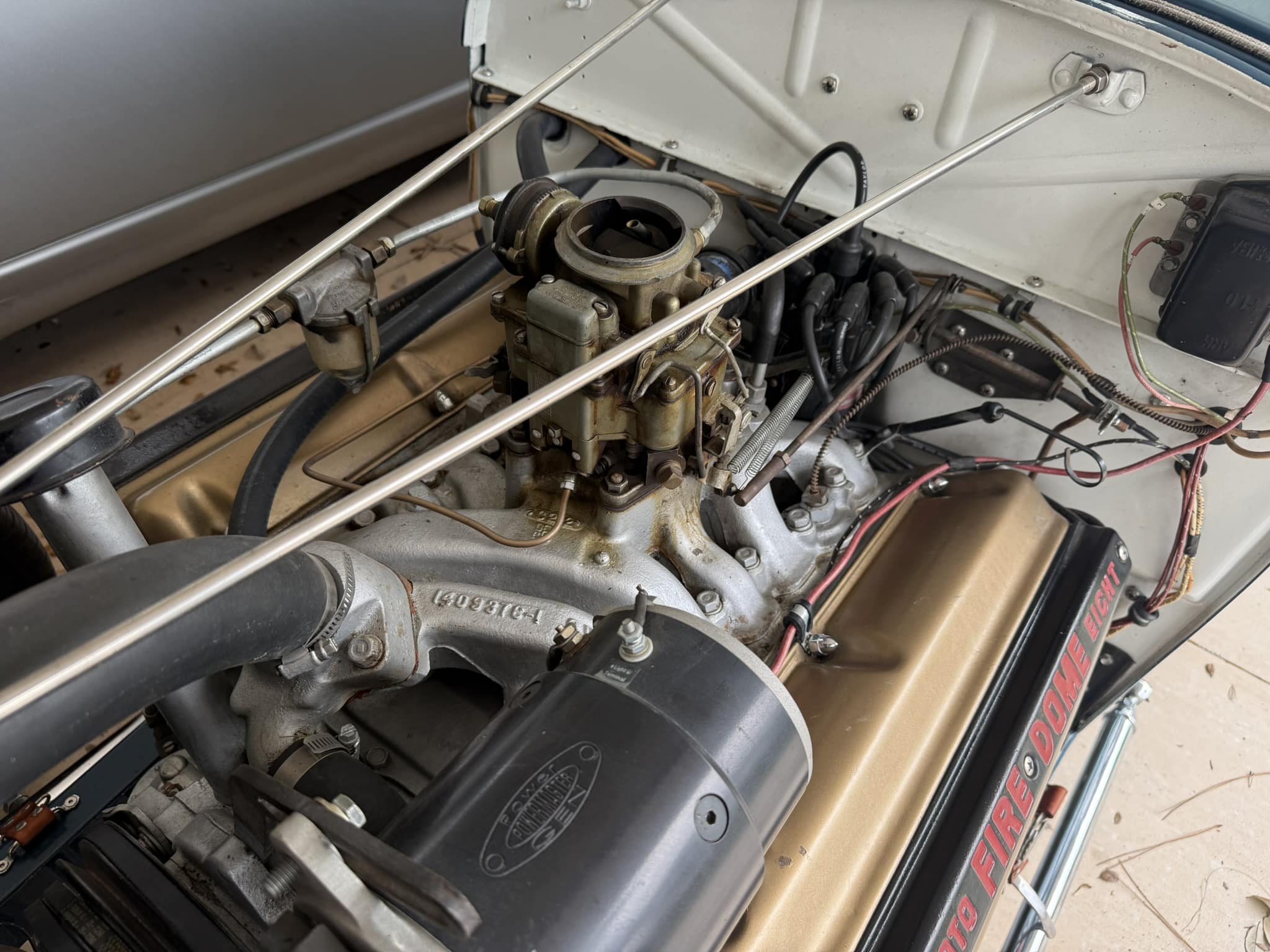

    For about a year I've an annoying issue with the roadster. The '52 DeSoto Hemi has an (increasingly occurring) stumble accelerating right off idle. It seemed that it's a "too-lean" issue, and I had tried to overcome it by enriching the choke setting. (I know, I know, that isn't the "right" way, but I figured it was worth a try, right?)
    This morning I let the car idle in the driveway for a few minutes while I did something, when I walked behind the car my new, brushed concrete drive was stained with black carbon from the exhaust.
    Crap.
    So, I thought about the problem for a minute while I drove to the grocery store, increasingly annoyed with it stumbling and coughing, figuring that a 4 year diet of 15% ethanol regular might have something to do with this increasingly noticeable problem. When I got home I looked on-line for a carb kit for the obsolete, 2 year only Carter carb.
    Guess what? Two clicks got me to a supplier, and $95 later on my debit card I have a rebuild kit coming for it.
    I'll have it in a few days, and will be anxious to see if my diagnosis is correct and I can dial the choke back to where it's not flooding to overcome this.
    83FBAB61-08AE-468B-9CCF-568DBE570BF6.jpeg FD1835A7-C2CE-45AE-BE5E-4A3C547EA810.jpeg

    This type of problem is often a bad diaphragm or cup in the accelerator pump and the ethanol mix gas attacks rubber even faster. If it was a modern carb they make accelerator pump replacements that are designed for this crap gas, but yours being an old carb will likely require you to rebuild it every so often until the carb gets replaced with something modern that accepts the modern accelerator pump diaphragm.

    I’d have to lean toward the carb. Probably the accelerator pump. Gas these days is terrible. Basically rots the rubber in the older carbs

    Whelp, I think I fixed it. My wife had a health issue (actually a Pickleball injury) and surgery, so for the past couple weeks nothing has happened hot-rod wise. I'd ordered a carb rebuild kit, got that then she got hurt and haven't messed with it. Today I took a few minutes after thinking about your post and got after it...
    I was able to bump the timing ahead (it must have moved or I hadn't tightened the hold down), and gave each idle jet a quarter turn.
    VIOLA! It runs like a raped ape now, NO stumble off idle, idles so smooth I could balance a quarter on a valve cover, and, it starts better. Not that it was bad before, but it barely rolls over now and it lights. I didn't have enough timing before, it seems really happy now, so thanks for making me think about this for a bit. :)
