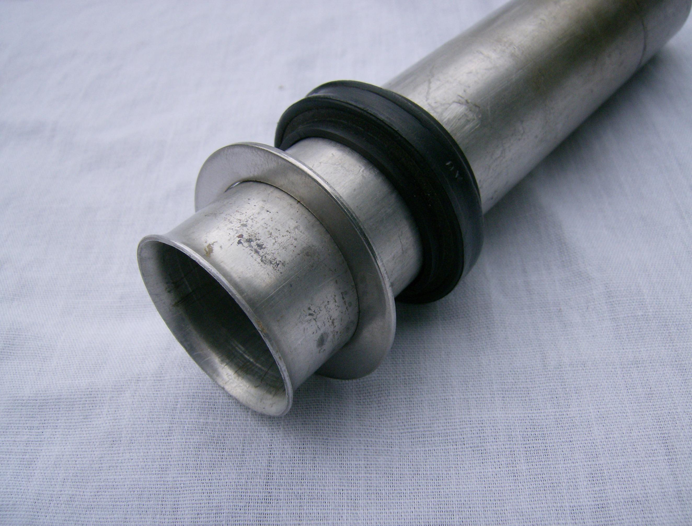

    I'm picking up some more 354 Hemi engine parts for my rebuild.
    My question is should I be getting a set of spark plug tube washers.
    Or is it more advisable to run with just the tubes and rubber seal (no washers).
    I will be running stock valve covers with stock wire covers on as well, will this matter.
    Thanks

    If you are talking about the large washers on the top of the tubes and are going to use the long spark wire covers, yes. They hold the rubber washers tightly to the valve covers.

    The tubes themselves do not hold enough pressure on the rubber to seal. I make both the replacement washers that are used with the wire covers, as well as a slightly smaller ID washer that can be placed under the tube to hold pressure on the rubber seals.

    After reading your post I think that you need the washers that go on top of the rubber seals as Ma Mopar made em. The tubes were always regarded as a tuneup part and after about 5 or6 plug changes were replaced. Never install a spark plug in a hemi with the gasket on it as the plug tube acts as a gasket.

    I don't like the looks of the washers. Are they held down by the sheet metal strips that cover them? My Desoto will have O-rings with clear silicon sealant. I'm gonna put the tubes on the lathe and roll the tops down just a bit to better hold the O-rings.

    The problem that I have with not using the wire covers (which I actually like) is keeping garbage out of the tubes. Yes, a 426 boot can be installed but it really dosen't 'seat' on anything, the grip on the wire is all that keeps it in place. And, yes, if you use 8mm wire then the grip is stout.
    Here is what I came up with years ago for a customer who had some demands...
    I machined a die to flare the top of a 426 tube so that the 426 boot would snap over the lip and be close to the valve cover.
    Also, keep in mind that the steel tubes offer some opportunities to do some mods of your own if you can think up a better way to seal things up.
