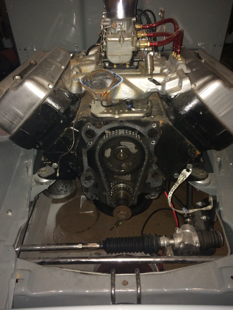

    Does anyone from experience know what these motors prefer for camshaft timing? This motor just wants to scream..... I’d like to get the power band down a little bit. The motor is a 345 desoto stock compression ,the cam is reground to 220 degrees @.050 108 lsa, I know they say most new cams have about 4 degrees advance built in, I don’t race the car, just street driven, it was set advanced 2 degrees by the timing marks( never degrees the cam) looking for some input.

    I'd get a wheel and pair of mag base dial indicators and see where it is..... I put 6* in a RV cammed 355 in the mid 80's and really woke it up. An Isky "Mile-a-More in 70's had 8* in it and wouldn't turn a 400" over 4200, but could pull a trailer and cabover camper up a 5000' pass at 60-65 mph no sweat.

    Really need to know "where-the-cam-is-at" by degreeing it in. My custom ground cam was ground "straight-up" (NO advance). I don't know if ALL custom cams are that way or not and....neither do you! That's why the degree wheel is a must.
    You said it really wants to scream?!! Advancing the cam timing WILL move the power range down some. That's why a radical grind cam (lotsa duration and tight LSA) will sometimes calm down some if you move the power range down some...by advancing the cam. It lets the cam sorta "come on" at a lower RPM.
    But....that is sort uva band aid approach. If its a "high winder"perhaps a cam with less duration is in order. If you lik'em kinda snotty.....then 108* LSA will give it to you . The smaller the cubic inch engine......the snottier(is that a word?!;)) they will be at that lobe separation angle.
    Hey.........I'm just an unemployed welder...what the heck do I know about camshaftery(is that a word too?!:()
    Degree it and we will all know what it is.

    By the cam card the cam has no advance built in, it’s a reground original cam in this motor so it was 108 lsa from the factory, not really a wild grind.... I should add that last year I was using a torque converter that ended up having a stall rating of 1800rpm, that probobly did not help low end power at all, changed it out for a 2800 stall, I’ll degree the cam tonight and see where it’s at and then I’ll go from there, the engine idled very well.... almost too well for the cam that’s in it..... I was actually thinking of setting it back straight up

    Well it turns out that after checking with a degree wheel it was retarded 3 degrees not advanced 3 degrees, I guess I I mixed up the mark on the crank gear. I think I’ll be happy with it set straight up, I appreciate all the input from you guys
