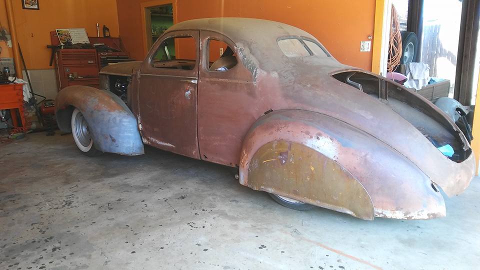

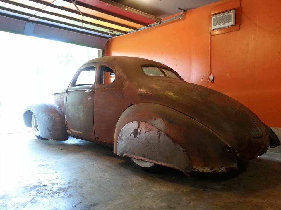

    Tear down in progress. I have no idea what to do with the original front and rear suspension so if anyone needs it, let me know ASAP. Its not worth anything to anyone but a restoration guy. And those gotta be few and far between.

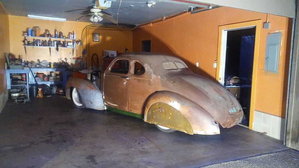

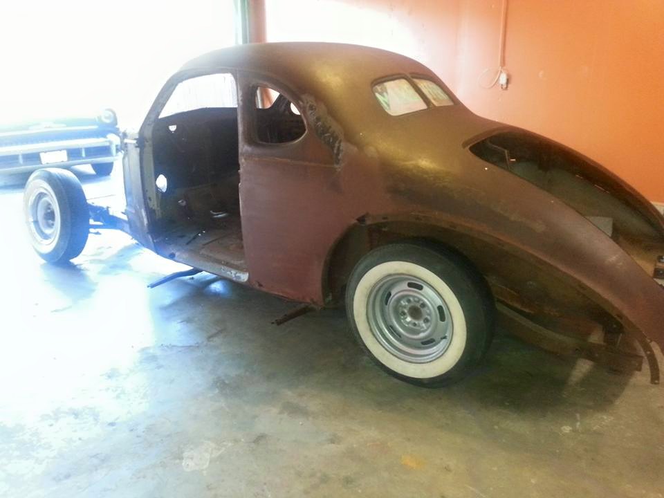

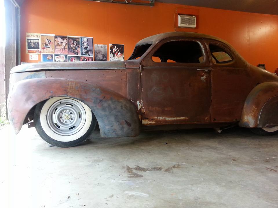

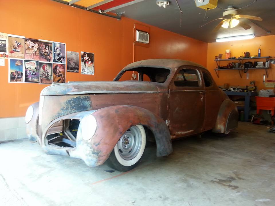

    fenders back on for now

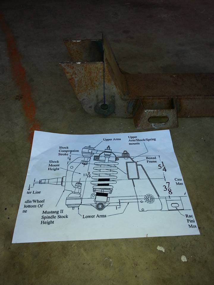

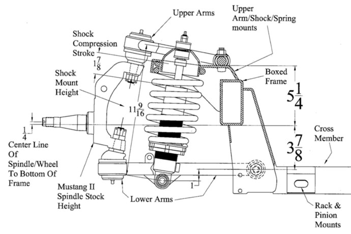

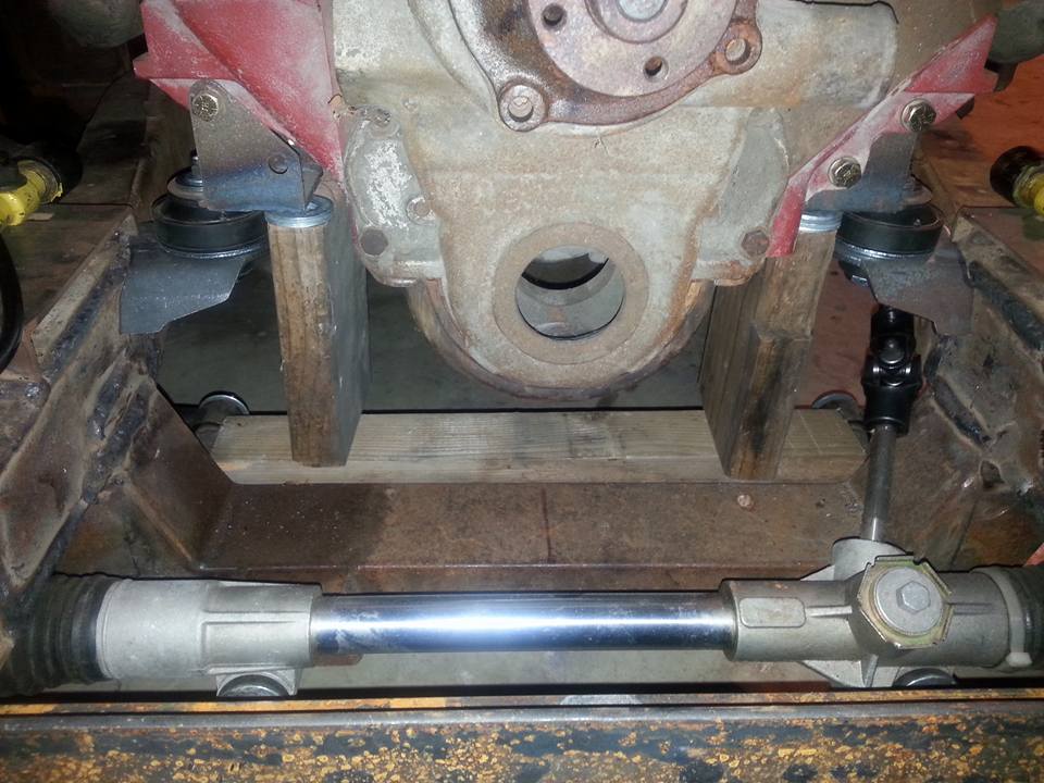

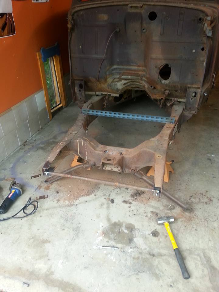

    Well this has been collecting dust while I did a few other things but its back to the grinding wheel on the 39 studebaker again. Ive decided on the MMII frontend and I picked up someone elses cast off from Craigs list sometime back and I knew I was going to have to modify the CL crossmember quite a bit to make it work on the super narrow 22.5 inch distance between the frame rails. I found these 2 prints on the web and after more than a few grinder cut off wheels the old crossmember is out, frame boxed and the newly modified MMII is mocked up at ride height. M1.jpg M2.jpg S55.jpg s74.jpg s75.jpg

    And for the removal, grider cut off wheels and a sawzall were my best friends!

    s85.jpg s86.jpg Its finally all cut, fit and tacked in place

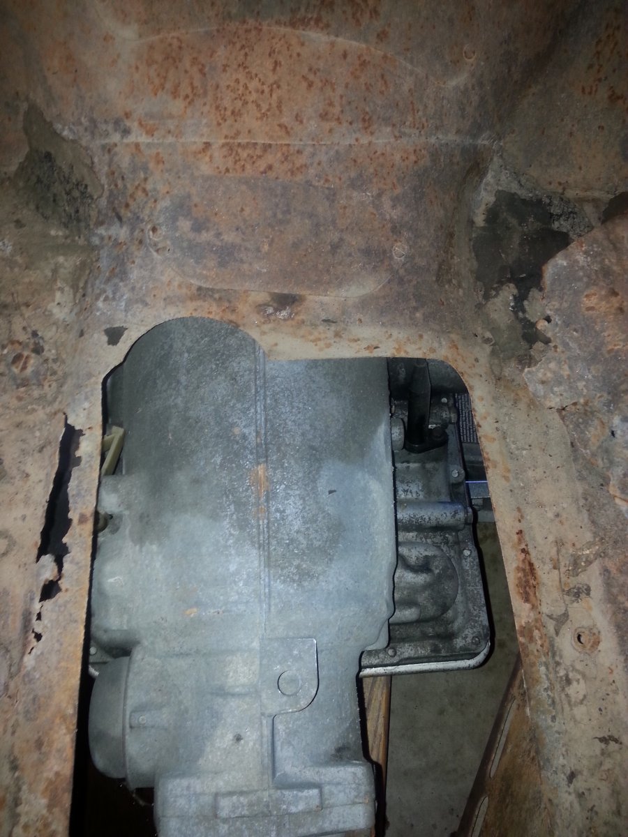

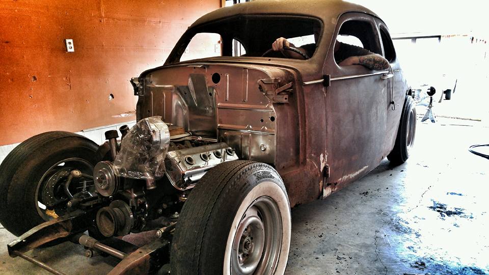

    S101.jpg S102.jpg S104.jpg S105.jpg Well the Hemi & 700R4 are now between the frame rails!
    As of now I have not had to cut any floor, firewall or frame, but I am going to start trimming the floor so it can come up a few more inches.
    I would like the center of the tail shaft to sit a little higher in the x cross-member and then I can level the front of the motor so the intake is parallel to the frame rails. I was really happy that is as close as it is for a first stab at it. I still have about an inch between the firewall and the back of the passenger side head. I have to get the front clip back on to make sure I have radiator clearance but I think it will be just right.

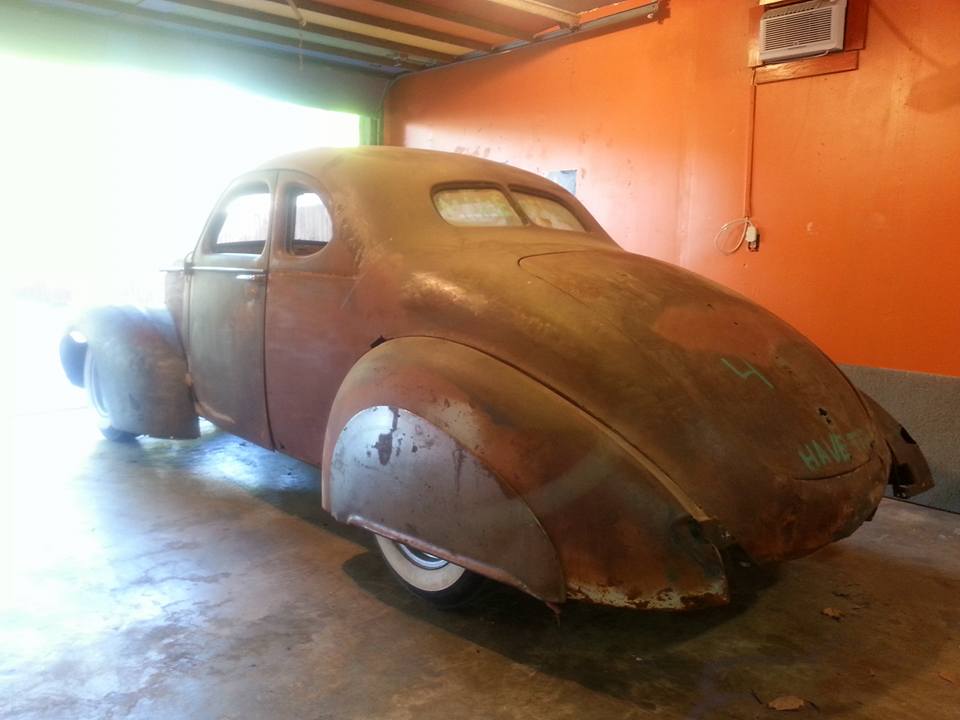

  26. Krash Vegas
    Joined: Jul 18, 2006
    Posts: 476
    Krash Vegas

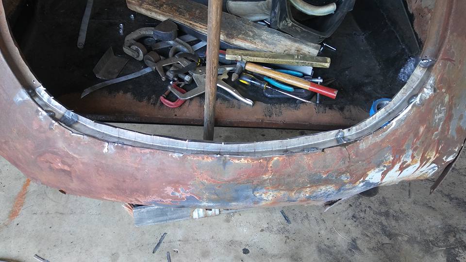

    Finally started the part I have been dreading.. trunk seal repair. Its going better than expected.
    Waiting on my shinker disc to arrive so I can finish fit the thing. Lots of damage on the tail pan from years of being unsecured.

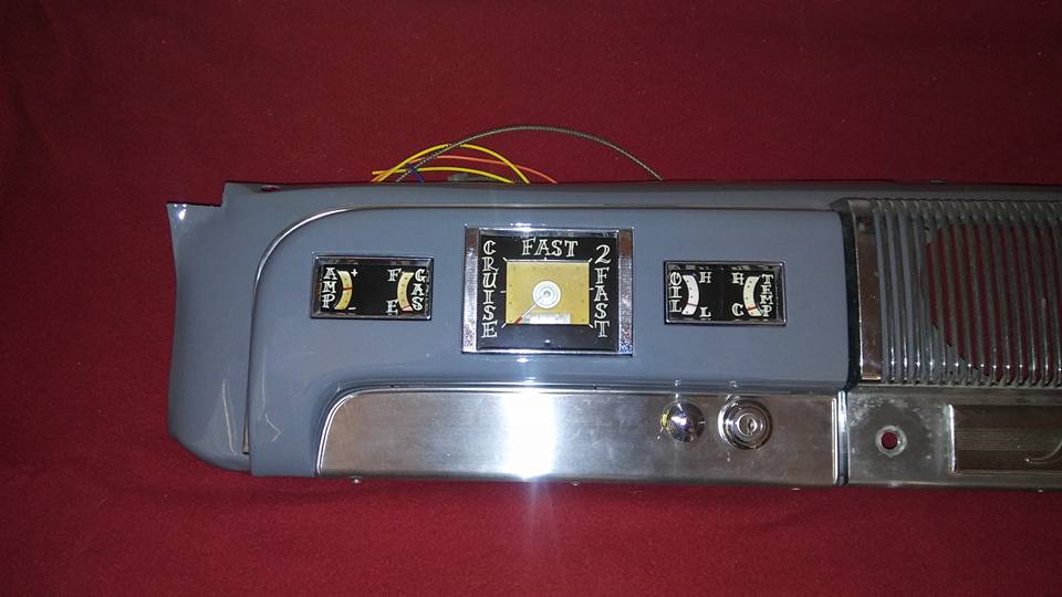

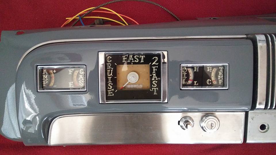

    The dash is back from paint and the gauges got a nice makeover! The speed gears were too rusted to save so its just in the hole for looks until I can run across a replacement.
