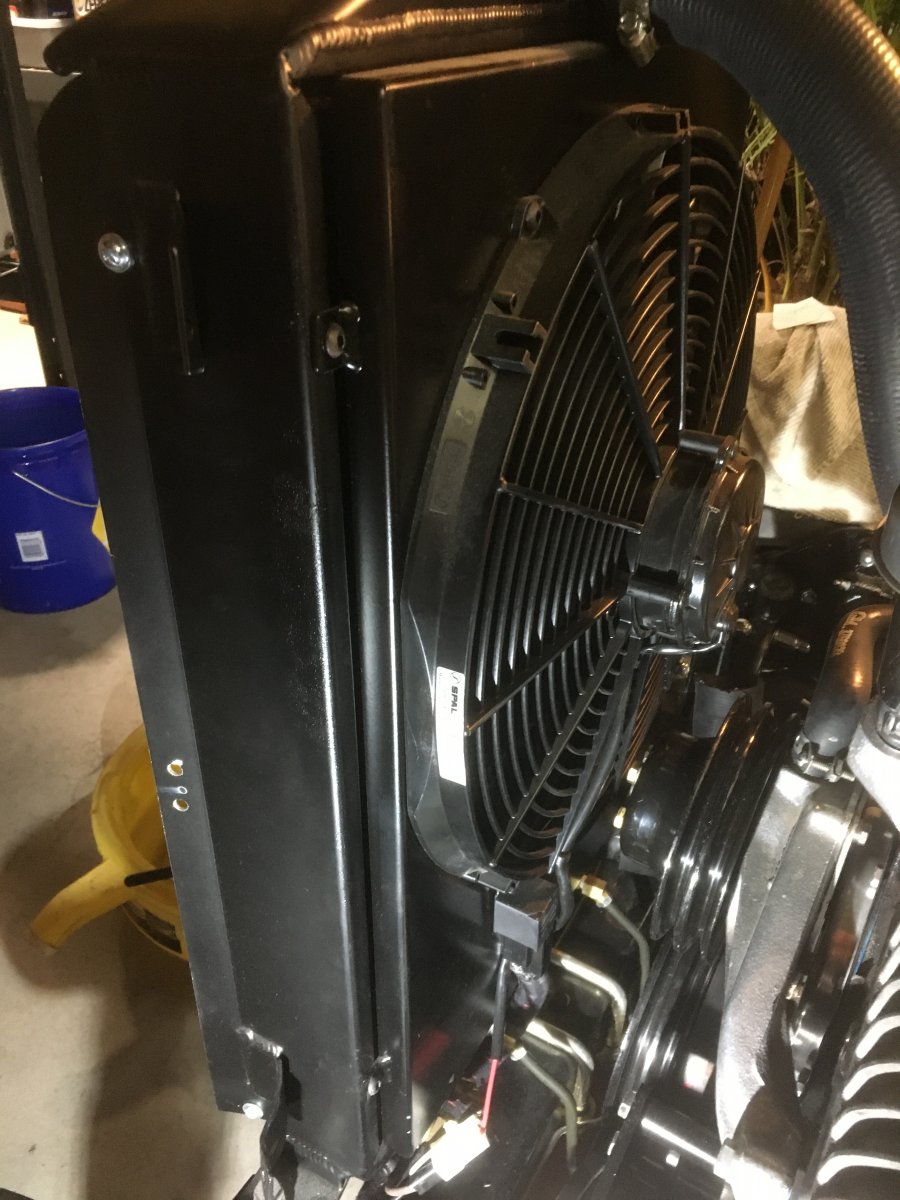

    Hello all, I am looking for advice on solving an overheating problem on my 354 blown hemi. I have a Chinese aluminum radiator in my 32 Ford grill shell, with a derale puller fan 2400 cfm. I am running ac on it also , all that being said it warms up like a typical hemi slowly but seems to build heat the longer I drive . But at 55 or so it will stay around 180 to 190 . On longer highway runs it will creep up to 200. It was worse so I removed the thermostat and it seemed to help but if I get into traffic or idling it gets hot quick. Now I’m flustered and don’t want to just throw money at it but am trying to work through it mythologically thanks in advance for all your help.

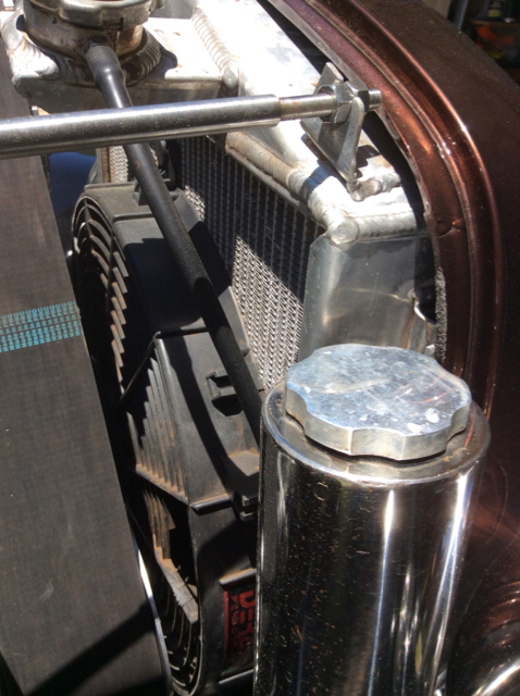

  5. Add a oil cooler. It took 30 degrees off my water temps. Let's see some pics.

    Thanks , not sure what else I can do on the fan it is all too close for a real fan.

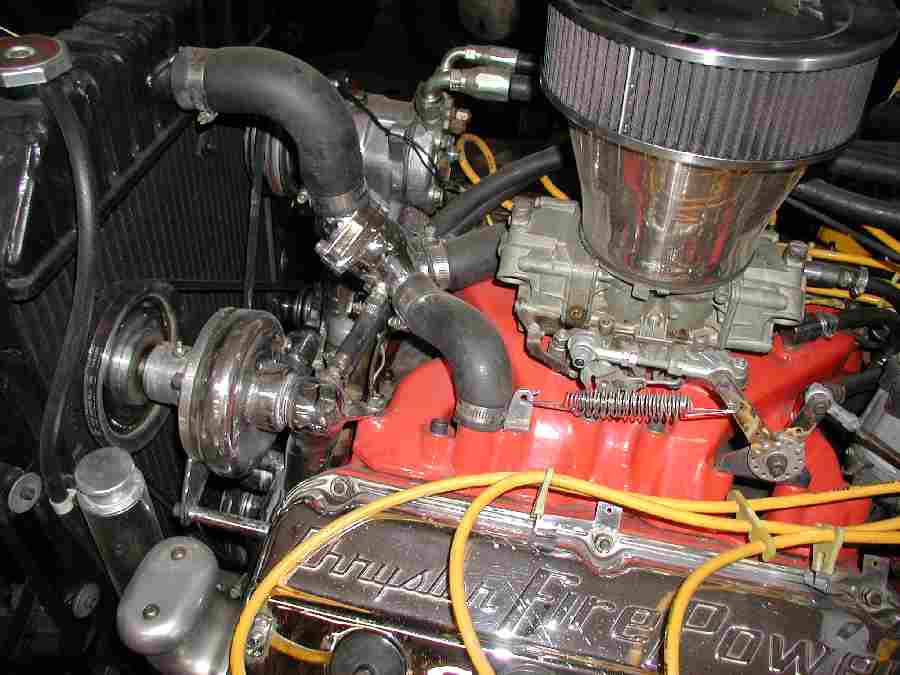

    392 Hemi 1.jpg I had the same issue with the hemi in my 34 Ford...Had a US radiator triple flow radiator and it wouldn't cool the motor...Chrysler hemi motors have a coolant capacity from the factory of 24 to 26 quarts and I had a company called TCPP in Rexburg Idaho build me a radiator that has two rows of inch and a half tubes...Cured the heating issues....Will get to 205 on an extremely hot day here in Vegas...I run a Flowcooler big block Chevy water pump,,Cooling components fan and a 160 degree Tstat...You need enough water in the system to absorb the heat and move it to the radiator...Blowers develop heat on their own two because when you compress air heat is generated...Hope this helps some...

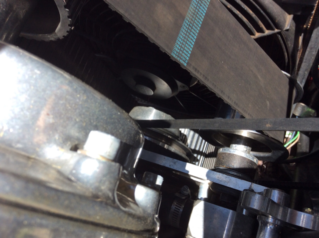

    Thanks I am questioning the pulley size. The bottom pulley is smaller than the pump. If it were swapped it would overdrive the pump correct?

    Bottom pulley needs to be bigger then water pump pulley to overdrive the pump.

  19. Do you have a shroud with that puller fan? If not the only air flow from thre fan will be directly in front of the fan. Idealy a shroud covering the whole core, with the fan not dirrectly mounted to the radiator core would alow air to be pulled through the entire radiator. I agree with the adding an oil cooler and adjusting the timimg as others have siad as well.
    moparjimd60 and Nitroholic like this.

    Tubes in the radiator look really small...the fan is only covering about 60% of the radiator area...also what type of impeller is in that water pump...cast...stamped> also is the blower over or under driven?

    Careful over driving the water pump as you could end up with water cavitation at higher revs.

    Hi it is a stamped impeller, the blower is 10 under I am not sure I have room for a shroud .

    Not sure how much room you have (obviously not much), but some fan shrouds are pretty thin. Mine is about 1/2 inch thick. It covers the entire radiator and mounts a 16 inch Spal puller (the biggest and best fan I could fit).
    Also, out of the 16 or so replies thus far there are 3 suggesting an oil cooler, 3 bigger radiator, 2 timing, 2 thermostat, 2 shroud, and the rest had one reply each. Sorry, couldn’t help it.

    Water flow at the back of the head is a bit 'sluggish' unless you are also pulling water from the rear of the intake rail. Note that HemiHotrod66 has a temp gauge mounted at the pump inlet which will give an accurate reading for the coolant going into the engine...you do have at least a 50-50 mix, right? but an additional gauge before the t-stat would be good to have in order to see the temp change. This could help define where the problem lies.
    The oem Hemi pulleys are about 5" bottom and 7" top, what are the gm numbers? Do not over speed the pump, as mentioned you will get cavitation and destroy the pump.

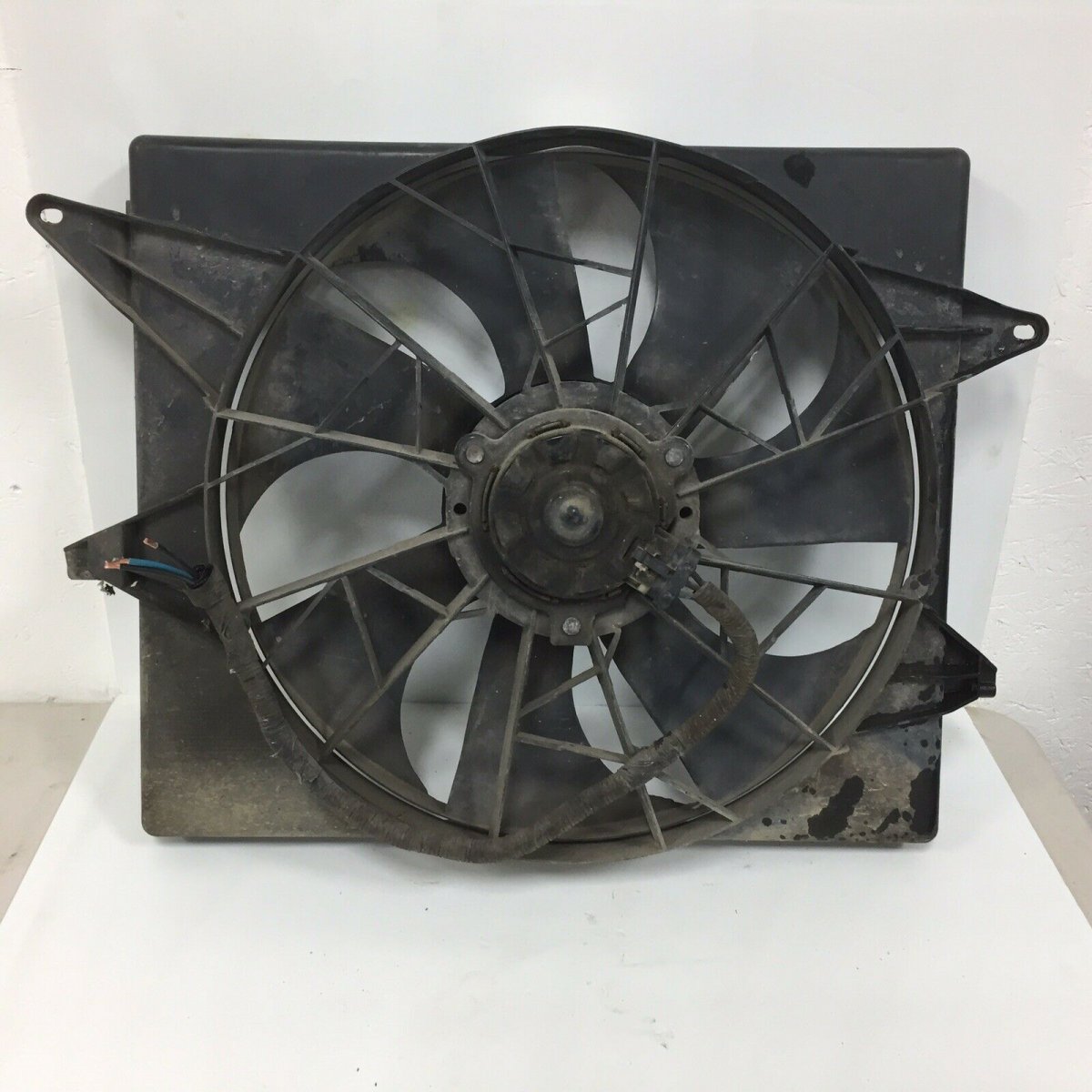

  27. Going with the poor air flow theory, as stated above most aftermarket Chinese plastic electric fans are woefully inadequate. Here is a great hot rodding option that Detroit designed and still looks reasonably hot rod. Just comparing these blades to the typical 16" thin fan you can see it moves seriously more air. Lincoln Mark VIII/Thunderbird fan is a robust 18" (air flow goes up with the square of the fan diameter so this fan nominally moves 25% more air than the usual 16" fan). 22" wide x 19" hi built in shroud. 6" deep. Also can be run as 2-speed fan with a controller. I put one on my '59 El Camino with a 305 SBC, fit like it was made for it. Always on ebaY for about $100.
