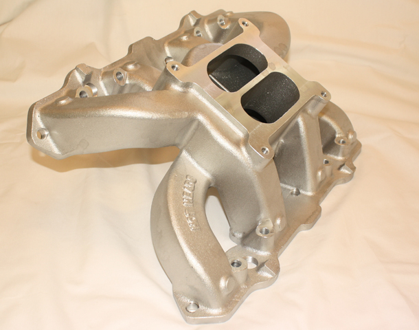

    Hello!! I am thinking of getting a Hemi Intake #1637625-2. The problem is I have a Holley 650 duel feed carburetor. Not sure if it would fit. Anyone know anything about it or if it will fit on it.
    I am in Canada piece is in the States and will cost me almost $520 want to make sure before purchase.

    The carbs bore spacing (as well as the bolt pattern) is significantly different that the oem Hemi and you will be using a 'funnel' or, by some accounts, a 'choke plate' if you do nothing more than sandwich in an 'adapter'.
    I too am a fan of the Holley carbs and I bore out the intake to match the Holley base pattern. The manifold throttle bore centers get relocated so this is not just a 'bore-job'. You will need a bolt pattern spacer to not only change bolt positions but also to raise the cab above the manifold so linkage clears.

    Where it's a truck hemi it would have a wet 2 bl intake (thermostat in the intake). You'd need the '54 331 car intake to get a 4 bl. with thermostat, or change to front opening heads.

    The truck head does have an odd shaped boss on the head and TR Waters has made some pieces to hook up water.
    In addition, recall that the truck head has water under the carb, not exhaust, and the cross-over port requires some filler so that a pass-car gasket will seal it.
    As to the 54-331 heads, every 54-331 had them so not sure why they are 'rare'... how many do you want?
    Since the 354 is a truck engine will most likely have the 51-54 front cover design so using a intake manifold w/o a t-stat will require a remote unit. Not everyone's cup-o-tea.
    There are some early aluminum intakes floating around, either 2x2 (51-53) or 2x4 (54), and although never cheap, they will have a t-stat. I have one of each in the discount bin...

  22. Heads aren't rare but 4bbl manifolds w/ thermostat housing surely are.
