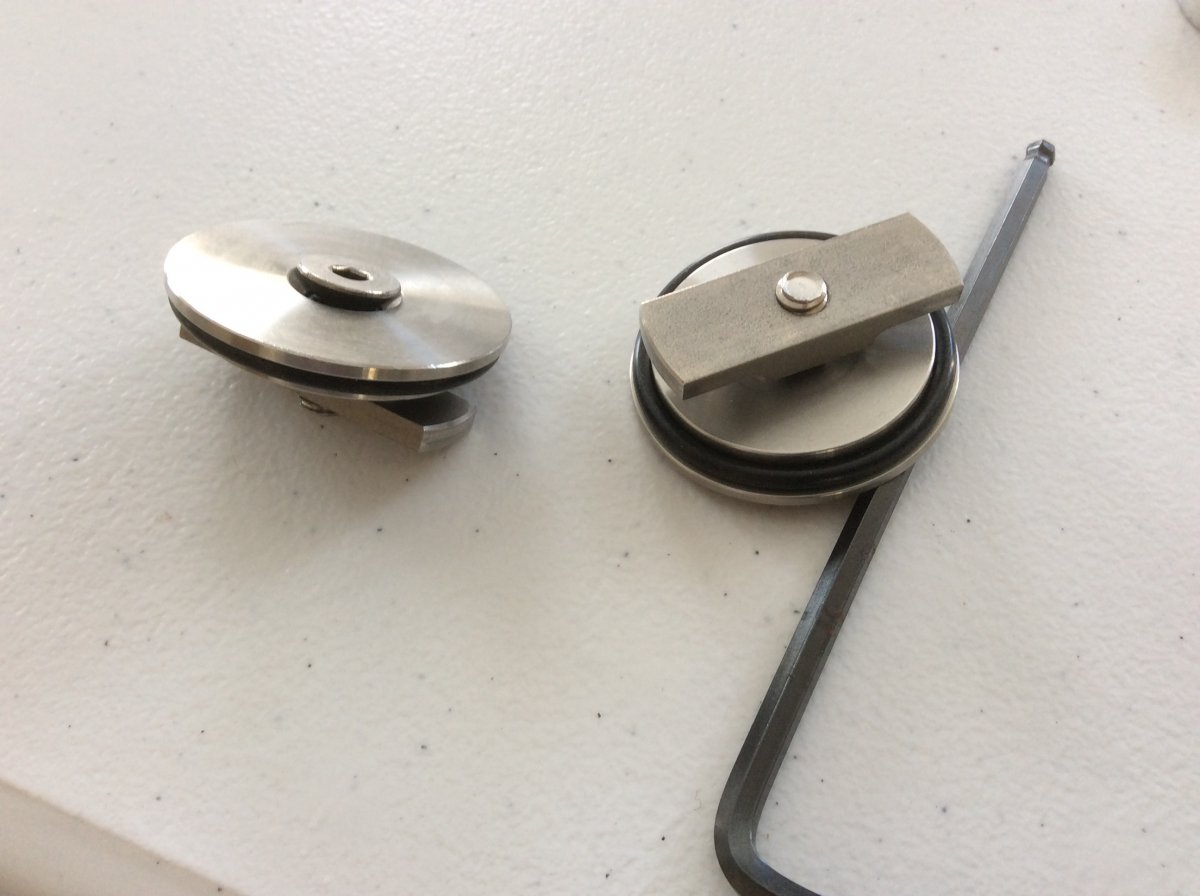

    A93437A7-127C-4118-9172-251C718E63EC.jpeg If anyone has used these before, how does one keep the inside “T” bracket from turning inside the water jacket?
    I can obviously get them snug, but not tight - just spins inside block...

    Take a punch and put a few teeth on the surface of the bar that meet the block.

    ^ This. Would also be a good idea to put some anti seize on the screw threads and a smear of your favorite sealant around the underside of the screw head before cinching it up.

    Thanks, I’ll give that a try, the inside of my block was coated with glyptol so things are ever more slippery. I was wondering if I have to weld a longer piece on one end to prevent from spinning...

    Yes, thanks.. they are O ringed on the inner Allen head seat as well, nice touch

    Thank you for the response, yes they were from Hot Heads, I am using them in the center of the three holes in the side of the block due to previous plug leaking. With these I can get them very snug, but that’s it - then the whole thing wiggles/spins. I am getting no “traction” it seems on the inside of the block. It appears if one end was about 3/8” longer on one end it would bottom out inside block by oil pan. I’ll see if I can get a friend to weld an extension on it the prevent turning inside.
    I tried making a few hash marks on the ends to help them bite, but nothing. I used a grinder to make the inside piece sharp like a lawnmower blade thinking this would sink inside block wall, but still spins near the finishing line.

    I had to go to these when I couldn't get the OEM plugs to seal. They worked great. I think the problem is that the original plugs don't work right if the block is not absolutely pristine.
    These solve that problem.

    Willys36 just said he tried expanding his. That's what I was thinking as I have had plugs that were a little loose and have laid them face down and used a ballpeen hammer to expand them. The holes in the casting must be pretty bad if you can't make them fit by expanding them. Lippy

    Back to the point of this thread, could you bend one of the edges of the cross bar a little to make a point that would bite in and not turn? And, are you sure you didn't bottom out due to a thinner wall of the block? Maybe bend the cross bar into a " U " shape and try it again.
