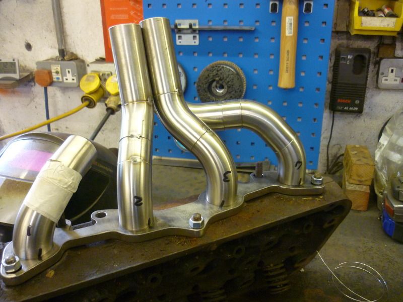

    And started on the headers.

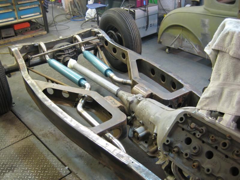

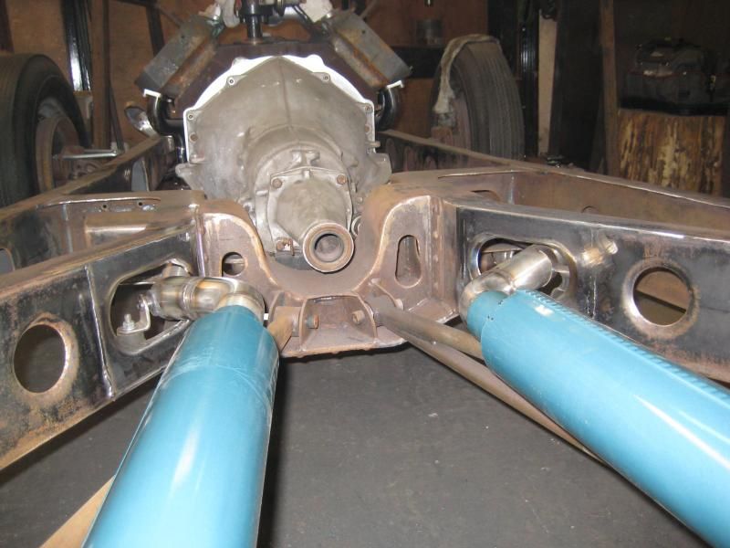

  28. Exhaust system now finished. made with 2" stainless tube and Smithys Mufflers.
    When I built the chassis I was going to just run open headers and not a full exhaust system, but after running the sedan like this I'm getting too old for loud exhausts.
    The chassis had to be modified to run the pipes. I wanted everthing to be up in the chassis and not hanging below, for when we go off roading ;D
    Made a new piece with a slotted hole
