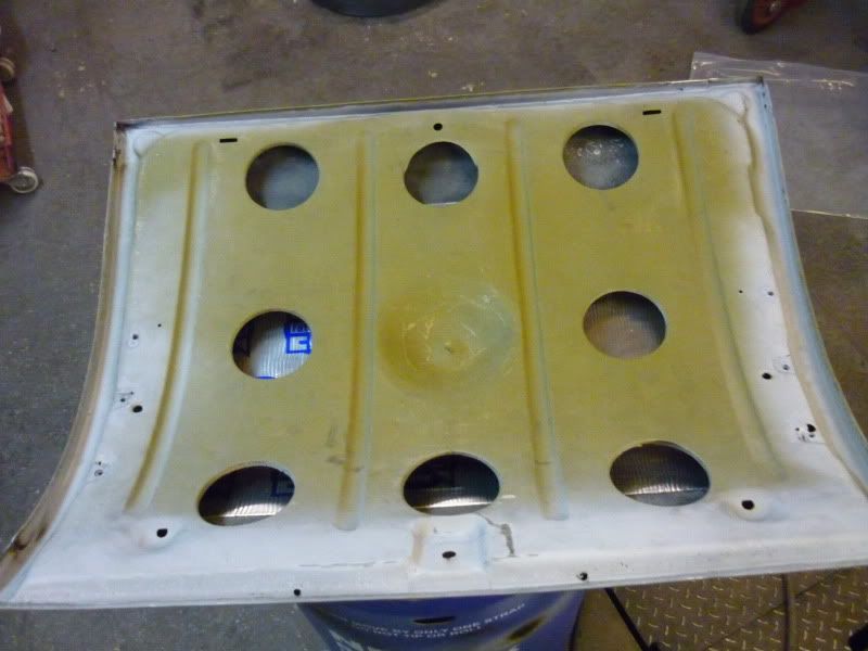

  7. Got the trunk back from the blaster needs a bit of work to the bottom and top lip
    New metal put in
    Got the trunk lid finished up now, had to replace the bottem 3" and a small section at the top.
    Coated the inner skin with some waxoil before putting it back together.

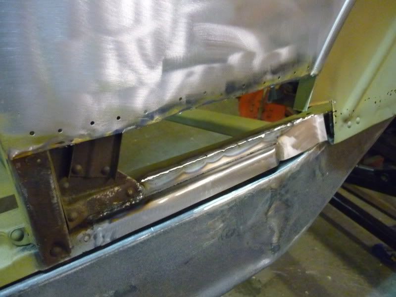

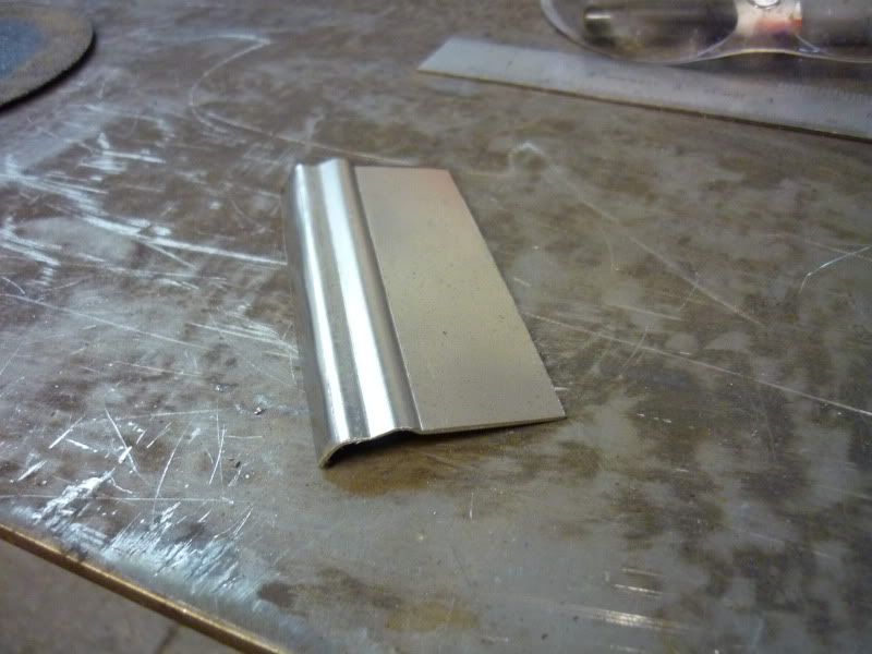

  19. Been doing lots of sheet metal work the last few weeks to try and sort out all the crap repair work.
    Cut out all the bad stuff , repaired the inner structure and fitted new patch panels
    Had to make this piece
    To go in here
    Made up a hammer form to make the beads in the rear fender well
    Fire wall next ;D
