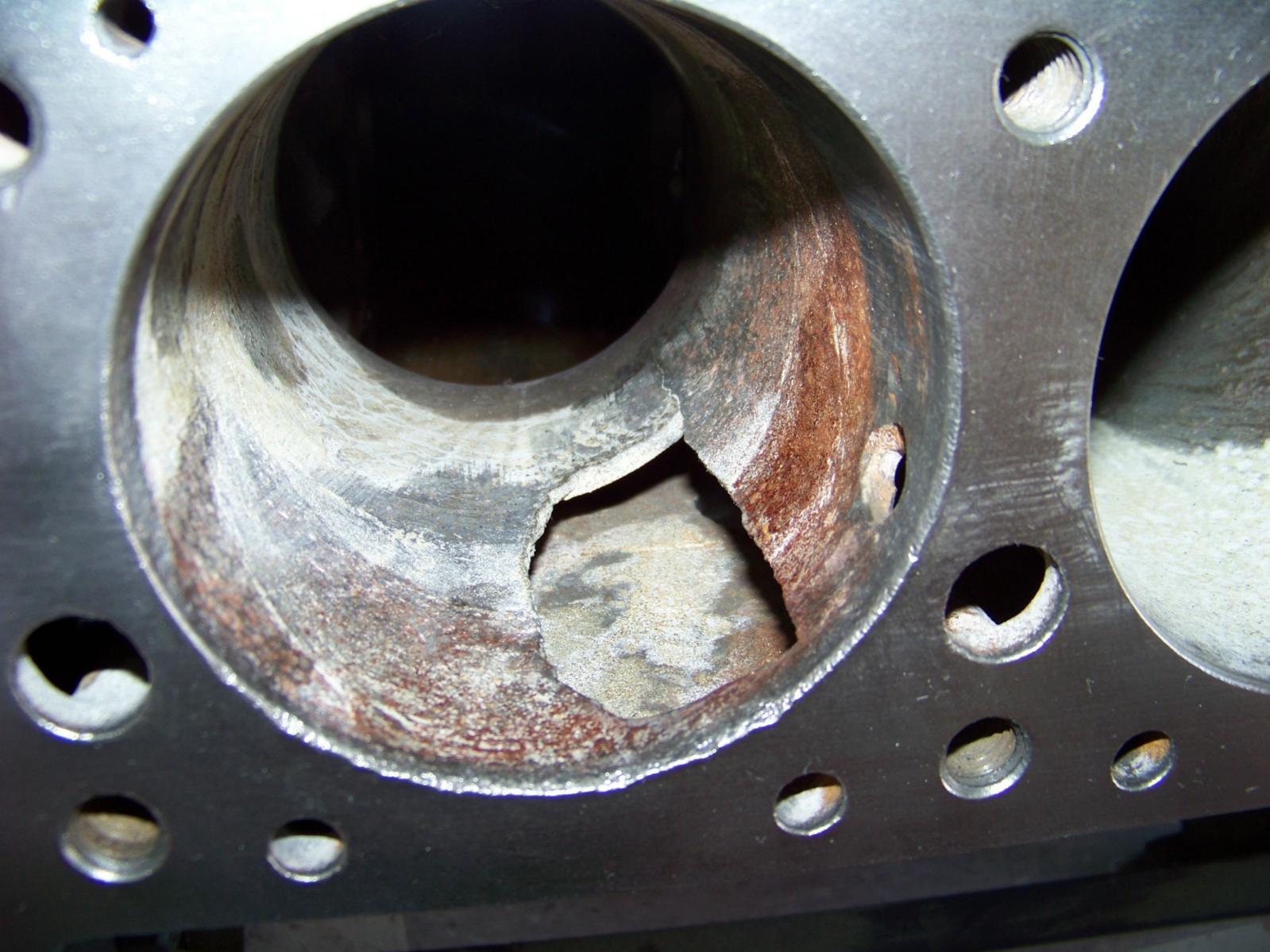

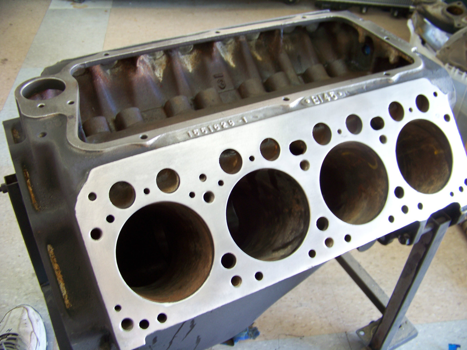

    Anyone ever sleeve a cylinder this bad? The rest are ok.

    i would sleeve it.

    I've had worse than that sleeved. No issues. If the rest of that 331 is good, Save it!

    That can be fixed, I had 3 holes in one and it's still running!

    I have seen way worse on a salt water marine block. The owner had all 8 holes sleeved. $100.00 per hole. Your block appears as though it could easily be saved with a sleeve.

    Sleeve it should be fine. Coat the sleeve and bore with KD block sealer and drive it home.

    Should be fine with a sleeve.

    Thats what they make them for...

    Good machine shop & you will be good to go,it is W/O a doubt worth saving !!

    Common with them should be a EZ fix

    Do they use a sealer to keep the water from getting between the sleeve & cyl wall?
    Also, there is a crack that goes down the cylinder. Do they address that before the sleeve goes in (like stop-drill it or something)?

  17. They will no doubt cut the old cylinder wall completely out. Should have a step cut up near the top of the cylinder and the sleve should have a souolder on it to keep it from settling and yes some sealer of some sort will probably be used to keep the water out of the crank case.

    If they take the wall out, what holds the sleeve in place?

    It will register in the step cut on the top, and the press fit will come from the lower block area underneath the water jacket. After its pressed in, the block will be decked.

    OK, got it. So the deck area & lower cyl holds it. I was thinking I might need to put some block fill in it (like 1/2 street fill)

    Stop drilling the crack is recomened. As to cutting out the old cylinder wall I like to leave as much as possible. It helps to keep the deck ridged. Most repair sleeves aren't so thick that you will remove all the old wall. When you bore for a sleeve you do not go all the way out the bottom you leave a lip at the bottom and the sleeve is driven to the lip. Then the excess sticking out the top is trimmed flush with the deck.

    Good stuff. I'm going to take the block to L.A. Sleeve & get it done.

    I sleeved a 261 Chevy block that was that bad, and it held up fine.
