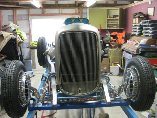

    Well despite the heat and overload of my day job I managed to get the front end sitting in place. I have yet to fabricate the hair pin mounts and I also need to fit the front shock mounts.

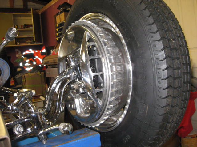

    I wanted to use a front brake kit made by a New Zealand manufacturer so I went with the unit made by Ace Patterns.
    Jimmy makes a really nice job of them. Yes they are disc's by that's my choice due to NZ roads and more importantly my lead foot. I'm pretty happy with the front end so far. I've got to say the chrome work on the Socal axle and components is nothing short of excellent.

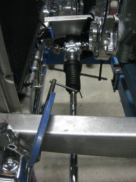

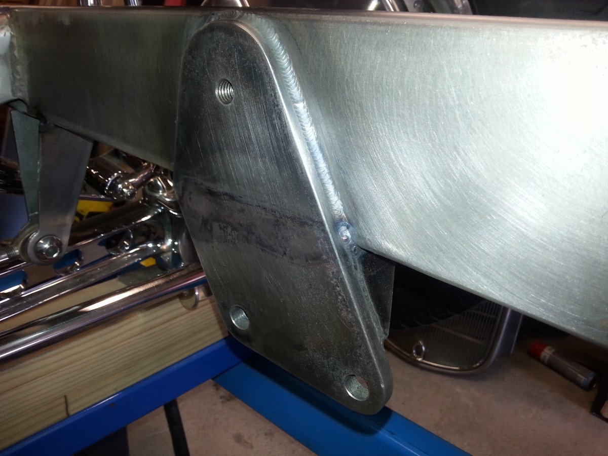

    View attachment 2819427 The front steering has been a pain in the arse, My first choice was the NZ Kiwi standard HQ Holden steering box but I just didn't like the way it looked and it was also going to stop me from doing what I want to do with the engine mounts.
    I looked at the new R/H drive Vega boxes but the country of origin turned me off (China).
    I ended up going with Unisteer, I did a lot of research and found plenty of good feedback on there performance.
    I will fabricate my own mounts but have mocked it up just to get a feel for how it will fit and look.

    Like the look of the uni steer . I presume you need a sliding joint in the column?
  20. I think the Unisteer rakes are solid mounted to the frame so a slip or sliding joint is not required. Please correct me if I'm wrong here. My T had a R&P bolted direct to the back of the I beam axle with a sliding part from a HQ Holden incorporated in the steering shafts from the R&P up to the firewall then onto the steering column. Now this had passed WOF's since 1985 when build new but by time I purchased the car, it wasn't a very safe set up at all so Terry Bowden replaced the whole set up using a Suzuki steering box. Sorry if I have high jacked your thread Peter.
    LIFESTYLZ and ratman like this.

    No you haven't hijacked my thread mate that's all good information and you are correct because the Unisteer is solid mounted to the frame is does not need a slip joint.

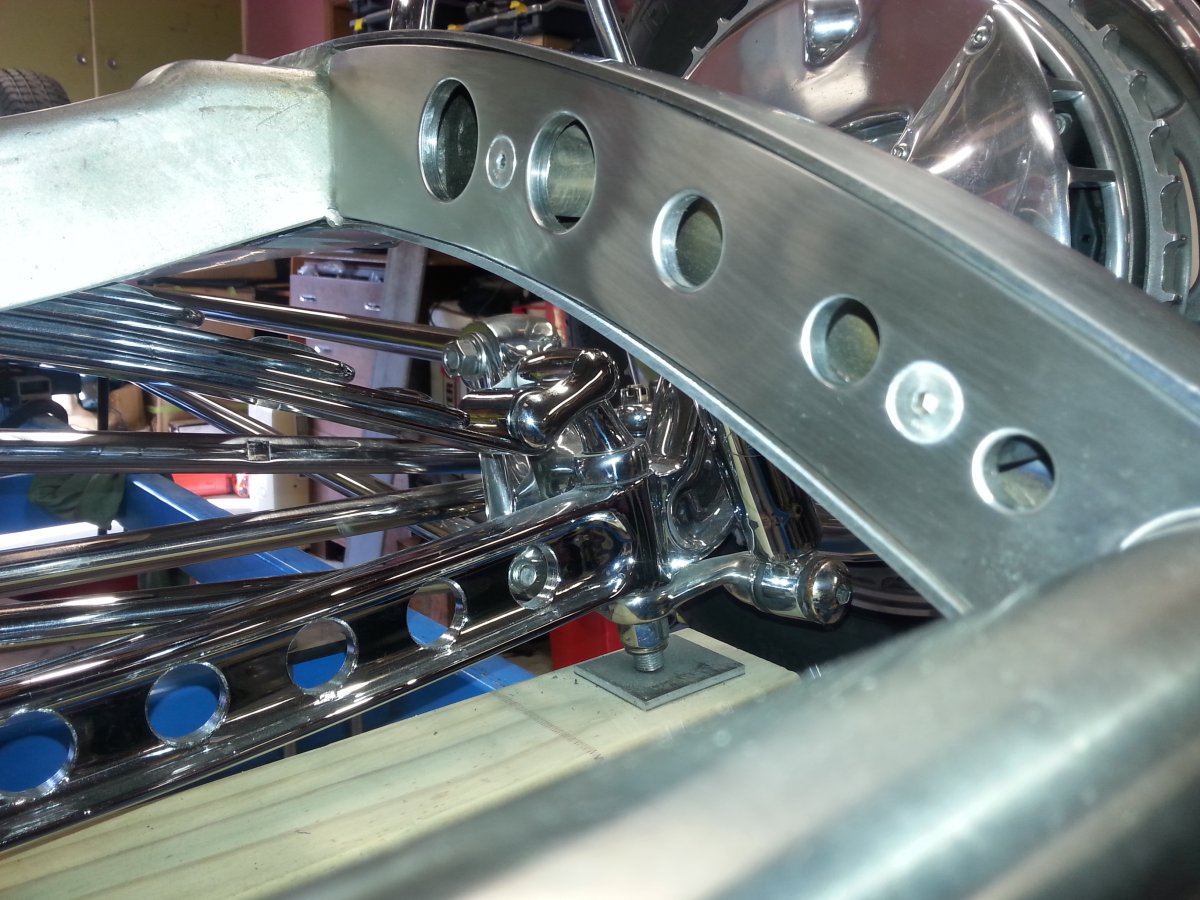

    Peter, Think about C ing the rear kick up on the frame. Otherwise your rear might be too high to give enough suspension travel. Run your suspension thru its total travel without springs to make sure your shocks don't bottom out first. My 32 Ford, 354 Chrysler Hemi. 6-71 blower, has two 4 bbls. Fits under the stock hood. Low air cleaner element off (1965 427 FE Ford with two 4bbls). If that air cleaner element worked on Ford 427, it should work for me.

    Hi ago, yep I'm going to notch the rear of the chassis I was intending to do it when I pull the rolling chassis down to remove it from the build table. Your 32 is very nice I like the way everthing fits under the hood.

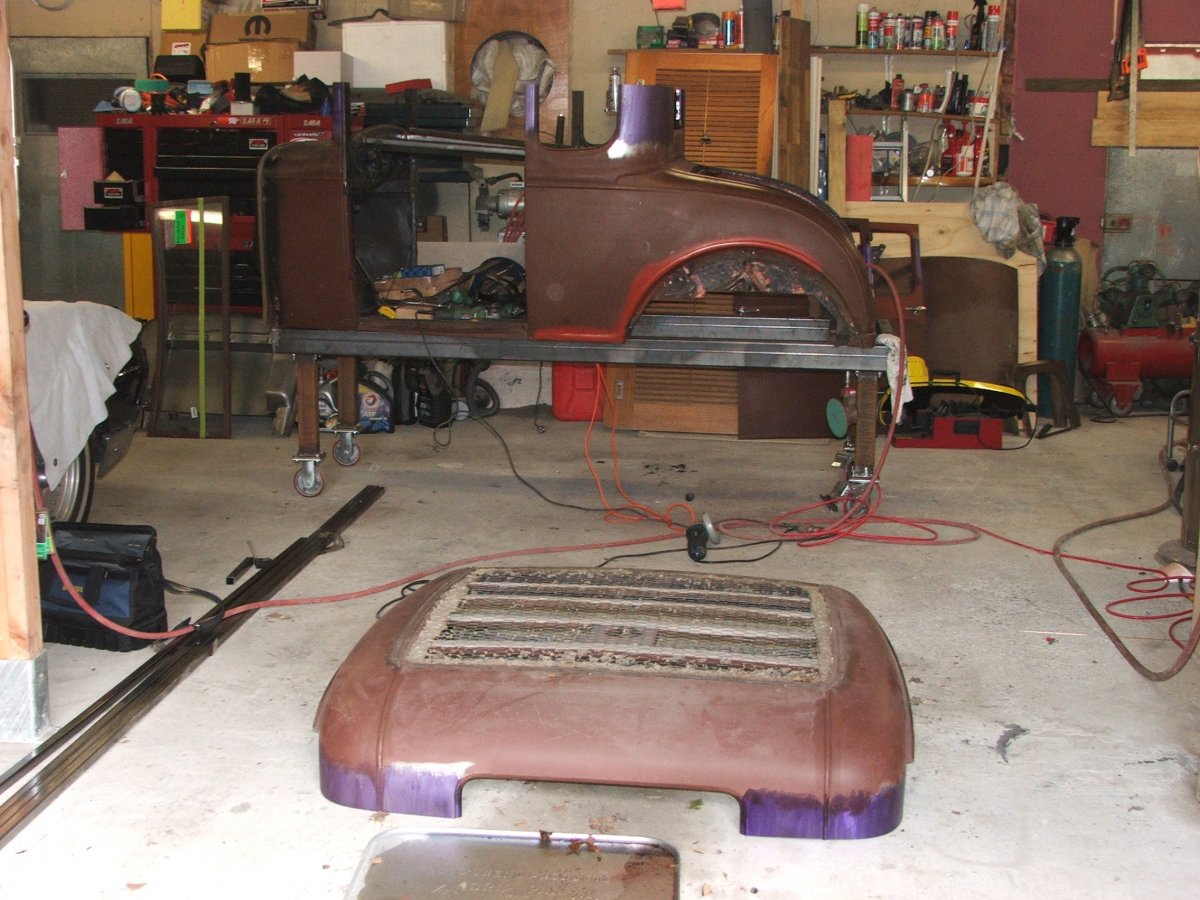

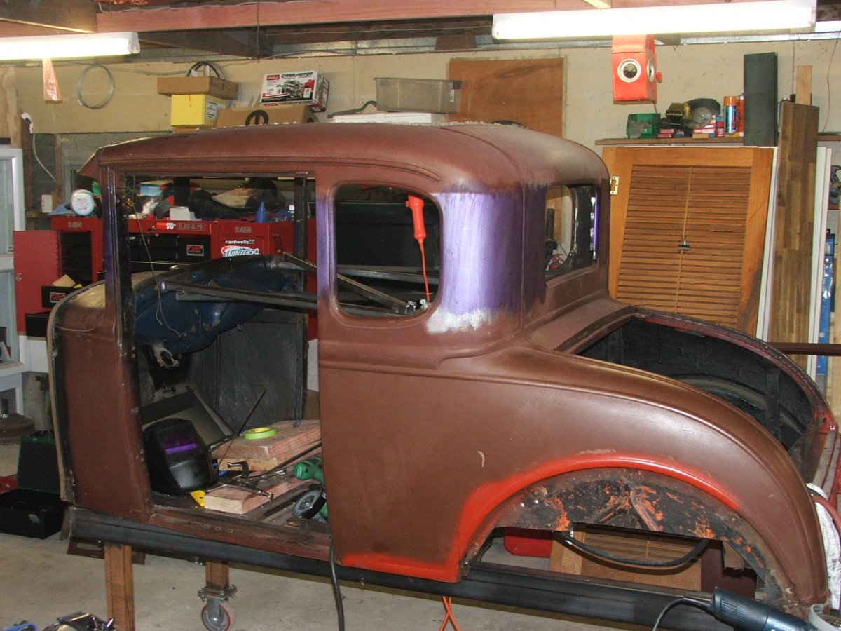

    4 5/8" chop, That makes me 1/8" above minimum legal screen DSCF1123.JPG DSCF1138.JPG DSCF1139.JPG DSCF1147.JPG 503.jpg 064.JPG 547.jpg height. Its my first chop in 10 years but I'm pleased with the results.

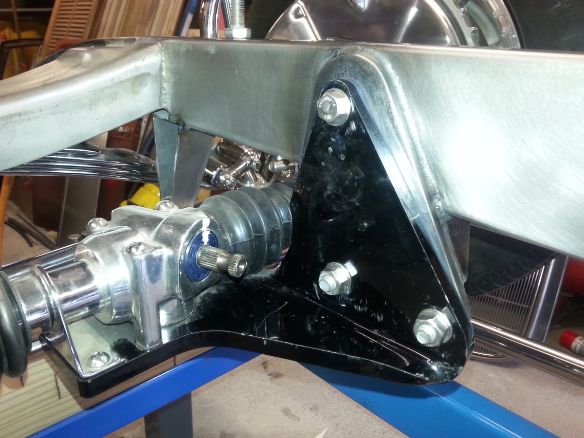

    Install of the Unisteer. I stuck with the factory angle bracket and made up my own chassis mounting. I did this to eliminate any issues with compliance. 532.jpg 533.jpg 534.jpg 535.jpg

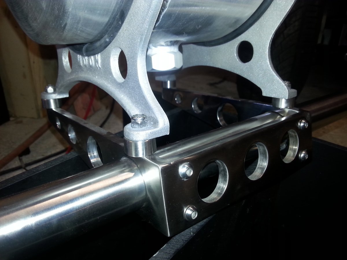

    Moon tank mounts all 316 stainless steel. Not finished yet but close. 536.jpg 537.jpg 541.jpg 542.jpg 543.jpg 545.jpg 546.jpg
