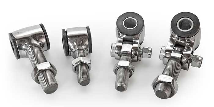

    Has anybody used a multi angle adjuster as shown in the picture. I am planning on using two of them on my rear panhard rod.
    Just trying to get feedback on there performance, Kugel Komponents sell them and they are US made so all should be good.

    Subscribed. Insofar as those adjustors are concerned, Scott's hot rods has been similar in their IFS suspensions for some time now. The stress load IMHO is not on the 5/8" UNF thread or bushing end but on the 1/4" UNC bolt holding them together and the weak link? I would prefer a conventional single solid adjustor correctly set up, the panhard rod essentially goes up and down during suspension movement and also deals with side loading forces (X&Y axis). It doesn't move backwards and forwards (X,Y & Z axis). Are those adjustors designed to be in a static setup or designed to be constantly moving. More of a static vibration mounting IMHO. If constantly moving I can see them wearing where they articulate and eventually failing.

    I want/need to mount the panhard rod on an angle that is more than the 11 degree ends available. One end will be mounted to the top of the right side on the diff and the other on left hand chassis rail.
    Its the 1/4" UNC bolt part that I am worried about. That part will remain static though IMG_2163.JPG
    This pic shows what I am meaning. Its about 21 degrees.

  17. I doubt that there is a 1/4 UNC bolt strong enough for that force and with it at an angle that will increase the load even more. JW

    Machine a piece of Solid Bar with two smaller diameter ends. Bend the solid bar, then plug weld two pieces of tubing (and butt weld) then thread both ends with conventional adjusters, and make your brackets accordingly. Don`t forget, you can angle the bracket on the diff forward to run the panhard across the front of the centre section, then make your frame bracket to suit. I`ve done them that way, even used thick wall (1/4) and bent and machined/threaded that. What does your friendly local cert. guy say?

    Thanks Kiwi Tinbender I hadn't thought of doing it that way, The piece pipe in the picture is schedule 180 seamless 316 so its plenty heavy enough in the wall

    That's what I was concerned about. Thanks for your input

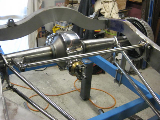

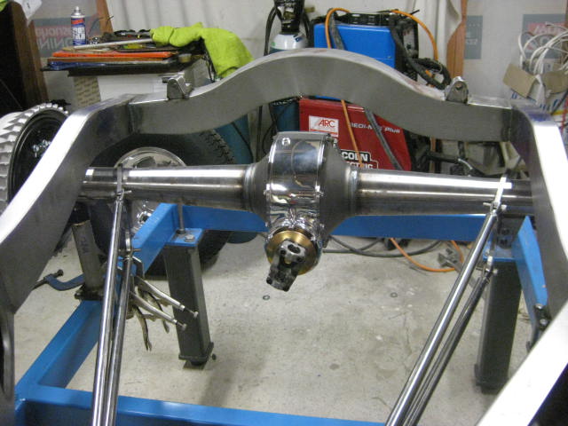

    Kiwi Tinbender gave me this idea so I went with it thanks for the input, ended up making one of the ends from the same bushes I have on the ladder bars and the other is a stock standard Socal speed shop 11 degree rod end.
    The panhard rod itself is made from solid 316 stainless.
    I have tried it at all maximum suspension travel aspects and everything clears nicely.
