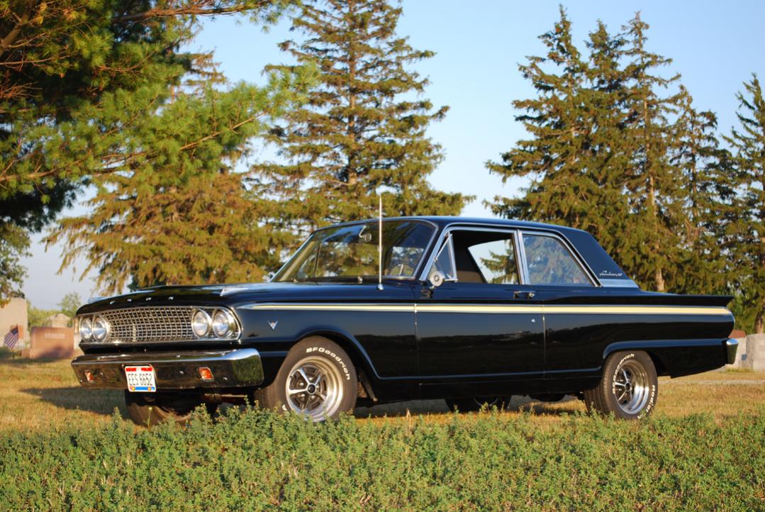

  29. I guess you have a point there haha
  30. I had Brandon take some daylight pics for me.
