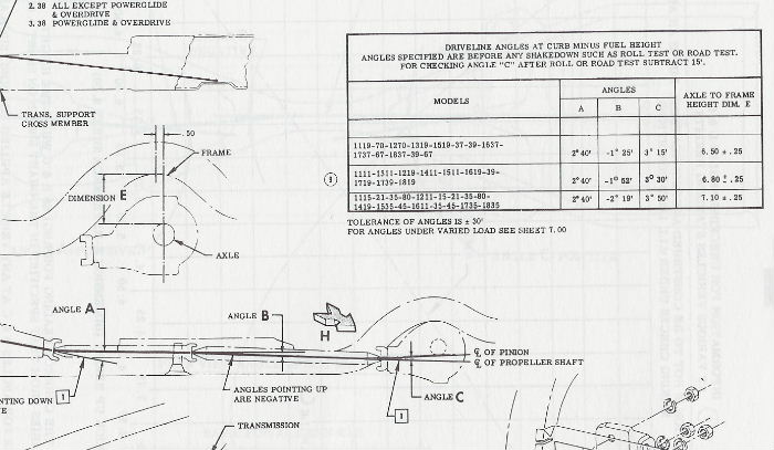

    I think this is interesting. 60 Chevy factory manual. Notice pinion down.
    Notice how having the front shaft with the yokes at 90 degrees ,the angles are additive.
