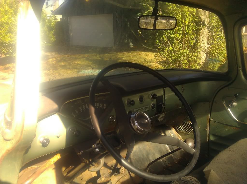

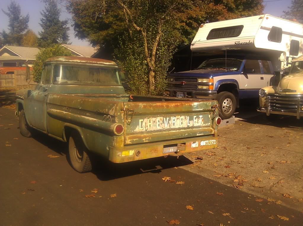

    Hi guys and gals,
    ...If you currently had a classic rig, drove the snot out of it and didn't want to tear it down now to lower it, swap engine/trans and rear axle until the heavy rains and darkness are upon you, but wanted to get the " I think I need a classic truck project" out of your system and stumbled upon a 59 Apache that needed saved, what would you do to it?
    The truck: 1959 2 owner Apache long wide, stick on the floor, 235 that purrrs like a kitten and drives straight down the road, all the lights/ turn/ brakes etc work. Wipers, heater etc all work. Needs fluids changed, tune items , mabey hoses ( they look good, but how old are they really) a seat re-uphoulstery job and then what?
    Would you:
    1) Clean it, kill some rust, change the fluds and sell it realizing that the 50 burb needs more love and would look waaay better dropped and the dual carb motor/700r4 rear end and sids axle that you have in the garage are waiting for some attention.
    2) Clean it, fix some rust, respray the grille/headdlight bezels, front and rear bumpers etc white and leave the (shhhhh.) PATINA. Roll it on the stock steelies painted gloss black or creme with the wide whites you have sitting around. Drop the front a few inches and rake it. Fix the bed wood, new seat, drive it until you want to refocus on the burb and trade it off or sell it ( would make the wife happy ).
    3) Above including a few small body work issues, mask it and respray it flat Hot Rod Flatz tan, gloss creme or black steelies with wide whites and chrome lugs ( mabey stock poverty caps) or Hod Rod Flatz flat medium blue metalic and said wheel options or gloss rustolium job( pick a color). I have the Hot Rod Flatz colors already-both are flat, gloss would be a cheapo Rustolium job and yes, I have read the thread and are prepared for the haters. Rember, any kid in the 50's-60's would have asked and done the same things on a BUDGET. I agree with the down sides of the above mentioned paints, but Chip isn't comming anytime soon to Overhaul me.
    It didn't run when I found it, owner said " it ran when parked" but didn't take much other than a battery, carb / fuel system cleaning and scraping some corrosion from the cap. The truck runs and drives great, it was just neglected under a tree most of its life. The upper w/shield brow is clean and rust free, small amount of cancer in the cab corners , a spot on the rocker and the tail gate has some swiss but nothing a weekend wouldnt cure. Those repairs would force the need to be painted instead of leaving the (shhh) PATINA look and although I like the flat color look with gloss bits, the color and aged condition of the truck overall, I could see with some glossy white refreshed pieces on wide whites and dropped a little.
    Either way I am torn with what to do, which way to go. After reading and enjoying hundreds of threads here, I thought I would call upon all of those who, like me, have too many projects already. What would you do with it?

    Neat truck. First off, I'd pressure wash it to see what I'm working with.

    Yeah, definitely pressure wash it and even use some CLR with a scotch brite pad and remove the rust. Give it a good once over and fix whatever needs to be fixed, paint the wheels, slap some wide whites on it and enjoy the truck. Once it's all cleaned up and running around town, you'll have guys chasing you to buy it. You can decide what to do with it then
    It looks pretty damn solid

    Lose the camper mirrors and give it a bath!
    #3- is my vote!

  9. I would just clean it up and run it. Love those granny-gear 4-speeds too. Fix up the interior, maybe splurge on getting the seat done over by a pro, paint up the dash & door panels too. Work on the mechanicals and have fun with it.

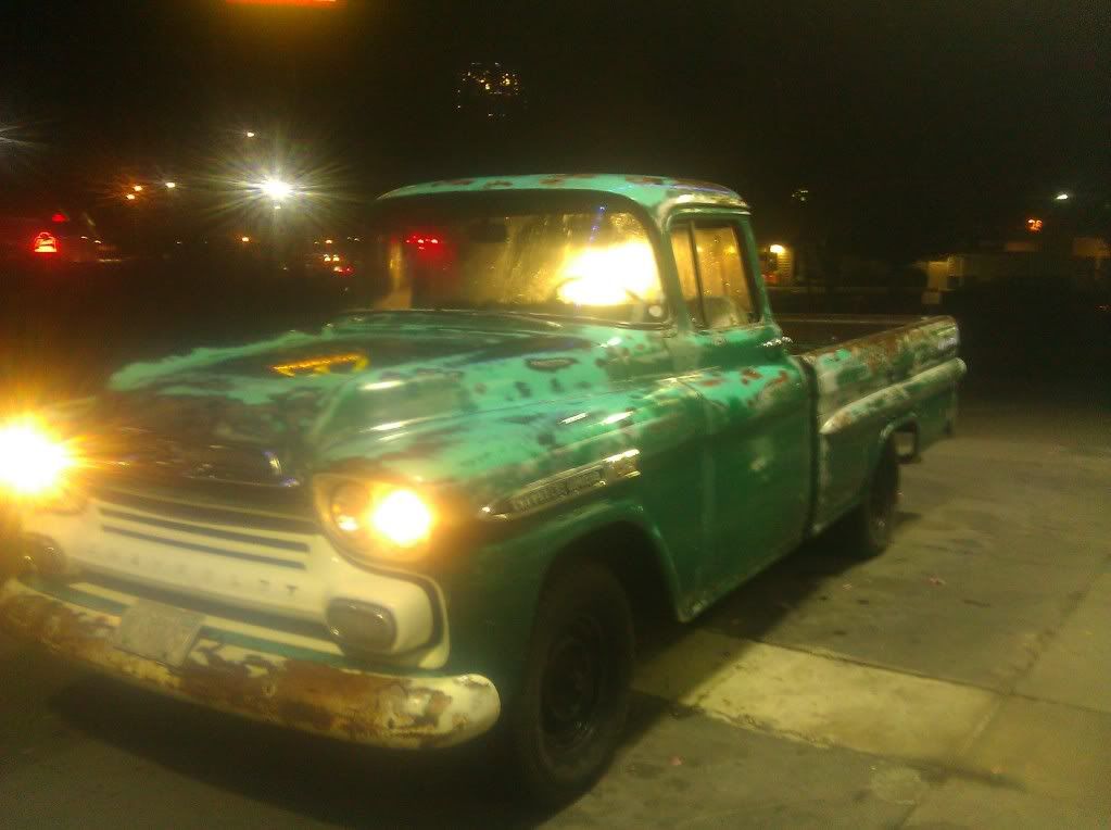

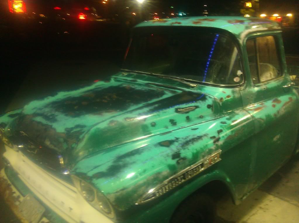

    Here's after the first CLR treatment with a little Ospho top coat. I have read where some people don't have good results with CLR. I could see why if you followed the directions. I pressure washed and then dried the truck. Using a red scotchbrite pad (several used for the whole truck) I liberally washed the truck with straight CLR and rubbed, rubbed and then rubbed some more. The heavy oxidized spots took the life out of the pad and had to grab new ones for each panel. I think ospho straight and not dilluted works best on the heavy surface rust areas, but don't get it on glass as it will white out the spot. I learned that by mistake a long time ago.
    Gonna pick up a mexi blanket to zip tie to the seat cushions tomorrow ( nice seat and headliner to come next month) and then start prepping the bumpers, grille and headlamp surrounds for white paint after work. Wheels and white walls on Saturday with a nose dive and some blocks next week.
    I drove around tonight checking out the little things and so far no blower fan or heat control, but the dome and glove box lights work! All other lights, flashers, turn etc work great along with speedo and all gauges! Holy cats, its like a new truck.....only cooler ;)

    Looks cool!!! A new set of tires and some cool hubcaps would go a long way on it!!

    looks like a solid parts hauler. i'd just do maintenance to make it reliable and leave it the way it is

    Looks good just as it is. Radio delete is a hard to find item - do not bin it !

  17. Now that you've got the surfact almost prepped, I'd have to go with a brush paint job to make it presentable. Sand the existing surface with a little 400 and pick out a gallon of the finest Rustoleum enamel of your favorite color and buy a "Purdy" soft brush...ad a little hardener [or not, I didn't] and pick out a spot with no trees overhead and a day with no rain in the forcast. Paint the truck from top to bottom and include the wheels.
    Find a decent set of stock center caps and pop 'em on.
    I know this approach works in southeast Portland because I've used it on a scabby red 62 ford shortbox. Kept the truck for 3 years afterward and occasionally did a little touch-up with a brush..sold it for twice what I paid for it.
    Your results may vary.

  19. There was a truck under all that shit! Looks awesome. I'm with the el-cheapo Rustoleum paint job, in as close as possible to the Chevy dark green. I've done old trucks before with 3" disposable rollers. You can thin the paint a little with some lacquer thinner (just a splash in a quart can) if you want it to flow better.

    Looks better already!
    I'm with Rocky, on this. That mint green would be a neat color, too.
