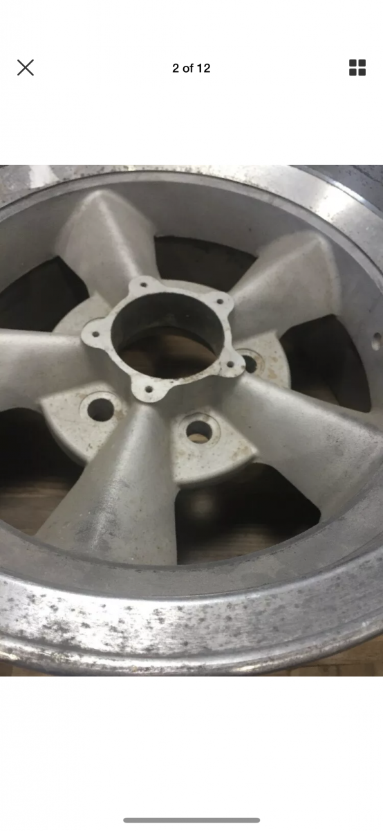

    E5FB8FE6-F5D8-42A3-AEAD-CB56CDB6E37C.png I just picked up a set of original American Racing torq thrust wheels front 14x6 and back 14x7
    They seem to have a recessed spot where a washer fits .
    They didn’t come with lug nuts . So what I need to know is what specific size/length/style lug nut I need?? It looks like it is the shank variety not the acorn style like for Chevy steel wheels
    The car they are going on is a stock
    1955 Chevy 150 sedan
    Thanks!

    Ok I will go measure the stud length and then also measure the length of the front to back length of the wheel
  4. The other thing that should be mentioned is this style lug nut MUST be torqued evenly. Uneven torque will allow them to loosen and a wheel coming off can be the result. The newer style tapered-seat versions aren't as sensitive to this which is why most wheel manufacturers have switched to that type, although IMO ANY aluminum wheel should have it's lug nuts torqued.
  5. Crazy Steve is spot on. And just to be clear-er-er, you want the lug nut shanks to be as long as needed but you don't want them to bottom out and prevent the hex/washer from doing ALL the clamping force work. I'm sure you got all that already...... but there maybe someone out there who needs the tip. :rolleyes:

    Posts: 14,903
    jimmy six
    Good washers are about 3/16” to 1/4” thick and the lugs have threads all the way to the end of the nut. Check out Gorilla lugs... good luck.

    Don't buy the store brand nuts off the shelf at the local parts store. The nuts are fine (they will rust faster than any of the quality nuts) but the washers are about half as thick and soft.
    Gorilla is probably the best bang for the buck on good nuts and washers currently. Summit Racing is an excellent source.
    The number one mistake people not familiar with shank lug nuts make is getting the shank too long as mentioned above. If the end of the shank contacts the hub before the wheel is tight you will never win the battle. That's how old mags get their lug holes wallowed out. I've even cut/ground the end of the shank off a bit to gain some breathing room there. You want a slight air gap between the end of the shank and the hub on the car, it they touch you're screwed.
    Thick washers, correct shank length and proper torque are your friend.
