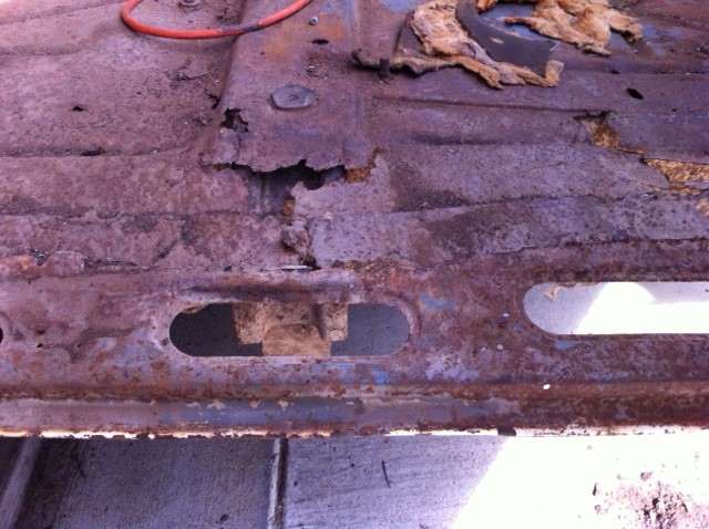

    Starting on the 51 Mercury and having problems understanding what the inner rocker panel is supposed to look like. If I start the panel at the seam of the outer rocker and floor pan and drop it down to the bottom of the outer rocker I won't be able to attach it to the side of the floor brace (will be a 2 inch gap)- I hope that makes sense! If I start the panel at the side of the floor brace I won't be able to connect it to the outer rocker panel. Unfortunately both sides are too rusted to see what it originally looked like and haven't found any 51 merc.s locally to look at so hope someone here can help me. Thanks

    MANY MANY thanks to all of you for the pictures and descriptions, I'm going to be making the panels so I had nothing to go from and your info. has given me a pretty good idea of what I need to do. I really admire all of your work and hope mine turns out close to what you have done. Again many thanks!!

    Mikestude was making them and peddling them on flea-pay for both 4 and 2-door models. There is another outfit that makes the 2-door version advertized on flea-pay too. Mike is likely the only one out there that was fabricating the inner rockers for 49 to 51 Mercs ( they all use the same part whether 2 or 4-door). There are likely a few others that make their own out there but you don't see them advertised. Prices vary from just over $300 to the mid $400s depending on the body style or part needed.
    None of them are exact copies of the OEM parts. I've seen some NOS stuff on the flea-pay a few times but they always want too much money for it. The drawings in one of the above posts for Green Mountain Parts are Mikestudes drawings. The inner rockers are pretty close. The outer work fine but are missing some of the OEM details that are unseen when the car is all put together.
