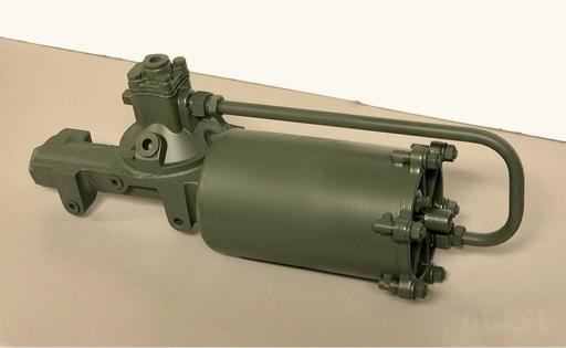

  5. Morgan Milstead
    Joined: Dec 20, 2020
    Posts: 23
    Morgan Milstead
    This master cylinder set up is neat! It looks like a 30/30 chamber activates this whole thing and this will also double as emergency brakes as the rear half of the 30/30 chamber extends when air is released so it will act like a parking brake as well. This is a game changer for big hydraulic brake trucks as the systems can be very hard to get parts for.
