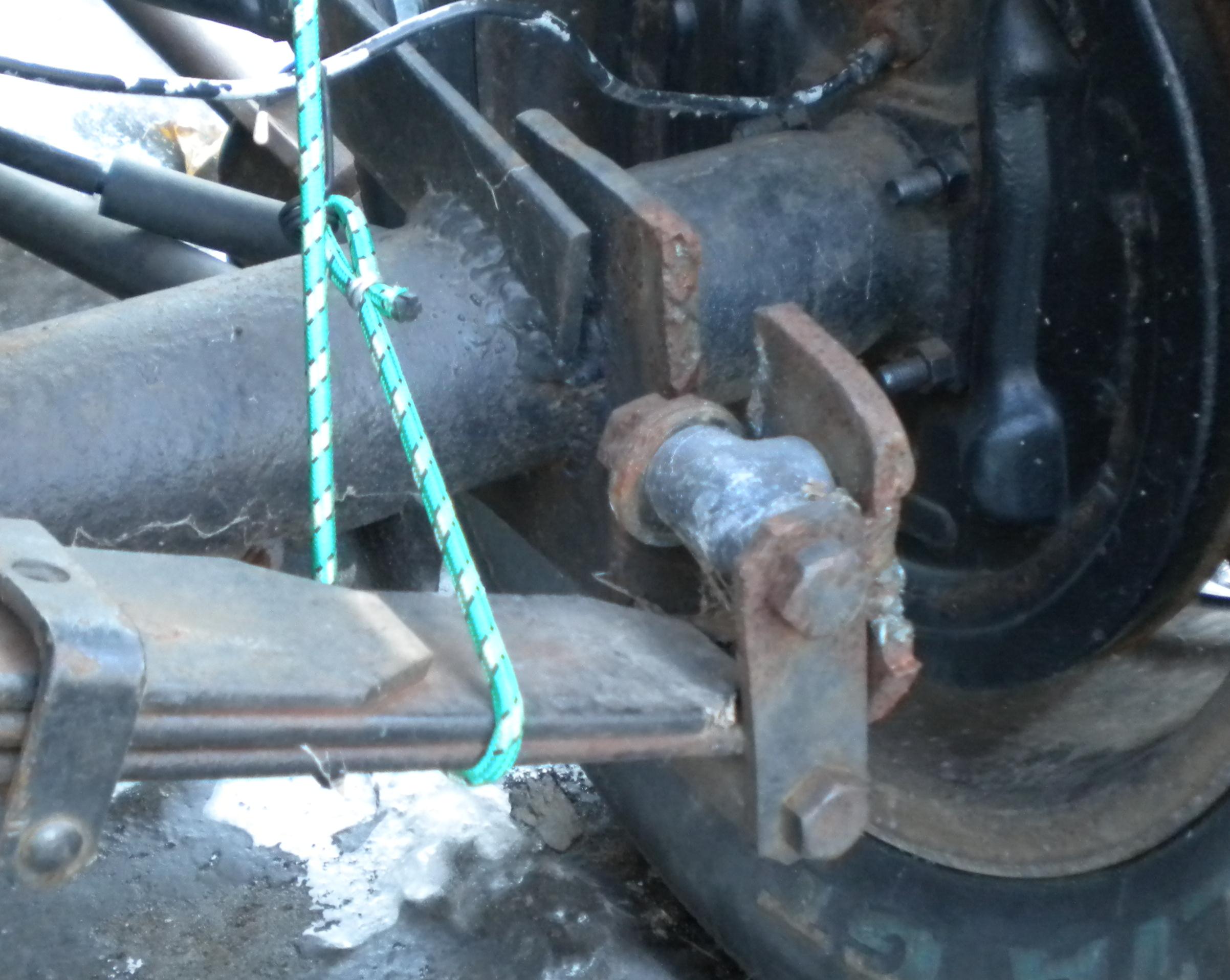

    Ok Guys I need some help. As you can see I have a problem. I bought this sight un seen. Big mis-stake!! Now I need to fix it right. How do I know where to weld in the new spring mounts with this buggy spring?? Thanks much for the help. Hickory

    Clean that junk off;Buy some new shackles and put them horazontel to out side or spring with what ever new bracket /make or buy, no load,weld them on axle,after the load is put back on ,they will drop down so you have about 45* angle on shackle:cool:

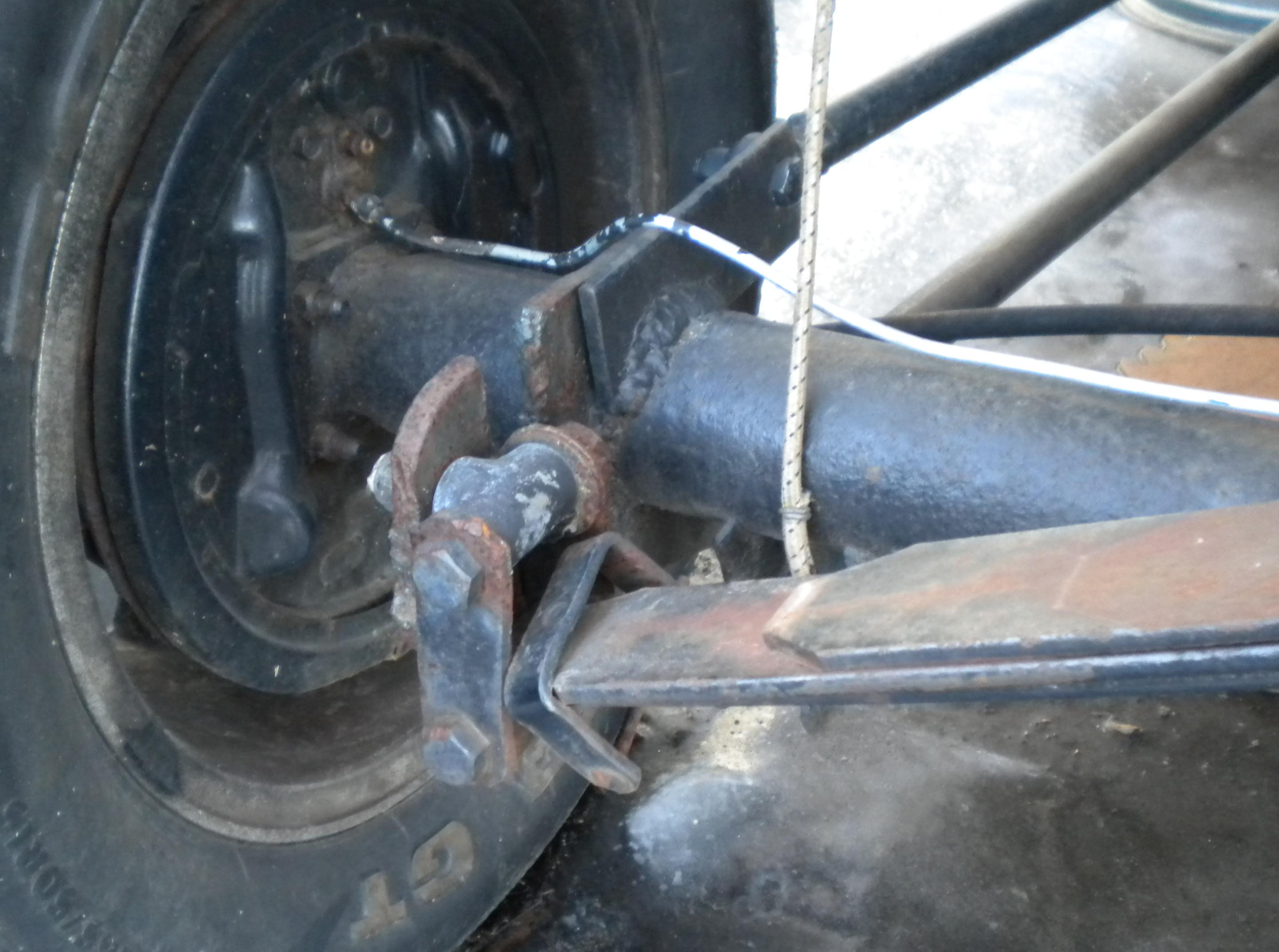

    It looks like a Model A spring there so the perch eyes should be about 49.5"(verify this, I'm working on memory here) apart center to center. Shackles should be 1.5" each. Engage one shackle in the spring eye and perch, then spread the spring eyes to engage the other shackle. This will give you a tensioned spring and the best ride like Henry designed it.
    The whole setup there, both spring perch and radius rod bracketry is junk. Carefully cut it all away and buy some Pete and Jakes or even SPeedway brackets for both spring and radius rods.

    I agree it looks to be a Model A spring - more pictures and a measurement of the leaf width would help to confirm. 49.5" is the correct measurement between the perch eyes for a stock Model A spring. These springs are under a LOT of tension when installed on stock width perches and may be on your "installation" also - be very careful.
    If you're planning on using the same rear end with new brackets, etc., you might first want to check that the housing hasn't been warped by all the previous attempts at welding.

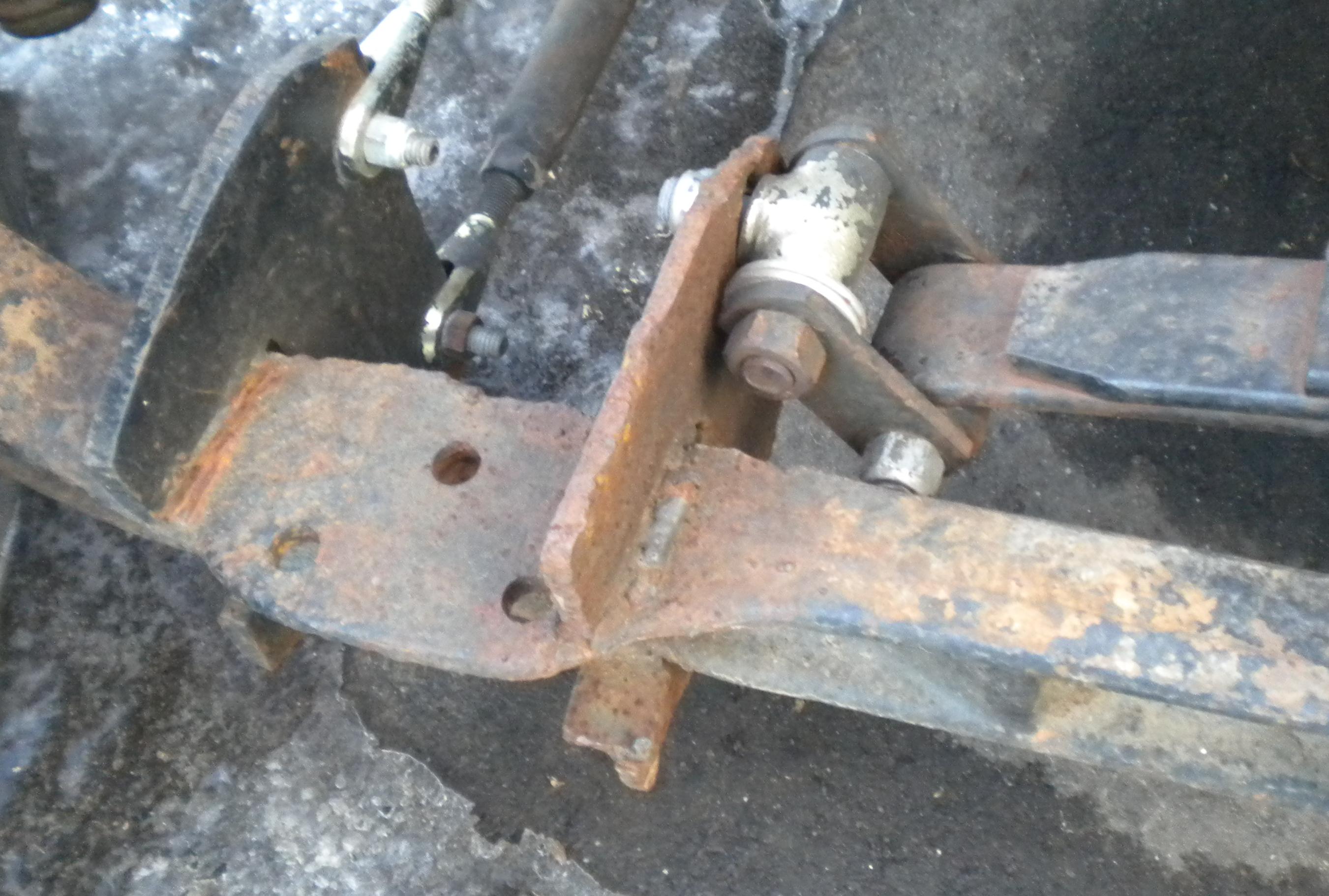

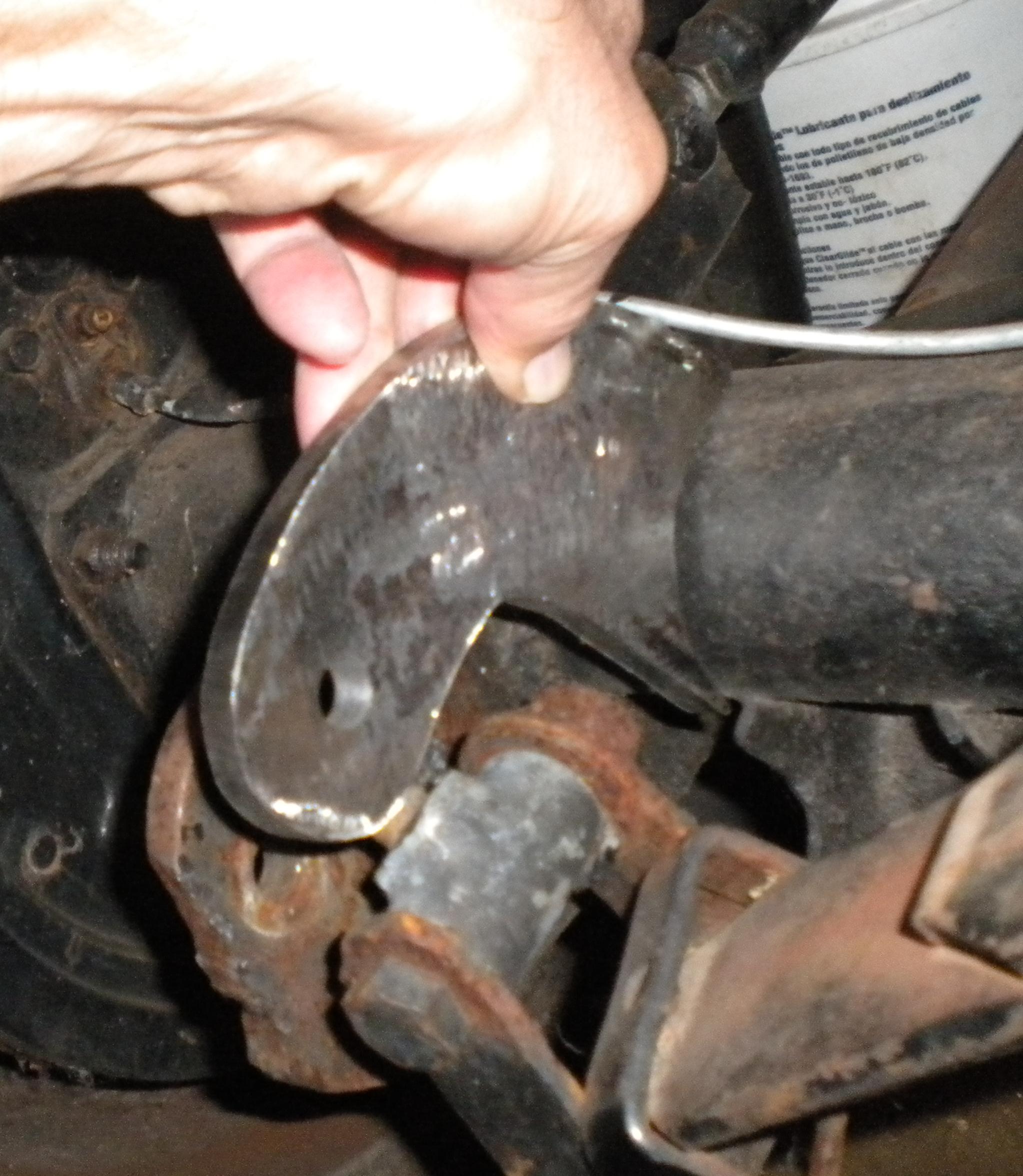

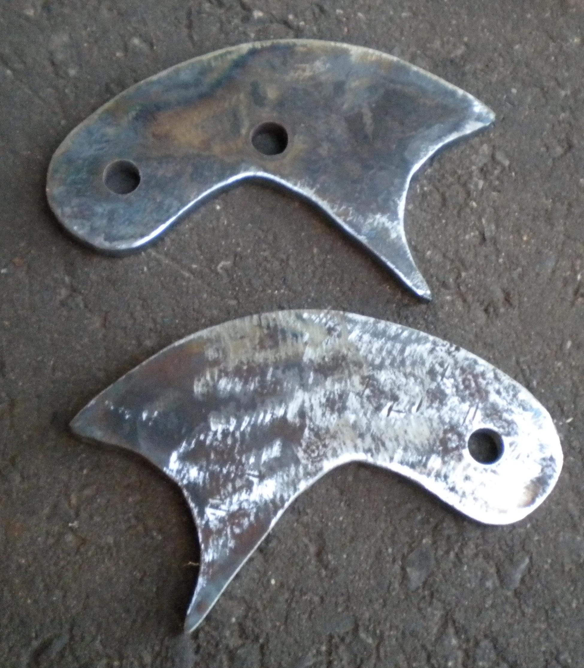

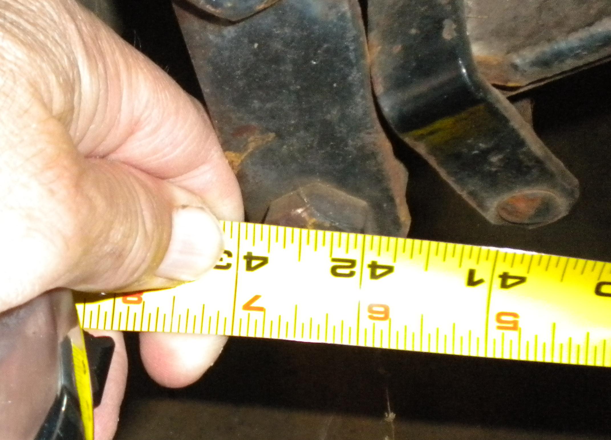

    Thanks guys, I'm going to let you see some more!! Next post. But first, I came up with, the spring off, eye to eye at 42-1/2 inches. Pictured are a couple of brackets that I made and I have new speed way spring pivots. Think it will work? Hickory
  8. 2OLD2FAST
    Joined: Feb 3, 2010
    Posts: 5,260
    2OLD2FAST
    from illinois
    Those shackles appear awfully long...should only be about 2" c to c. Brackets will probably work but need to be reinforced w/a gusset inline w/ the axle to prevent side to side flex/failure. Unloaded the spring/shackle assy should just reach the brackets, even some preload is a good thing.

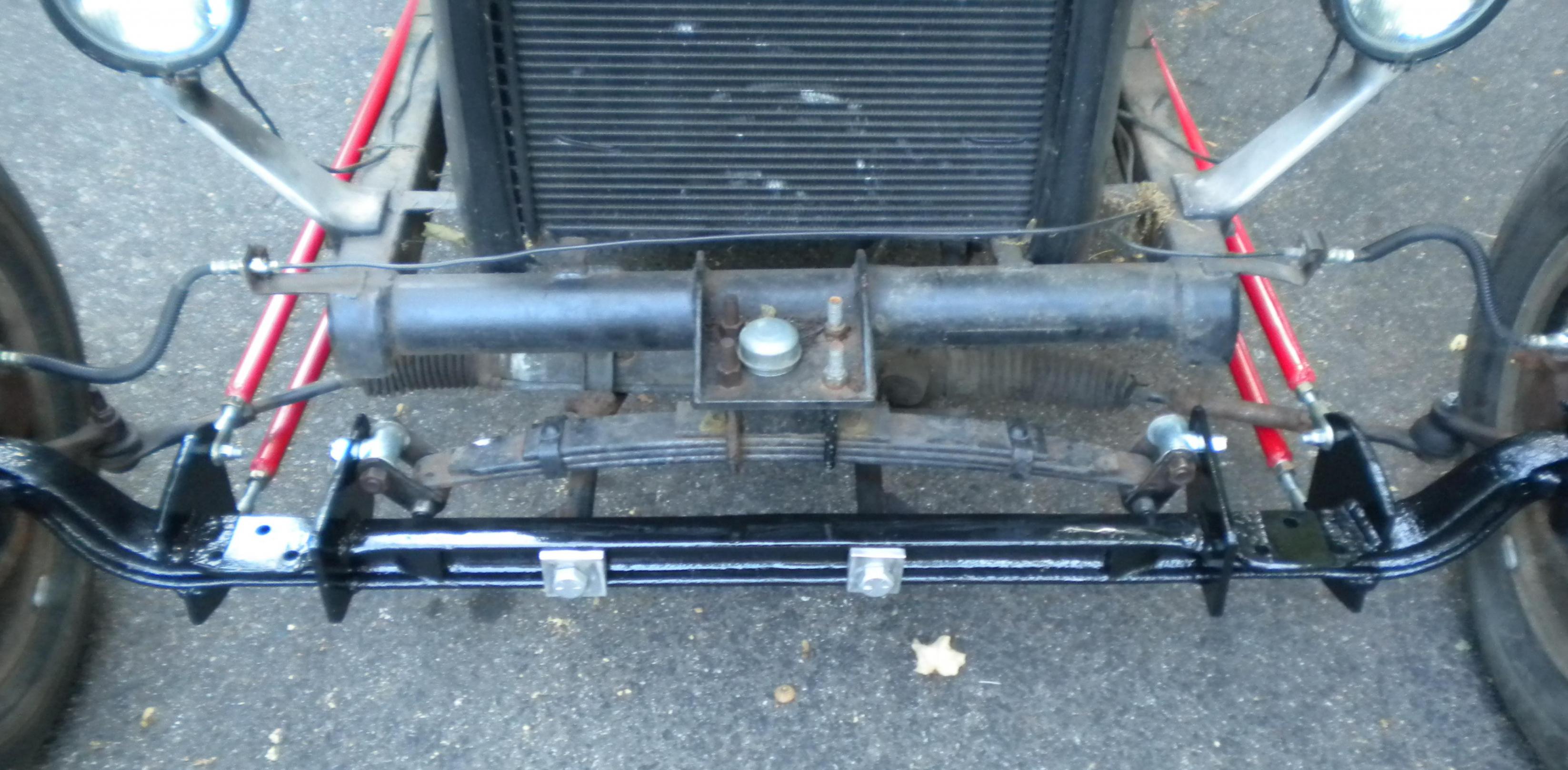

    This is what I had on the front to start with. And the second is what I came up with. Axles out of a Chevy van?? Hickory

    DO NOT reinstall that rear spring unless you increase the mounting eye spread to 49.5" eye to eye. COrrect length of shackles is 1 1/2" eye to eye. You'll just have a cleaner and still sloppy installation. You can make up a spreader to do it right OR install the main leaf and both shackles then stack the other leaves, probably about 5-6 should do it, on a length of all thread with nuts on both ends. Wrap the spring loosely with a length of chain, then pull the leaves down using large C-clamps. As it comes down, rewrap your safety chain. When you have it down flush, tighten up the chain, and clamps, slowly remove the all-thread and install a proper spring center bolt and tighten it down. Then remove the chain and clamps and enjoy a working suspension, if all else is OK.

    I'd do some serious looking at that fawnky rack and pinion setup too.
    It would probably do you some good if you posted a full set of pictures of that little jewel. Every angle, body on body off, steering column mounts, shaft from column to rack, motor mounts, transmission mounts, radiator mounts, fuel tank, brake lines, fuel lines, shock absorber mounts(didn't see any), etc. i think we can already guess the wiring is ........well ?

    With that frame mounted R&P it is going to be un-driveable with the wheels flopping around like a fish out of water. And even if you do manage to drive it those un-gusseted front spring mounts are going to fail. Cut the whole front end off a try again without the R&P for starts , best idea is replace the entire front end. If the rest of the car looks like what we see here it's RR for sure.

    Ok, that being said, from what I see in those pictures you need to question every aspect of this build. The welds were not good and the way things were done is scarey. The rear end you already know about, and the front end still has some things that I would not put on a car..ie, the spring mount and radius rod mount welded like that to the axle, and the rack and pinion steering setup.

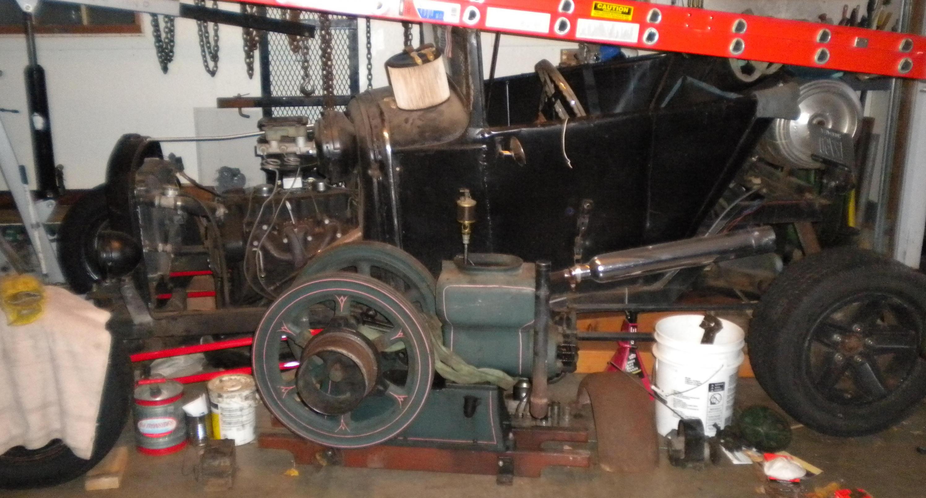

    Okay!! See if we are all on the same page?? I need to mount the new brackets 49-1/2 inches apart, from center to center of spring pivot to center of spring pivot and remake the shackles up to be 1-1/2 inches long?? This will roughly add 3 inches to the overall lenght of what I have now!! Thanks for your help, Hickory.
    I know it is a POS, but I'm trying to redo it into something safe to drive. I have the back half of a 31 Model A so I can build an "A" Bucket?? Whats your opinion?? Hickory

    Wow. Time to quit working on the rear end, you really need to strip that whole thing down to the bare frame and start fresh from there. That is what I would do if I were trying to straighten this car up. The basic frame looks maybe like it is savable, but no way to know that until you have pictures of it stripped bare. This is not going to be a quick fix, and I think you have to accept that fact.
    Where did you find this car ?

    Seriously, THE ENTIRE VEHICLE IS SUSPECT. Either rebuild it all, or scrap it. It cannot be on the road in this state.

    I can't see anything for front shocks.
    What are those rods going to the rear off the front axle to the rear under the spring?

    That rack and pinion mounting is frightening! Very dangerous if driven like that.
