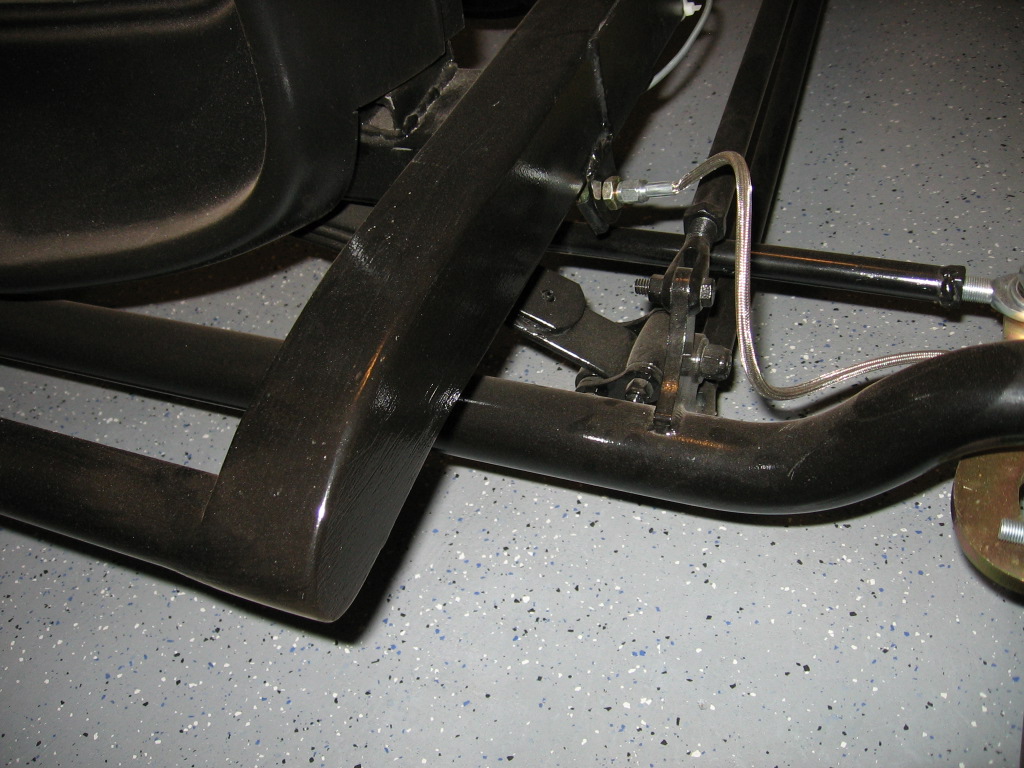

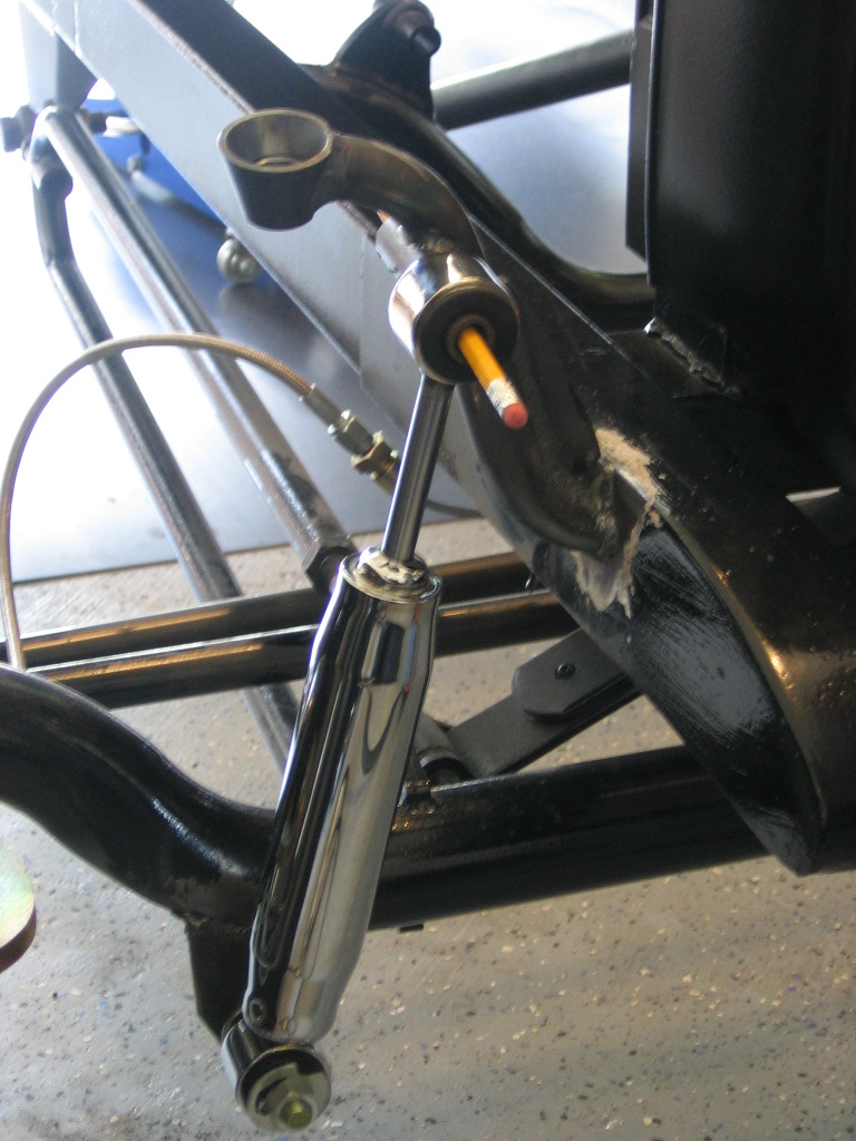

    Heres the pics of my front suspension if this helps at all?!?!

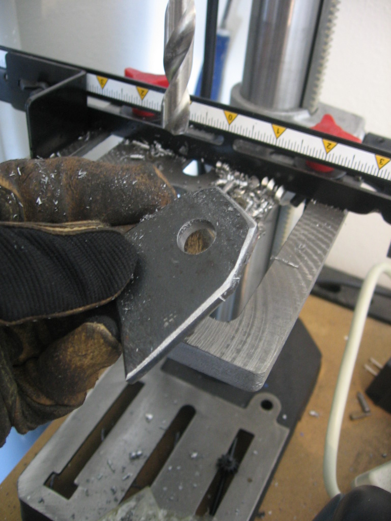

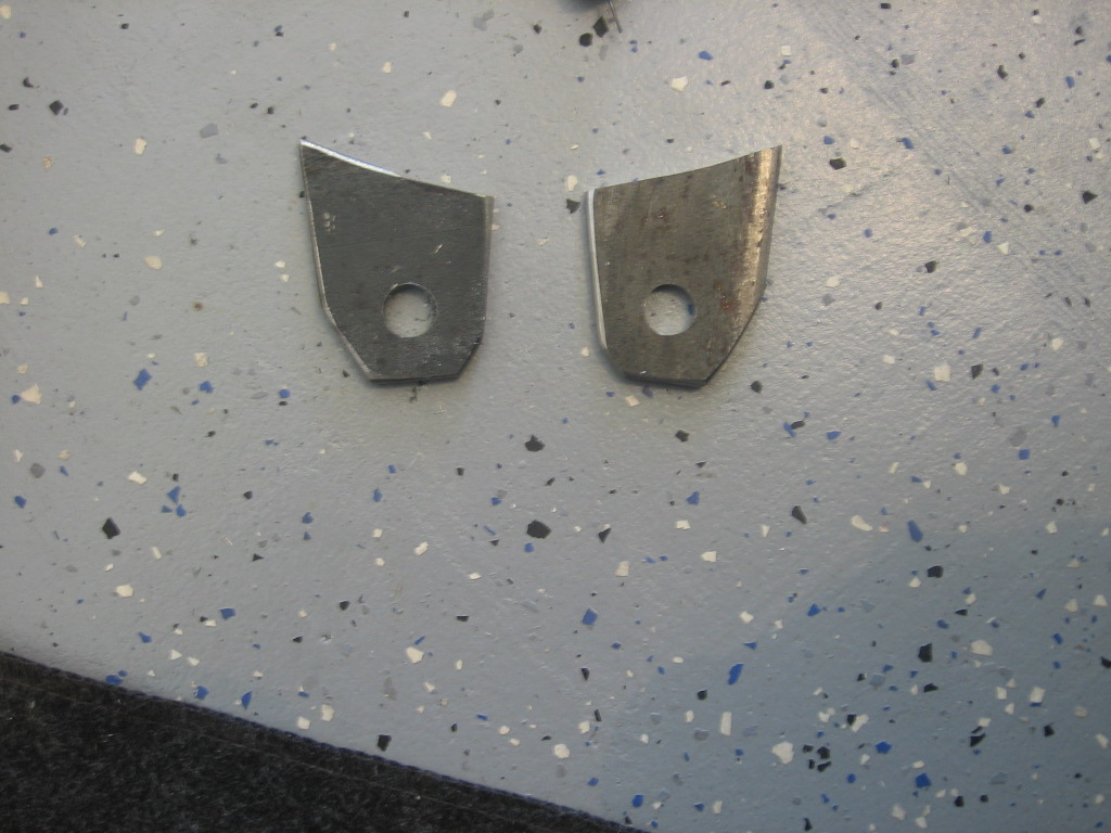

    Ended up making some lower shock tabs from scratch....turned out great!

  12. the shock mount looks good but the real scary think is the fact that you are using a drill press with gloves on.... are you crazy
    be careful buddy
    tk
  13. WhiteDevil
    Joined: Jun 22, 2009
    Posts: 707
    WhiteDevil
    from Wichita KS
    NICE! Its called going from grinding to press to grinder to press....and learning being that 5 min before I dug a 1/4 inch gap in my knuckle with the grinder
