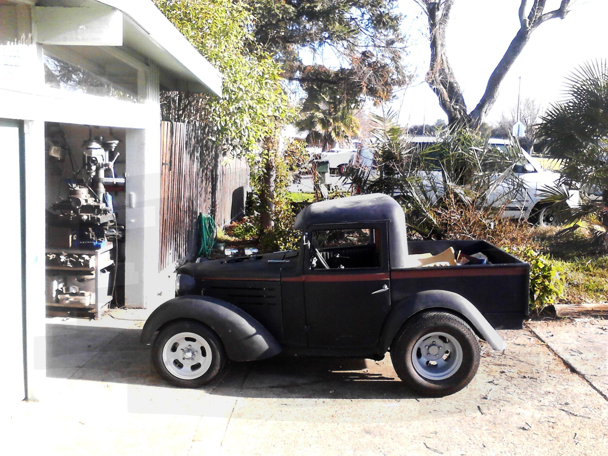

    BUMP. So I've raised the back of my lump two inches to incorporate some big fat meats, because when you're runnin' a v8-60 traction is of the utmost importance. :)
    It rolls more in the corners now, maybe the higher CG. If I raise my panhard bar (rear) will it significantly improve roll resistance? Right now it is about an inch above the axle line and parallel. If so how much? Rear 'bite' is not a concern, I only brake the tires loose on my front lawn when my wife isn't home.

    ^^ Paging Kerry in NZ...and what happened to El Polacko? So from what I gather I can raise only the frame end of the P bar (easy) at least for a test, which will raise the roll center but leave the bar at an angle. Maybe I will try that. I may radius the fender another inch higher so I can lower it.

    Sorry for the late reply, I was busy doing stupid shit in my garage [ welding galv steel while wearing flip-flops ]
    You are going down the right path with your thinking.
    Understand in most cars you have 2 parts to weight transfer at EACH end .
    You have total weight transfer at the centre of gravity . This is calculated as Wt x CGH x G’s ÷ TW [track width]
    And you also have weight transfer through overturning moment [body roll]. This is calculated as Wt x [CGH –RCH] x G’s ÷ TW [track width] This is the tuneable part.
    So unless the Roll Centre Height [ RCH ] is at ground level . the weight transfer through body roll is usually less than total weight transfer.
    By raising the rear you have actually increased the amount of weight transfer during cornering.
    The RCH of a panhard bar is where the bar passes through the centreline of the car.
    One end is fixed to the frame and the other on the rear-end housing, so when you raised the rear 2” you also raised the RCH 1” .So the distance between the CGH and the RCH is getting wider, which also lowers roll stiffness. The panhard bar will need to be corrected back to horizontal again.
    Now here is the clincher: By raising the rear your vehicle will now understeer more. It will lean over more but the front end will also push on the corners.
    This is because when the rear wants to lean over more, a higher proportion of load is supported by the outside front wheel [ the greater the loads, the greater the slip angle ]
    There are 3 ways to remedy this:
    1: stiffer rear springs which makes the ride harsh.
    2: Rear anti roll bar to increase roll stiffness only.
    3: Raise the rear roll centre [ as you have already discussed ]
    One more thing. By raising the rear end, you have changed the angle of the linkages in the rear suspension into roll oversteer [ when the suspension compresses the wheelbase lengthens]
    Because your vehicle has such a short wheelbase ,this will make it dart all over the place.
    You need the suspension links to be horizontal at normal ride height, so when they compress and move on an arc it shortens the wheelbase [ roll understeer ,which is more stable ]

    Thanks Kerry, I think I understand. :) Gonna raise the panhard mount Thursday, will report back.

    I crawled under there last night for a few minutes, looks like my new panhard mount will put the roll center height at about the top of the center section (8" Ford, so about 4-5" above axle), hope that's not a ridiculous height.
