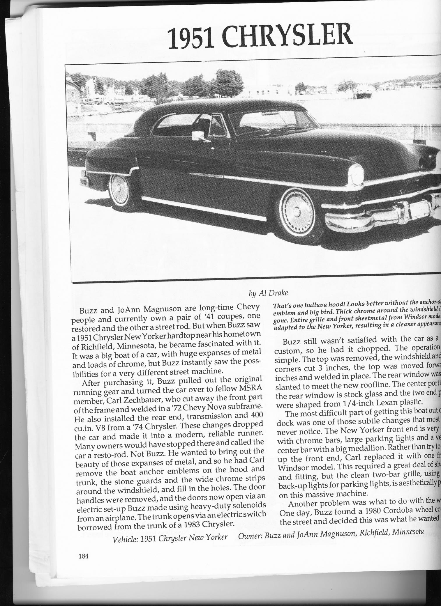

    I like it fine how it is, but if you must change it, I've always liked how this '51 was done. Especially the front end:
