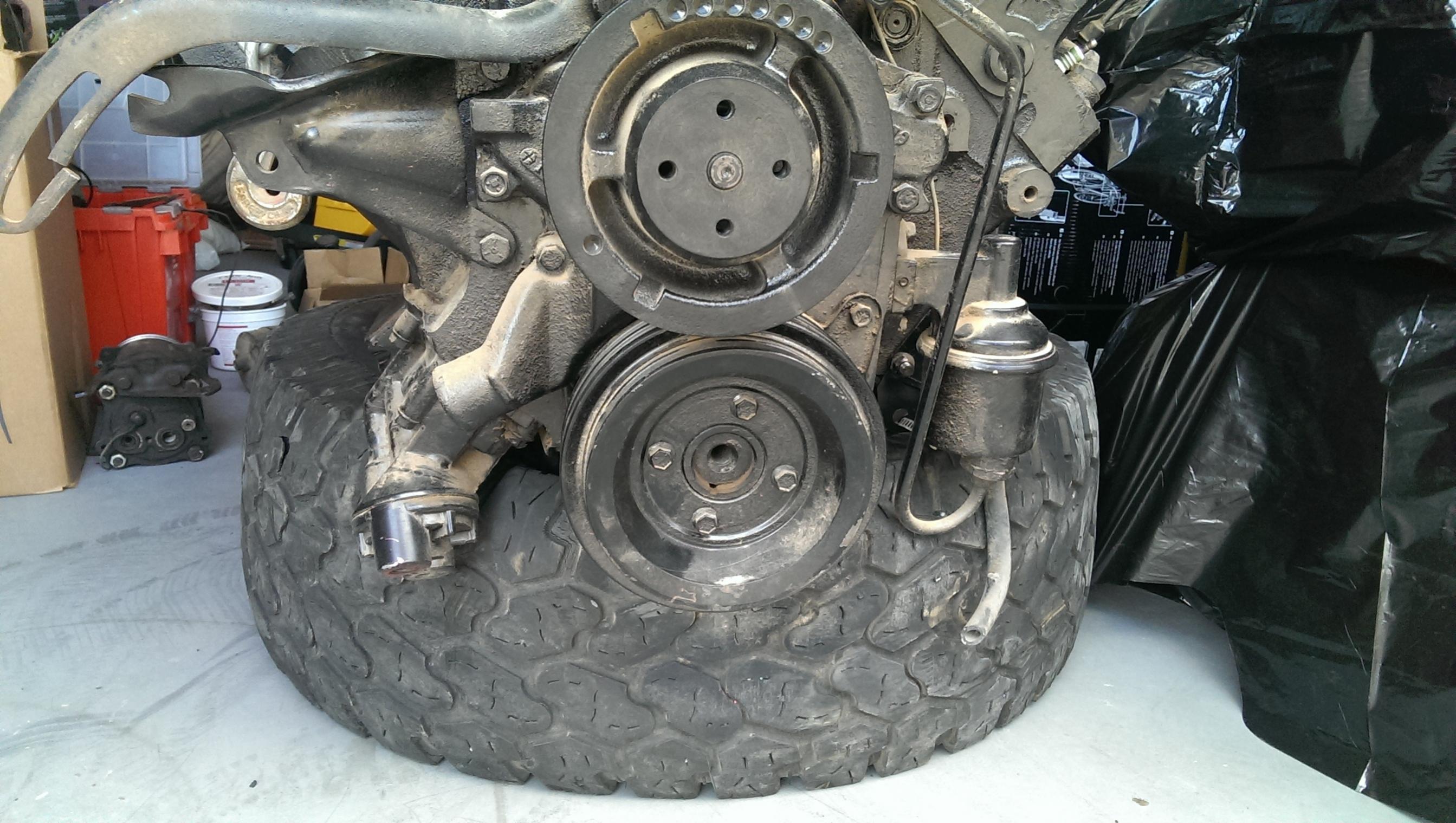

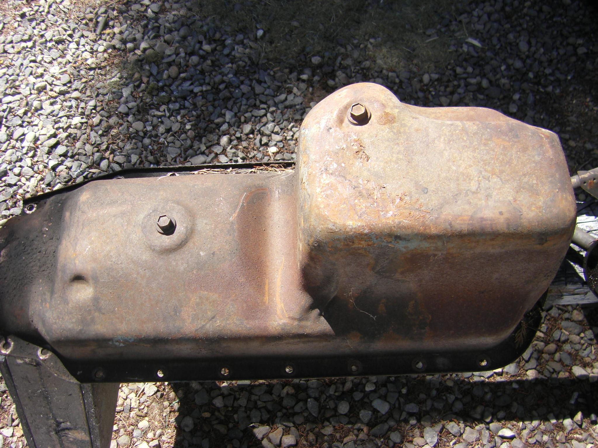

    Please see the attached pictures. Can anyone tell me if my oil pan is from and Eldorado? Does this oil filter look like the right one? Also, were does the starter mount? Thank you.

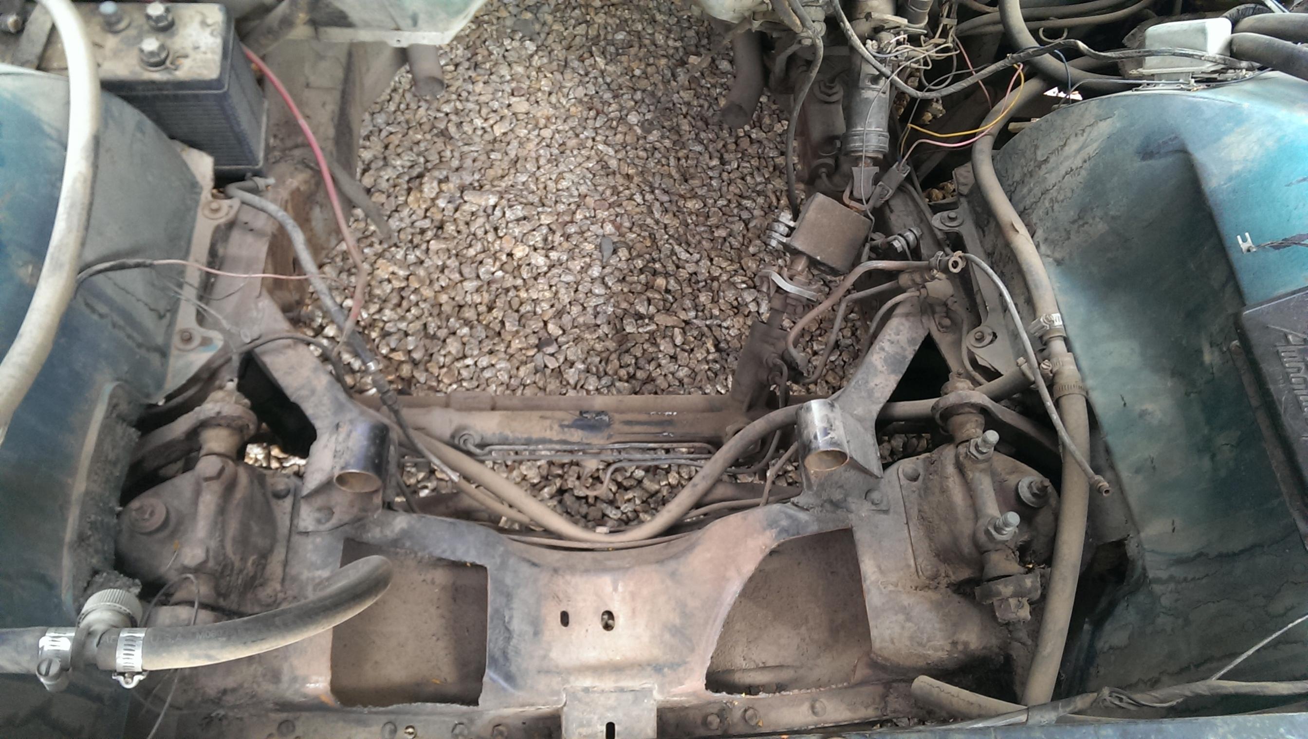

    Picture of cut crossmember

    The oil pump looks like it has an attachment that would allow you to run lines to a remote oil filter. I haven't heard anything good about doing that but if it didn't work, I don't think they'd still be on the market. I was only going to do that as a last resort. The pump is the 472/500 style pump that sticks the oil filter out too far.
    It looks like you do have the rear sump Eldorado pan though its hard to see in this picture. It should clear all of your steering. The steering looks like the Mustang II rack and pinion set they sell at speedway. It appears to have made your space issues worse than the stock steering box that was mounted to the frame. You might still be able to use stock 472/500 exhaust manifolds that dump in the rear.
    The wholes in your frame look like they were cut for something else and won't help you much. On mine it looks like the clearance needs to be added to the rear side of the cross member and just on the oil filter side. Those will probably give you strength issues when you put all that torque on the frame. I would check to see what part of them help you and patch anything that doesn't.

    Then again, my 48 is a Pontiac that had space for a straight 8 so I've got room to move the engine back off of the cross member. Those wholes might be what you need. I would still do something to brace them and add back some strength.

    If that's a Mustang II rack you have some bigger problems than stuff fitting because those are front steer. I'm going to guess that it's not though. Judging from the steering coupler I'd say it a Jaguar XJ6 rack, and kind of hard to tell from all the odd cuts, but is there a chance that an entire Jag front end has been slid up into the stock cross member? One way or another, that rack is so far from being geometrically correct that that car will bumpsteer all over the place. Can you go back to a steering box? Are the stock mounts still there.
    Sorry, I don't know a bunch about Cad 500s, as the last one I did was about twenty years ago. I was fishing for some info on a possible swap I might be involved in, but I'm very concerned about that rack set up...
