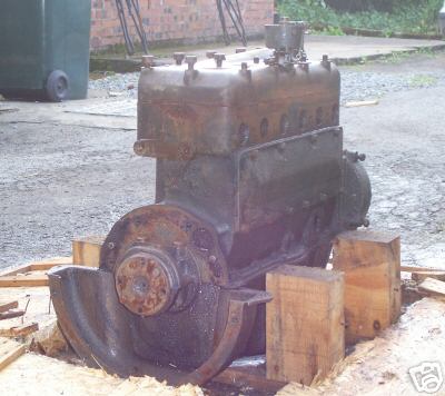

    Can anyone identify what engine this is, whether its an A motor or a B motor. The engine number is TF 5315912.
  2. You've shown the wrong side for identification purposes but it is a 'B' engine.
    The only thing that concerns me with that engine is that it may be a baby 14.9 'BF' engine.

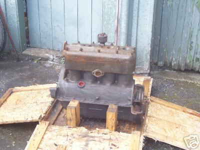

    Is this any better...Cheers

    Thems is a B--unless it's a BF.
    Wide valve cover, diamond shaped pad for fuel pump. Now measure the bore--B started life at 3 7/8", BF considerably less.
    (Edit) I think it's going to be a B, from the look of how the oil tube sits--I think there'd be more room behind it if a BF.

    Haven't picked the motor up yet. If it is a BF motor is it the bore thats just the difference, if so can you bore it out to the same as the B motor.

    No--the difference is very large, and basic casting of cylinders is smaller.

    Totally different bore sizes. I think you can see it from the outside in that there is a gap between each bore. I believe Phil (MonkeyBiker) had a 'BF' engine at one point so he should know.

    "TF 5315912"...just noticed serial number. I've never found any information on how British Ford numbers worked, but that number seems to be in series with American numbers. B numbers began at 5,000,000 as an arbitrary point continuing from the Model A series. I think that's a vey late number, probably long after USA production stopped except for diamond B's. I assume the T means a truck that was no longer a BB chassis, perhaps some kind of Fordson cabover, and the F is for foreign--a designation that just meant right hand drive on a chassis number like this, but meant small bore engine when attached to engine parts. Dunno which it would actually mean in terms of the vehicle originally housing this motor. Is the number on the pad at side of engine (USA Model A practice) or on the bellhousing (USA Model B practice)??
  15. The engine number is on the pad.

    Interesting...I don't know if I am seeing an artifact of the digital picture or the real marks, but that initial "T" sure looks like it is actually two letters, the second a "B"! That would make sense, too...wish I could see the actual stamping.
    Letters are very odd and interesting--looks like Ford England had its own unique script to prevent forgery. Seems almost runic!
