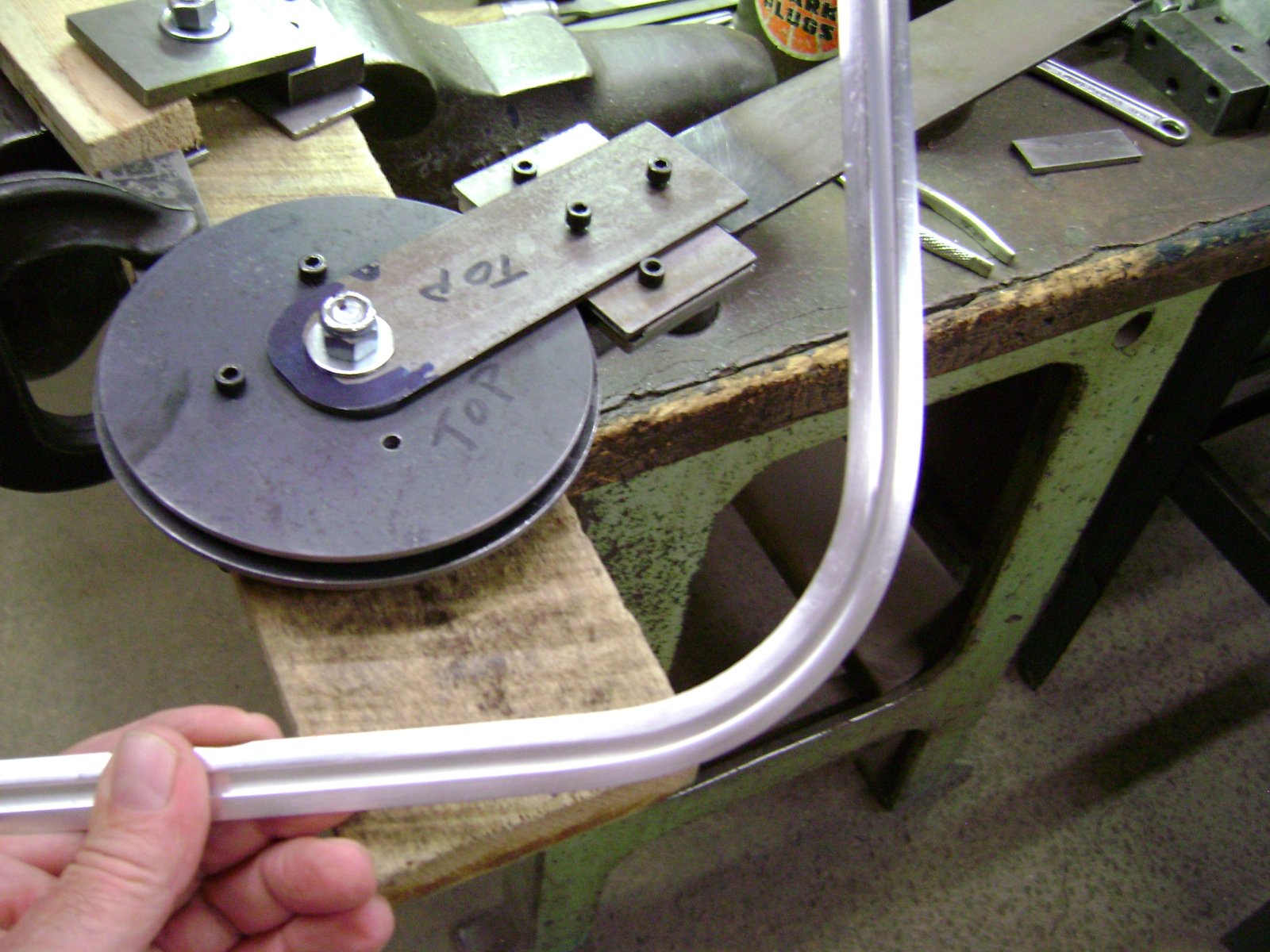

    Even if you manage to build a forming tool to make the bend, the next trick is to start the form in the right place, because you won't be able to move it afterwards. And to make building a forming tool difficult, the front and the rear radius are different.

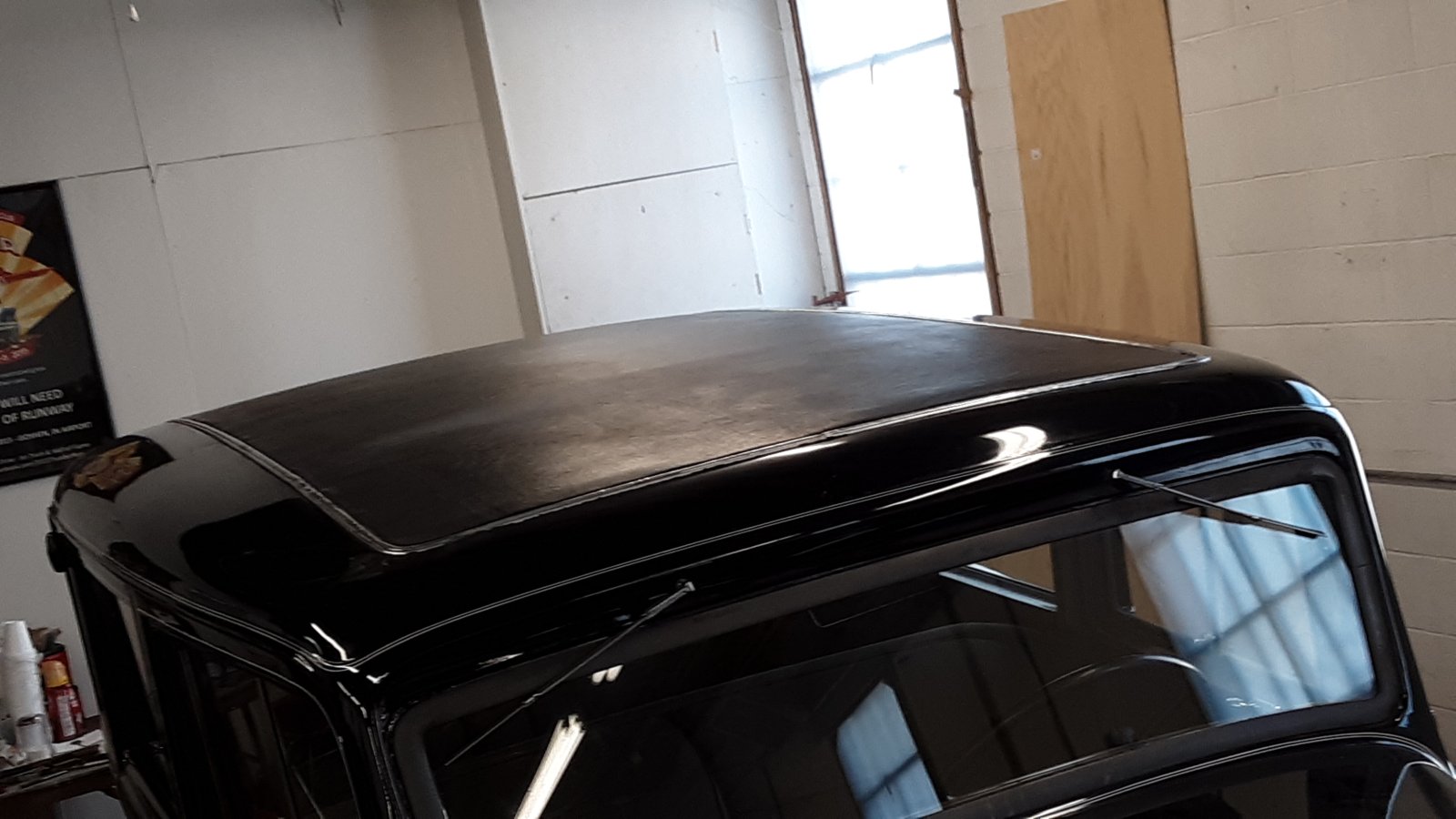

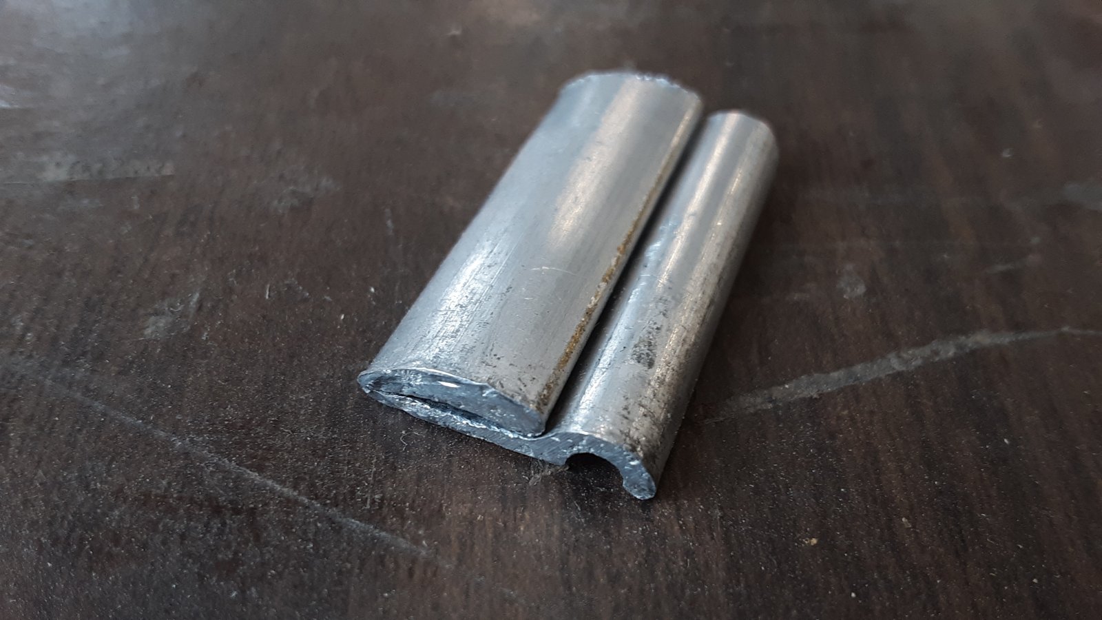

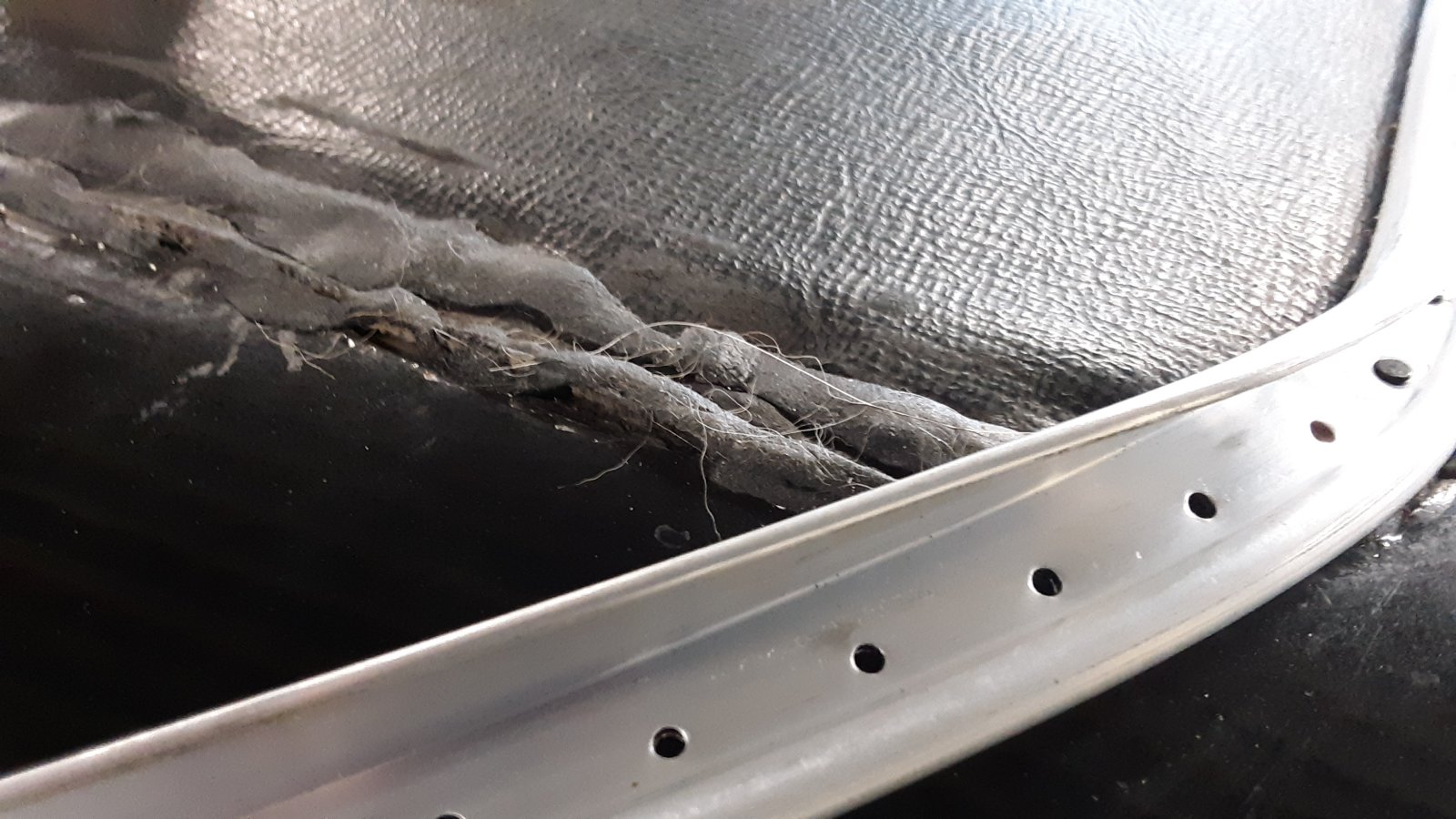

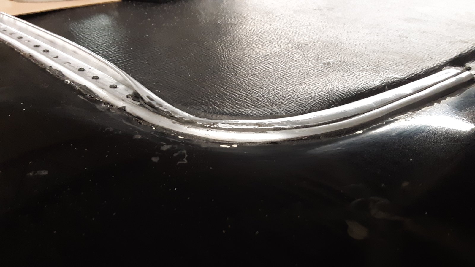

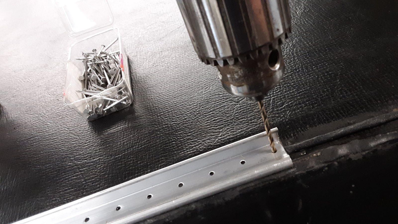

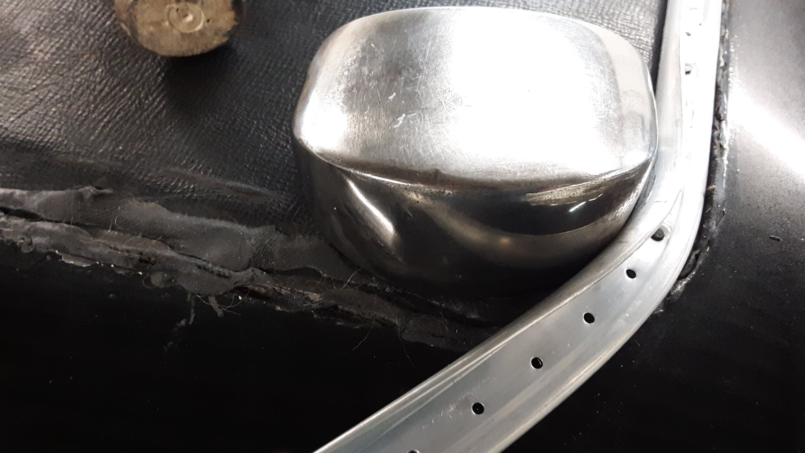

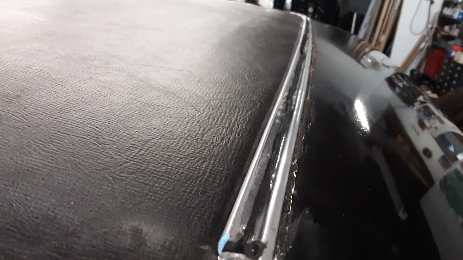

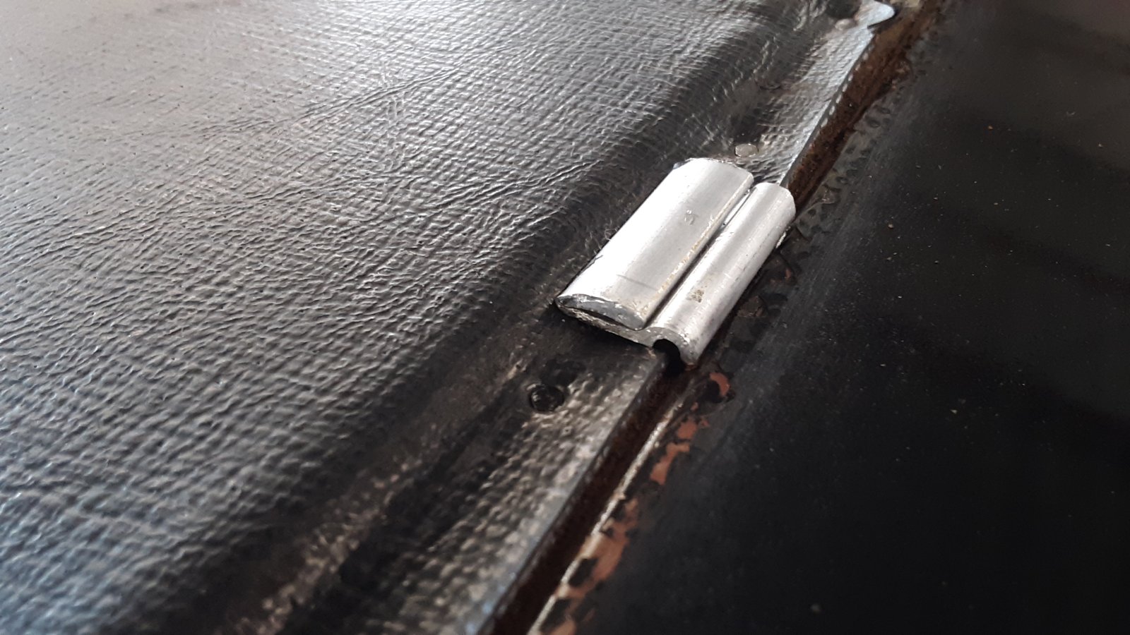

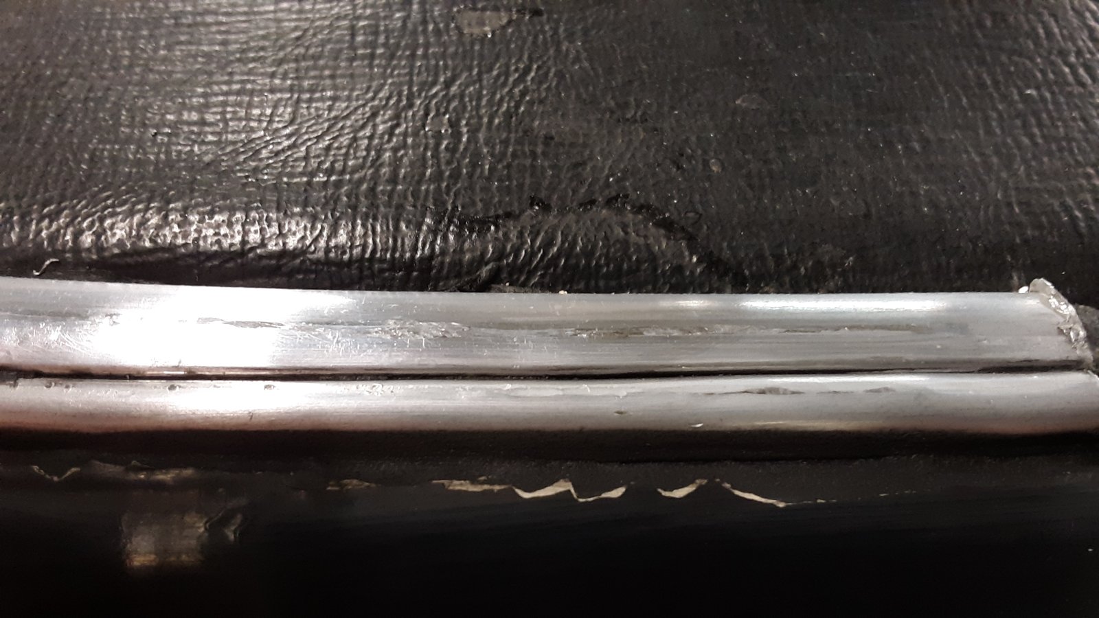

    I use this kind, form as you go. Yes, it sux, but the results are stunning when done right. Seal the top material, seal the top nails, seal the nails in the channel before it folds over.
    I smooth filed and brush painted this one, an all original Packard. Hope this helps. 1 trick, for nails stay just above the nail head with a small dia drift vs resting on it. More force faster when you tap em in.
