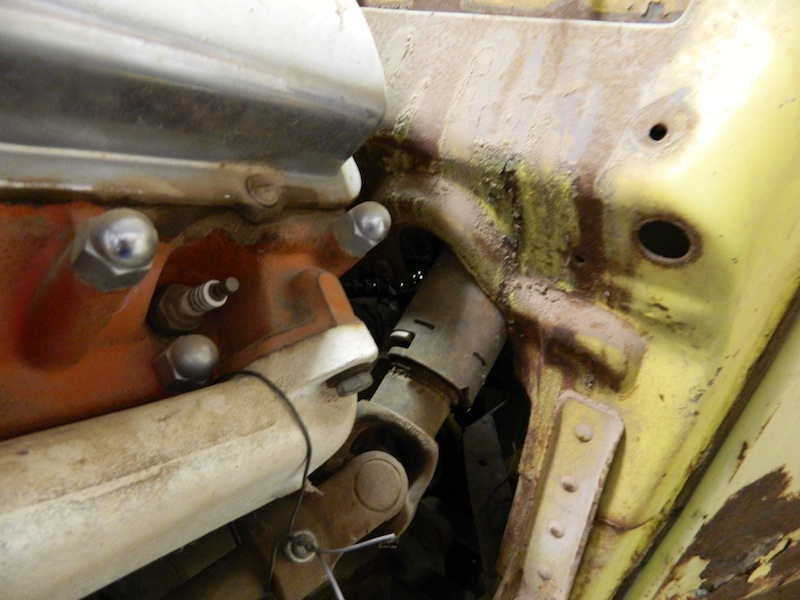

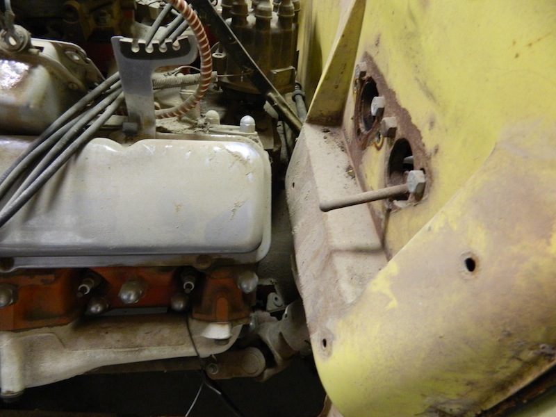

    How about a shot of the drivers side engine to frame clearance? I've got an f-1 box in my 34 pickup with a 283. PM me if you'd like and I can send you some pics and measurements of my setup. Your lucky the engines already mounted in your chassis, it'll be obvious what you have to work around without guess work. And I'm with Shaggy, not sure if I'd fuss with it, especially being full fendered. Cool ol pickup!

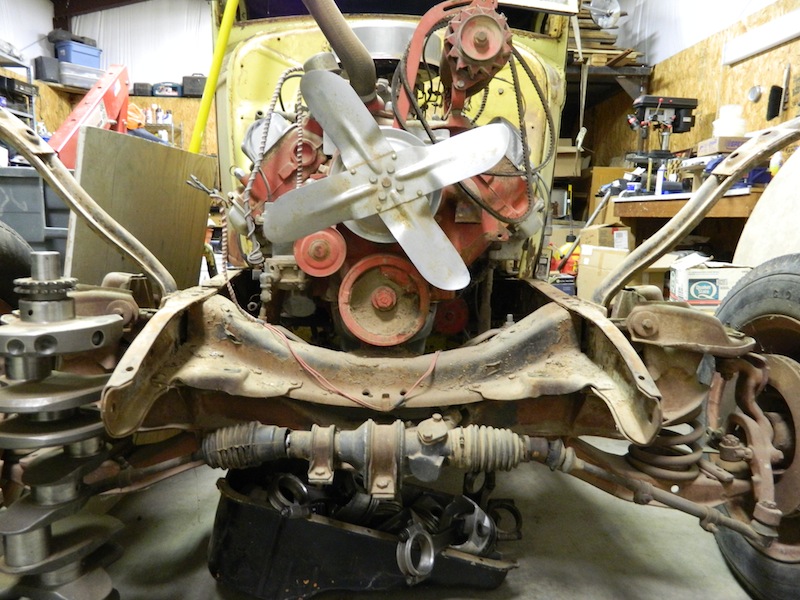

    Pics as requested.
  13. match
    Joined: Apr 29, 2009
    Posts: 25
    match

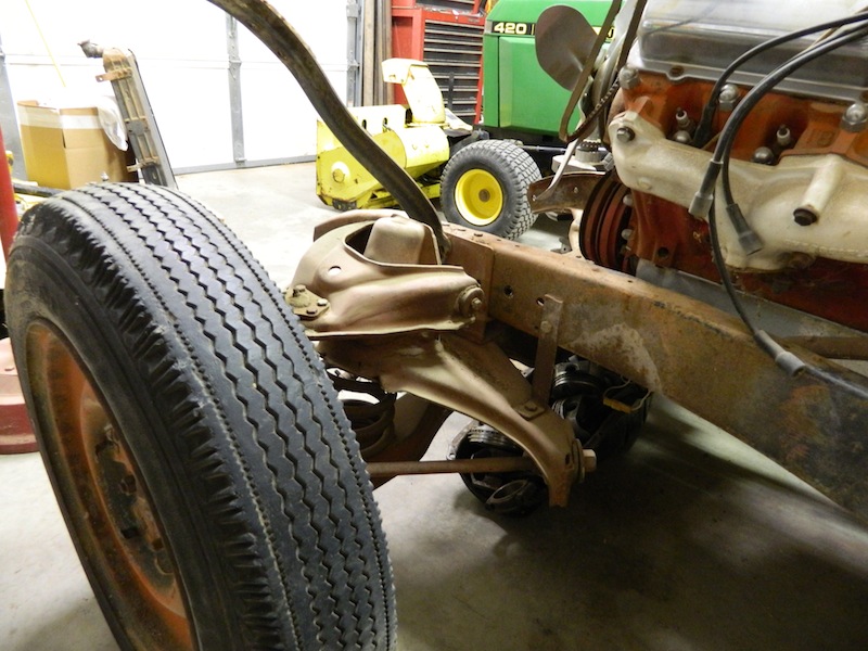

    I'm now know why grandad never could get the Corvair IFS steering sorted out. Look at the pic from the front of the engine. The steering links from the rack & pinion to the spindles are at a pretty steep angle. As soon as I jacked up the front of the pickup, the front wheels toed in about 2" per side. I imagine every bump he hit had the toe moving in and out through the travel of the suspension. The good news is it appears that the whole IFS setup is just bolted to the frame and should be easy to remove.

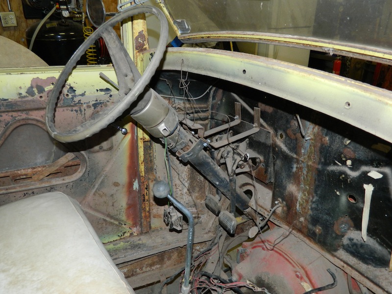

    Pics of what I'm sure what was in the truck for a column and gearbox before the IFS setup.

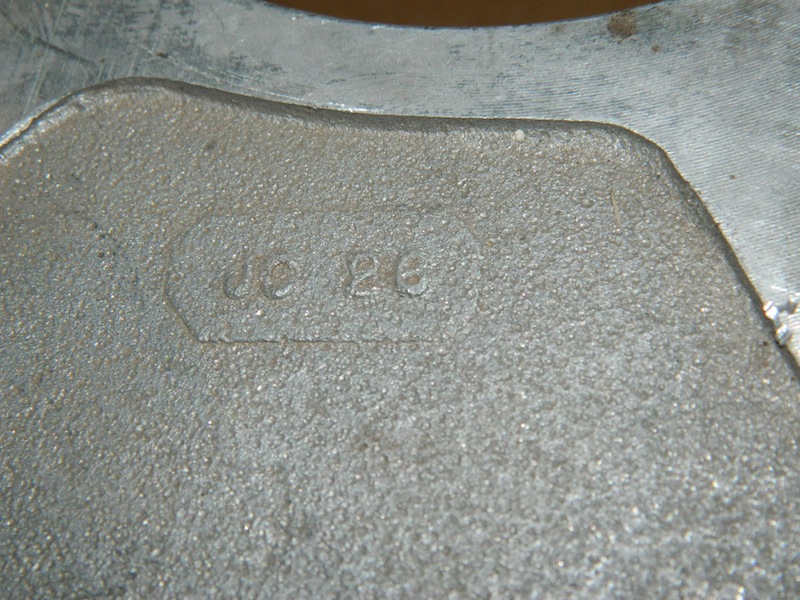

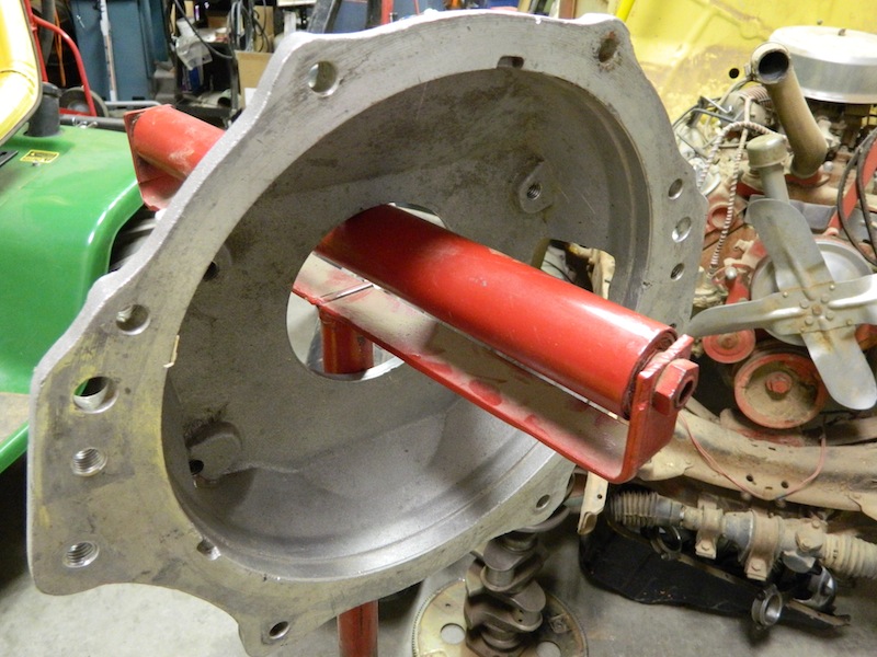

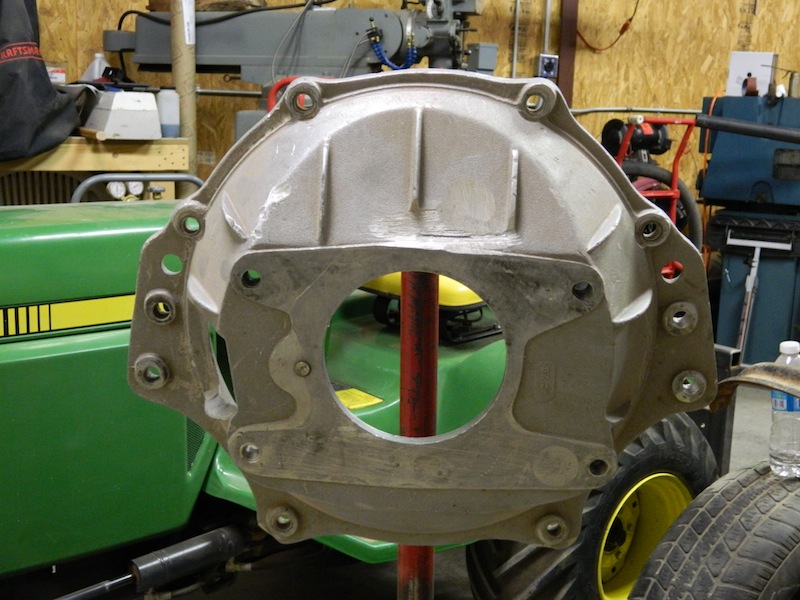

    A little off topic, but can anyone ID this bellhousing ? Looks like it might be for the Olds, seeing how shallow it is. It measures about 3.25" overall from the engine mounting face to the tranny mount face. The only markings are a casting "JC 26".

    match, the vega box is almost universal in rods up thru '34, but the GM 525 is recommended in fat fender cars, '35-48. It mounts on the same bracket as the vega, but is the next step up in strength, being a bit larger. Both of these are for cross steering, which works great with no bump steer. Left header/exhaust manifold should be in place, then some DD rod and a couple Borgeson u-joints ($75 ea.), and you are on your way. This style is not period '40s-'50s, but fairly modern.

    I think you should be able to fit a box in the stock place for push-pull steering, the only problem might be the starter location. There are bellhousing changeover bottoms for oldsmobiles to put the starter on the other side too, but i dont think they've been made for a while, they shouldnt be too hard to find, ive seen a few pop up on here from time to time
