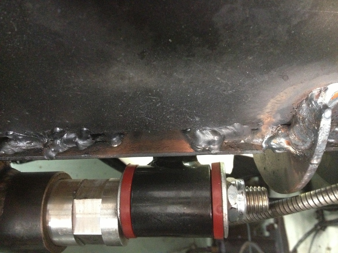

    Okay guys check out these professional welds. These came from a shop that someone paid good money to have their front clip done! The thing about it is this is the redone work! I won't name the clip, shop or vehicle. If the owner want to tell who what where I will let him. He came over my house to have me check out the "FIXED" truck. I got under and was in shock. I will call the clip a Mustang II not to give it away.

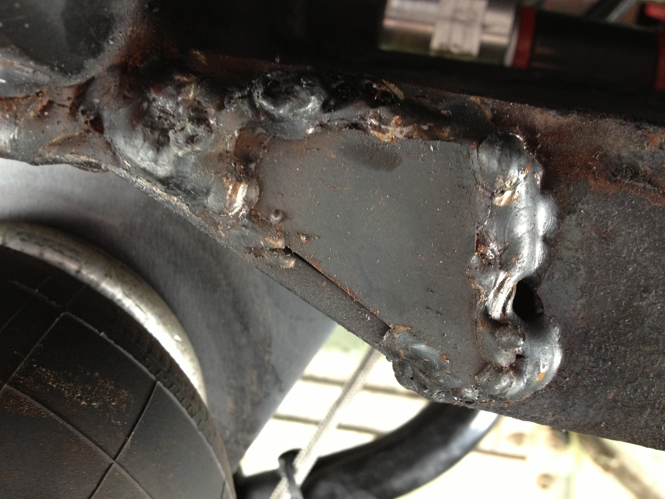

    Looking up at the bottom of the frame. This is their plate for the front part where the they added the " mustang II" it's not a Mustang II but if I say what it was people might know the person who did the work. I will let the owner chime in if he wants to. As you can see they didn't even finish welding the plate all around. you can stick something into the hole nothing is under it. I think the welds speak for themselves.

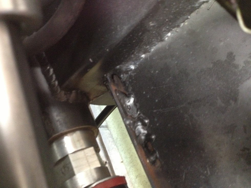

    The "Mustang II" clip was attached to a bent frame so to make up for it they welded 3/8 round rod to both sides to close the gap!
    This is the boxing plate not welded 100%! looks like they forgot to finish welding?

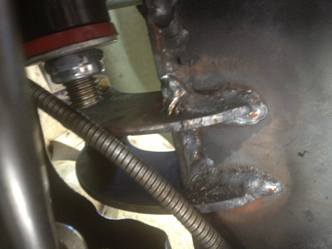

    Shock mount they didn't fit without re shaping them so they filled the gap with weld. The frame bent so now the shock when at ride height rubs the frame!
    Boxing plate. Not completely welded and weld puddle wasn't hot enough.
    Passenger side shock mount welds speak for themselves. Also not primed or painted.
    The other side plate welds. Note that the 3/8 rod has more of the sides showing because the gap on this side is larger.

    When I showed him a weld where they missed the whole side of the bracket with a cold weld and it wasn't touching the shock bracket he turned to the person and said I will have the welds x-rayed if it will make you feel better.
