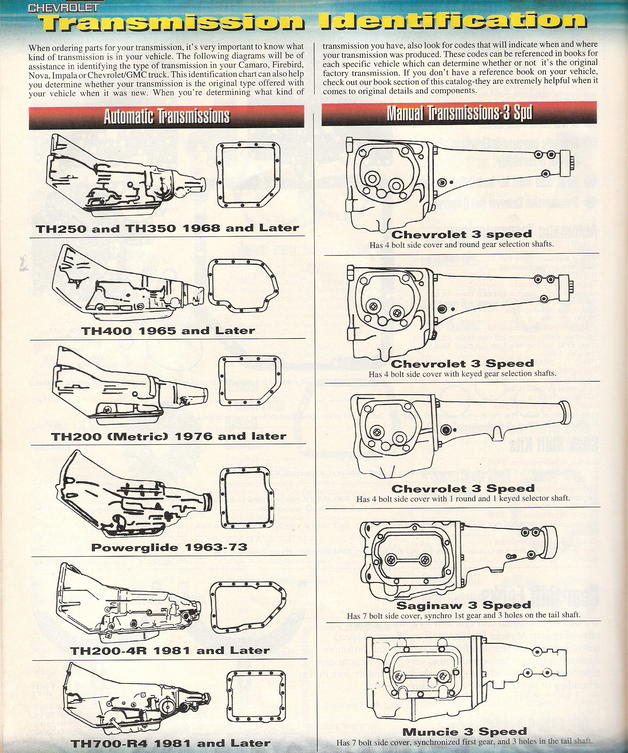

  2. attachment.jpg This is what I'm looking at when I'm talking about the 3 speed chevy transmission. From looking around the interweb I'm finding that they might be 55/64 ish muncie.

    the tailshaft housing off of the 55-59 trans should work on your 49 trans if my teenage brain in my 68yo body remembers correctly. or the whole trans should fit Tom

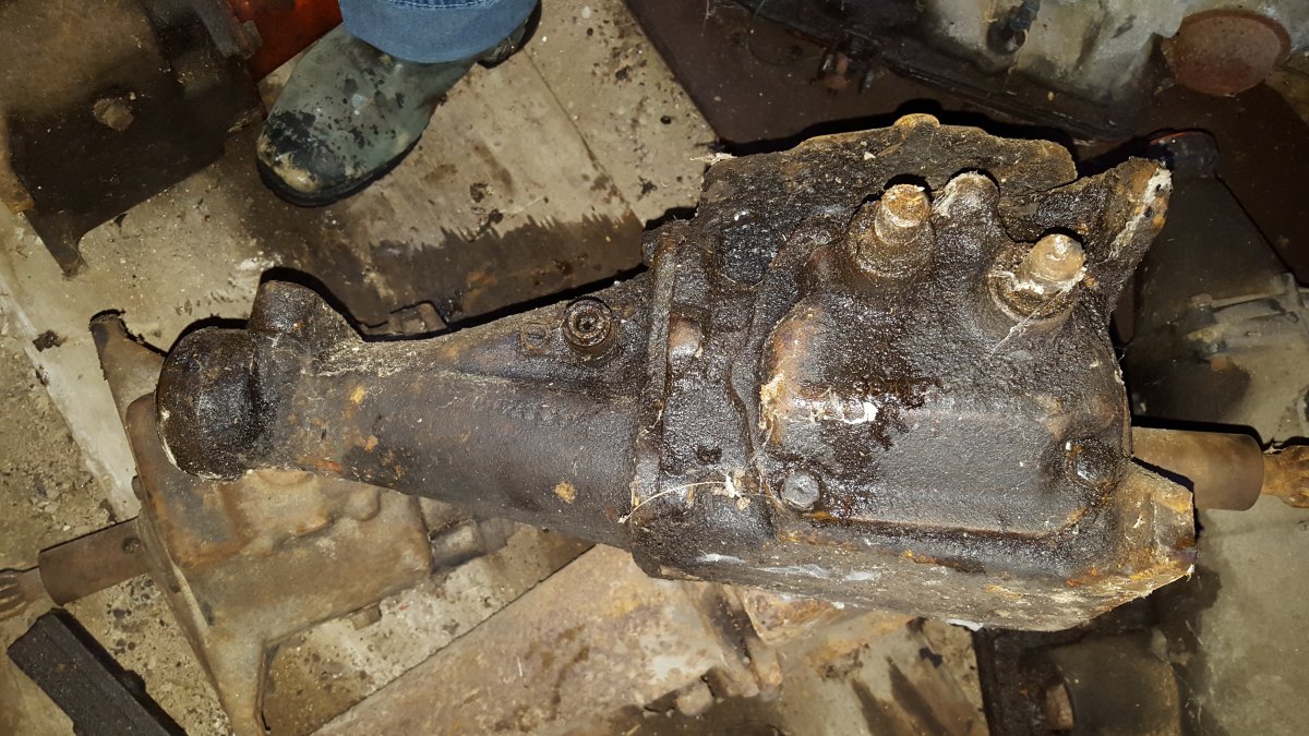

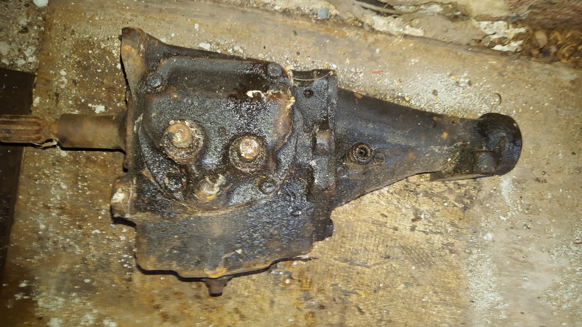

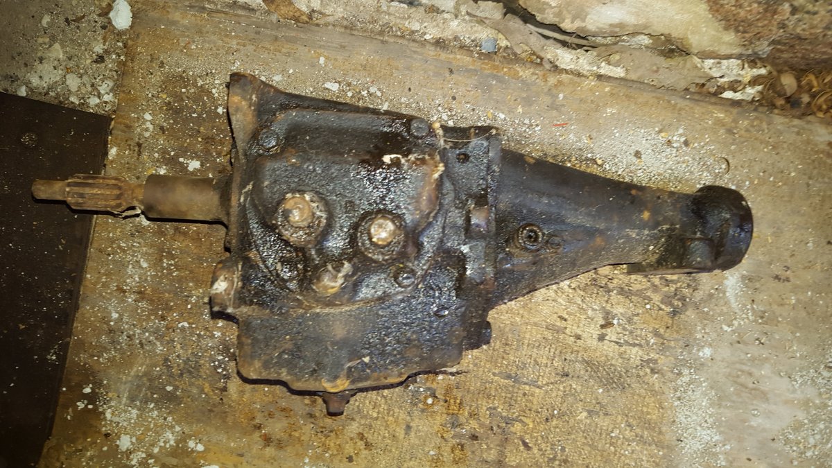

  5. 20160512_070605.jpg 20160512_070623.jpg 20160512_071021.jpg 20160512_070626.jpg 20160512_071008.jpg 20160512_070834.jpg here is some of the transmission stuff I have. Also what is the last transmission I think its a Brog Warner not sure.

    The BW 3 speed is actually kind of rare, and I'd use that before any of the Muncie 318 style transmissions; it's full synchro and a lot stronger. You can adapt levers/rods, but the Muncie 318 would be easiest to use the stock levers/rods. You could also find a Muncie 319 (just a 318 with a BW R-10 overdrive attached) and have an OD trans. Hnstray is right on the bellhousings to use.

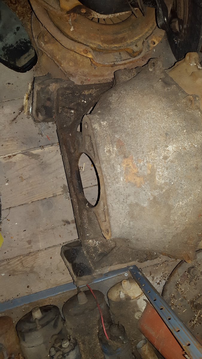

  7. Okay thanks @56sedandelivery I was hoping you would chime in most of the stuff I found was you on other forms. I think that bell housing I pictured is a 265. How much different is the 6 cylinder to a 8 cylinder?

    The "265", V-8 bellhousing won't work with a 216-235-261 Chevrolet or early GMC 248-270-302 six cylinder engines; it/they will fit the later 194-215-230-250-292 Chevrolet sixes, and even the Pontiac OHC sixes. But, as long as you get the right year SIX cylinder truck or passenger car bellhousing, like Hnstray mentioned, those transmissions will bolt to to them.

    I think that bottom pic of the Borg Warner gearbox is a T-10 4 speed, not a T-85 3 speed. The T-10 was a further development of the T-85 and the main cases/side covers look alike.
    However, look closely at the tail housing. I think I see the shift shaft for reverse in that caked mud/grease.

    I think I see it also. and what looks like the rectangle that the arm fits onto?

    I see it now also; darned glasses! T-10 4 speed; if it's any good use that with a floor shi9fter. I am Butch/56sedandelivery
