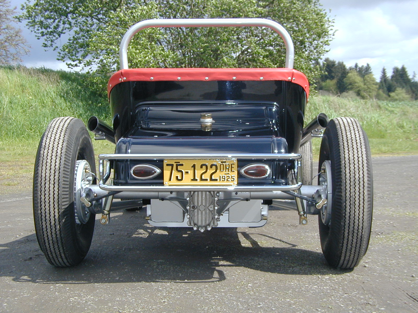

    I installed a set in this roadster with a "Red Ram" Dodge engine when it was just built, it has 19,000 mi on it without any problems. Since new, you hear a click at times when letting the clutch out at the start, I thought about shimming the change gears a little tighter, but left it alone. Since the car is light (2,000 lbs) and the skinny rear tires spin easily, we haven't worried about "blowing the rear cover" off.
