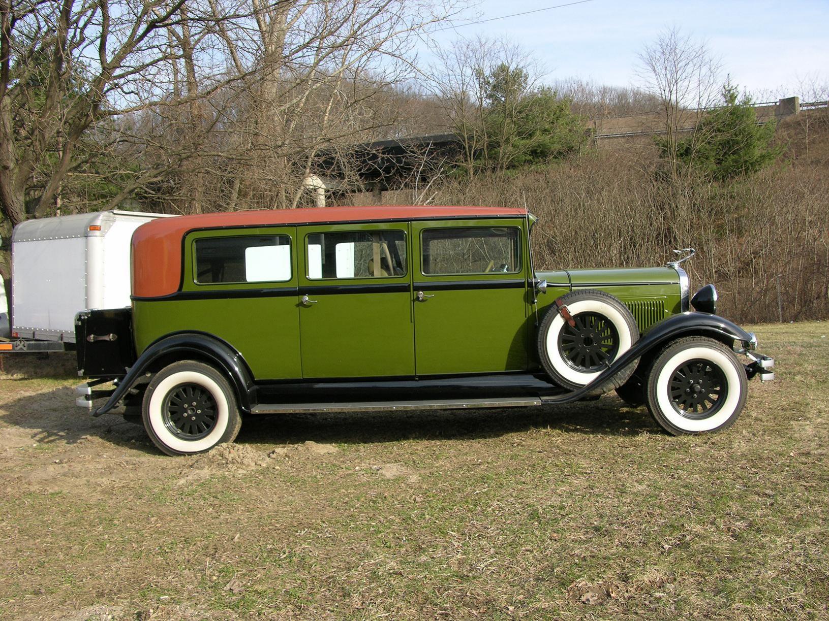

    I think It's perfect, the stock pieces make the car to me, headlights,bumpers,trunk rack.

    The car looked so good before, I would have been afraid to ruin that, but it looks like you are doing a great job. If the re power makes it more useful to your family, then you have a done a good thing the keep the heirloom relevant instead of collecting dust.

    The chop is perfect. It's really cool that the car has a documented family history.

    I really like the overall look, the chop is just right. Getting the perfect rear tire to fender look is the next step IMO. Thanks for posting the build photos. Bob

    I was nervous about the chop but it is just right and preserves the balance. So may chops are overdone and look cartoony.
    Just a note here: two Ps in Hupp and one in Hupmobile. Robert Craig Hupp was the founder of the company which he started in 1908 after working for Henry Ford....

  15. I was kind of skeptical of the build also when you said chop because long four doors are easily overdone. But you got that chop spot on. Looks a lot better than original, maybe even more classy. Good job.
