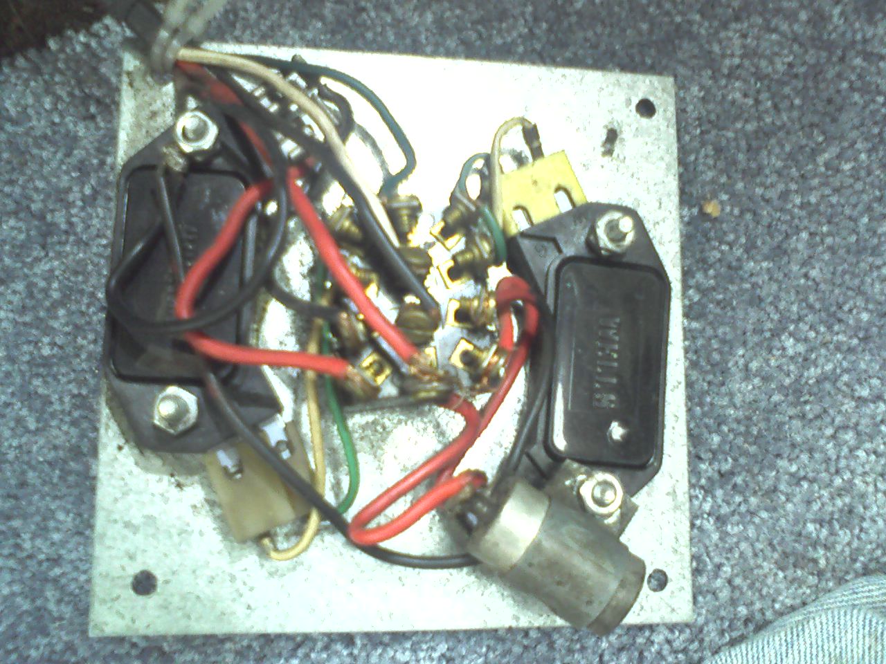

  11. I had a few HEI failures over the years, even tho I did everything by the book.
    I got tired of digging them out and putting them back in the distributor while under the hood in somebody's parking lot.
    I moved my control module to the car passenger compartment under the dash so I could replace it easily.
    MAGIC! In the cooler location I haven't had a single failure in over 12 years!
    Here is a picture of my HEI rig in my Studebaker truck- with Radio Shack switch so in the event of a module failure, I could simply flip a switch and keep on driving.
    The great thing is that I haven't had a single failure in over a dozen years, and do not need the spare module.
  12. Now that is "dare-to-be-different"
    You don't have any noise problems?
