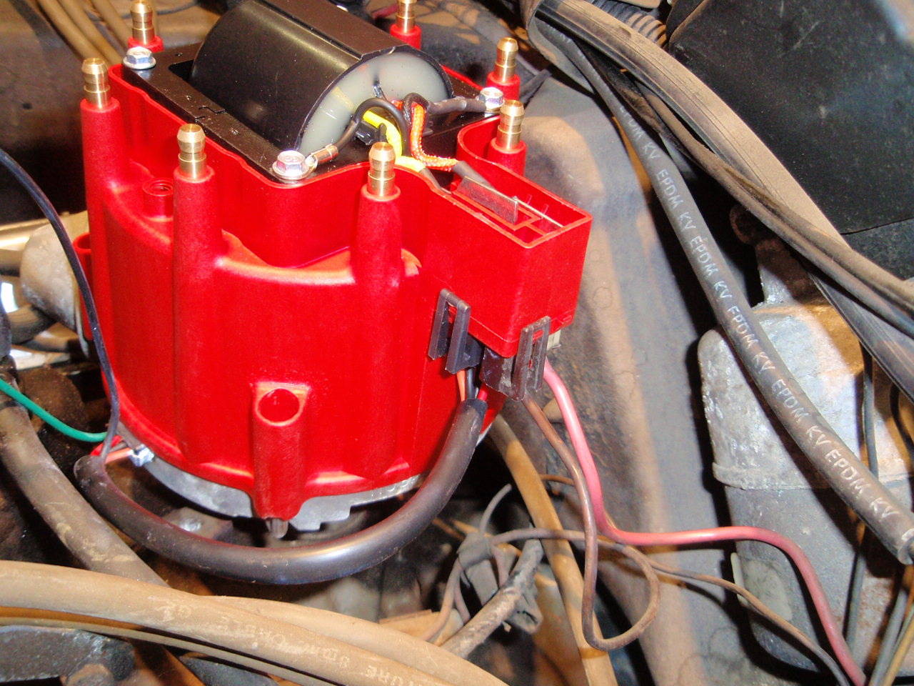

    Hi everyone, i just got an HEI distributor & it makes no sence to me, am i suppose to cut and splice a wire thats on it? other than that there seems to be no way i can get it wired to the battery or ignition switch, i know some of u guys have done this before, i'm putting it on a 350 chevy so any help is greatly appreciated.

    Well, I don't have any freaking "dizzy's" (who's the idiot that came up with that cutsie name?) but I've installed a number of HEI distributors. All you need is an 8 or 10 gage wire from the ign post on the switch to the connector on the cap where you connect to the coil. It should say battery while the one beside it says tach. No resistor or what not. You can either remove the old wiring or fold it back on it's self and tape it if appearance isn't an issue.

  5. No those go on the cap closest to it then the rear one on the outside near the one you just put on is the power and the front one ahead it is the tach. DO NOT CUT ANY WIRES ON THE THREE THAT COME OUT OF THE DISTRIBUTOR, REMEMBER GOOGLE IS YOUR FRIEND...WHEN IN DOUBT GOOGLE IT!

  7. No need to remove the top(coil cover) see pic, i do not know why they have it off but you don't need to remove it.

    If you remove the distributor cap from the distributor body and flip it over, or easier still, just use a mirror to look underneath, you'll see the connections on the underside of the square block that sticks out of the side of the cap. The 3 innermost take the 3 wired plug that returns into the distributor body and outside of those should be 2 more - one for tach and one for power - the one to the right when looking from above is the power terminal. Simple spade connector onto that and you're good. The cap is probably marked tach and bat from above. With no tach it's a one wire deal. Simple as that.

  10. sometimes is easier with an image

    You don't cut any of those. The connections are in front of them in the cap for the hot wire and the tach wire.
    Ricks diagram nailed it, that is what I get for assuming that the person asking the question has taken a serious look at the distributor and I didn't explain things thoroughly enough. Not Rick's diagram but the confusion on the wires on the distributor and how to connect them.

    I would suggest one minor change - many HEI caps have provision for small locking clips that have a spade connector inside. Keeps the wire from working loose (ask me how I know). There is a similar clip to hold the tach wire.

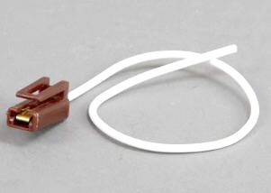

    This thread helps me a lot. It helped makes sense of the HEI
    distributor I got hooked up. My TACH slot remains empty now.
    So, all I need to, if I read you guys right, to connect a tach, is
    to solder a Hei_tach_pigtail at the end of the tach's green wire
    and just slide that connector onto the distributor protrusion,
    where I see the brown wire in Rodhotz's picture , is that right?
    By the way, is that the coil I see exposed in Rodhotz's picture
    with his distributor's cap off? No wonder I couldn't find mine.

    Yes, the black circular object is the coil. It is held with 4 self threading screws. Make sure the screws are tight & the ground wire is secure & tightly held with one of those screws.
