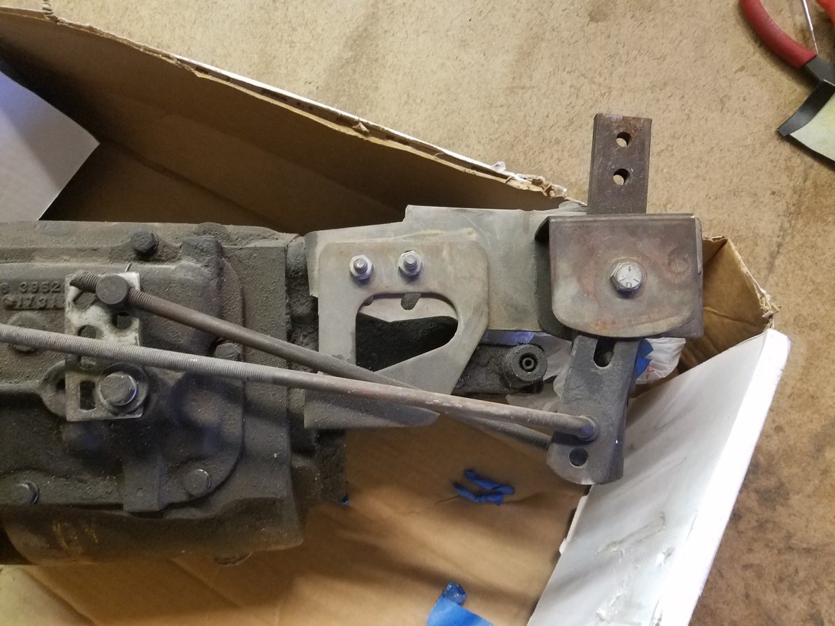

    Need help in understanding what I have. Transmission came out of a 1972 Pontiac LeMans 455. I've been told it is a 3 spd Muncie, has synchronized 1 gear, 3.09 1rst, 1.75 2nd and 1.0 final.
    I've been looking up info on this and haven't figured out the correct search words on the general web to use for finding tech info.
    I have a Hurst synchro-loc dual pattern shifter. Looking for the correct plate to mount this shifter on the transmission. Is there anyone out there who can help me with a part number?
    It will be going behind my fresh built 401 Nailhead in a Model A.
    Pics of the transmission numbers and shifter attached.
    Thanks.

    Here's some info on your shifter... doesn't show any mounts...also included a picture from a early shop manual ... Hurst linkage but the picture is of just a generic 3 SPD trans....[​IMG][​IMG]

    Why not just use the current mounting plate; you may have to re-drill it to fit the Synchro-Loc? There is a Hurst mount that bolts to the underside of the extension housing using the trans mounts bosses, and a large U-joint at the end of the extension housing. There's always one or two on that auction site we all know and love.

    Thanks for the nomeclature.
    If I can't find the mounting plate, I can make this one work, I was hoping to find a Hurst piece specific to my setup.
    Anyone know about the transmission? I had no idea there was an Iron case 3 speed Muncie for heavy duty applications. Seems like everyone was swapping out for the 4 speed and every search I had talks about the Dearborn 3 speed and the weaker Saginaw.
    I went this route because it was recommended with the 401 power curve and low RPM. Seems like 4 speeds on Nailheads are kind of a waste due to the torque not needing second gear. Since this came behind a 455 Pontiac, I figured it could hold up to my Nailhead.

    Had to dig a bit to figure out where this catalog was stashed but here's some install kits that might work. Your transmission code is 351 and only shifter option shown is a Mastershift which looks similar to the Syncro/Loc.

    That's just how Hurst identifies it in their chart, actually a Muncie SM-330? Think column shifted versions come with a smooth tail housing and require a different shifter kit too.

    Would help if we could see the tail shaft housing...does it have any thread holes in it like the picture of the 351...if it has any of the three bolt pattern combinations and if your hole in the tunnel has to be in a certain place than I believe any of the mounting plates would work....this one in the picture is a four speed but I believe the three SPD. has the same bolt pattern size[​IMG]

    Yes, It's a Heavy Duty Muncie 330 transmission; came in trucks and big block/high HP small blocks. A lot of guys get "confused" thinking they're a Saginaw, but NO WAY; a LOT stronger; they also look like more of a "box" the extension housing is bolted to (sort of the give-a-way, that and the different from Saginaw, 7 bolt side cover). The Hurst catalog shows it as a 351 kit. Can't see your extension housing (hid behind the Mickie Mouse plate); if it has bosses,l then it came in a floor shift car, no bosses, it was in a column shift car or truck. Hurst should be able to supply something; if not, you have enough parts to make it work with the other shifter's hardware. I am Butch/56sedandelivery.

    This Muncie 330 3 speed, when ordered with a floor shifter, had the mounting bosses on the extension housing; if it was a column shifter, like in a truck, then there were't any bosses for a shifter on the extension housing. I wonder how many SS 396 Chevelles got ordered with the 396 and a column shifted 3 speed? I am Butch/56sedandelivery.

    Update, I couldn't use this due to not being able to find a tail shaft that had a mount like 4 speeds had. Not sure how this was originally mounted in the car it came out of, however I sourced a Heavy Duty Borg Warner T-16 3 speed which was used behind 421 Pontiacs. It has a synchronized 1rst gear, Ratios are 2.86 1rst, 1.72 2nd and 1.00 final.
    Here it is in the chassis.
