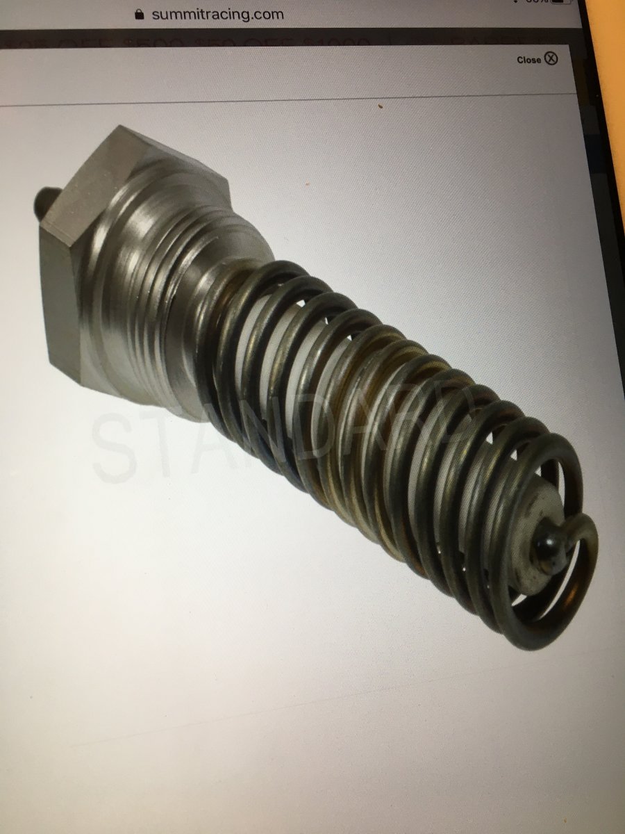

    I've read a pile of older threads here about the need to bring some type of heat (exhaust heat/hot water from the cooling system) to the aftermarket intake manifold of an inline engine. I understand the concept (maybe) but in doing some web searching I see that there may now be an electrical device to do this. I'm looking for input or discussion about how to use such a part. See pic.

    The purpose of a heated intake is really not so much about the intake. More so about the carb throttle plate area. In cold damp weather as the air fuel rushes past the throttle plates it can ice up and in general cause poor driveability. (I've never seen a throttle ice up and stick opened or closed). If your only driving your hot rod in warmer weather, you likely won't need to worry. As far as that electrical heater. IMO, I would HIGHLY recommend against that. First off is electrical heaters use quite a bit of electricity. Second and possibly of bigger consequence...is will that element turn red hot in an intake filled will air/fuel mixture? Kaboom!. Diesel engine use an electrical heater to help warm the air, but diesel fuel/air mixture tends to be far less explosive when it's not being compressed.

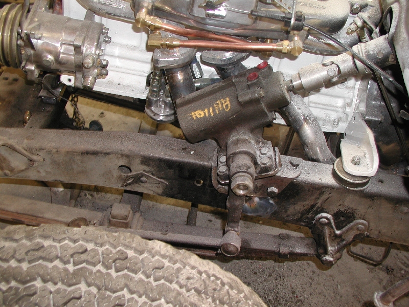

  11. I've had two in-lines. The 235 used a Clifford intake and Fenton cast iron headers. I hooked copper exhaust heat tubes where they appeared were designed to go.

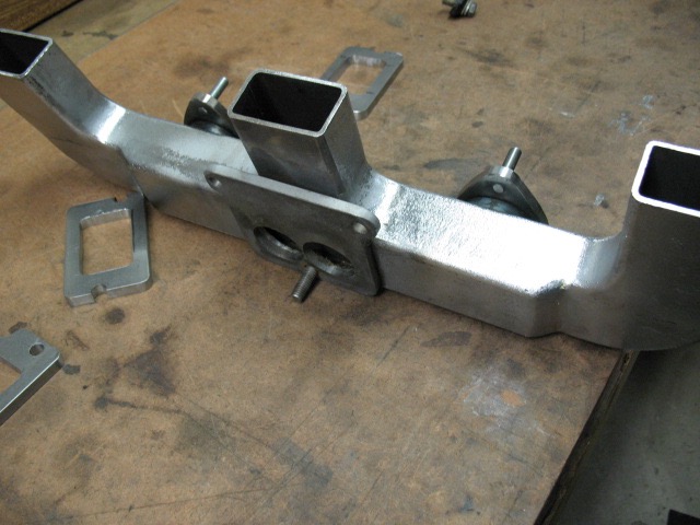

    The second was a 230 for which I cast an aluminum, divided, equal length runner aluminum manifold. I designed in a chamber on the bottom under the carb plenum that was heated by water inside a bolt on 1/4" plate.

    No offense but it would take an idiot to place a heater element into the air/fuel chambers of the intake.
