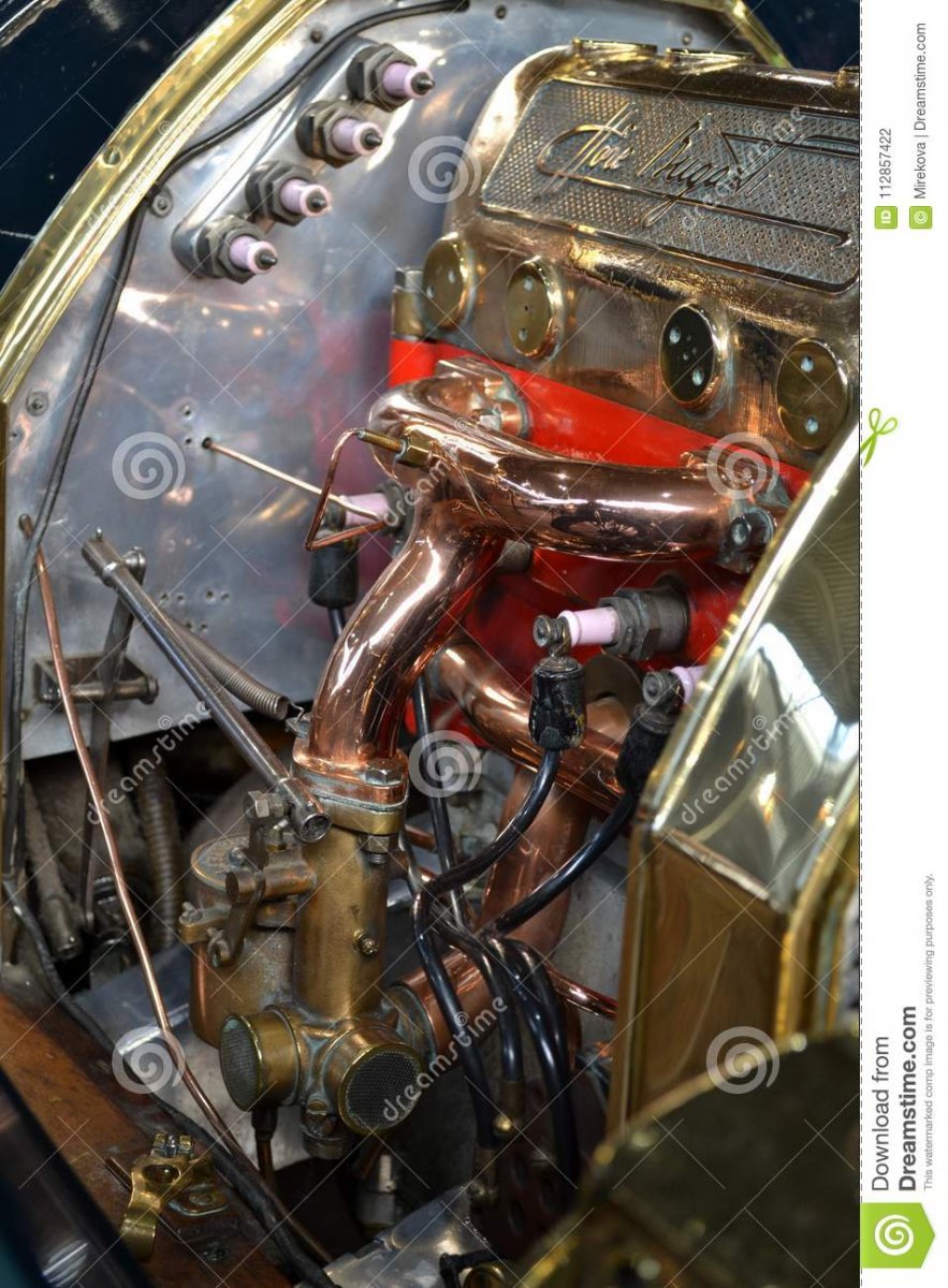

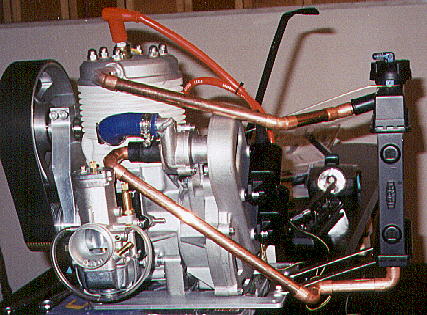

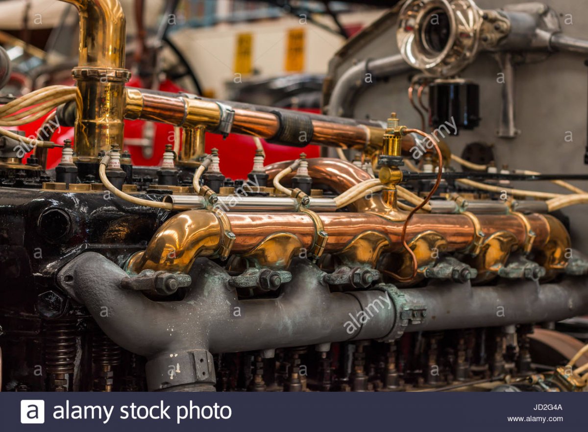

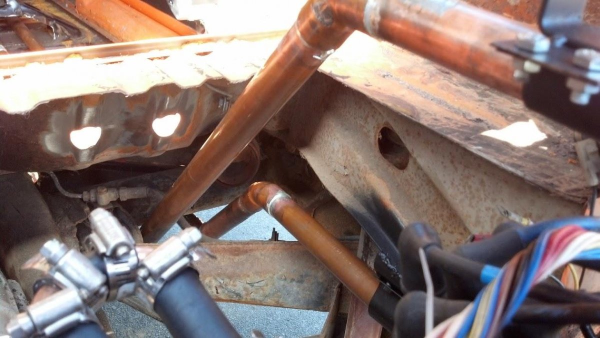

  11. The heater core nipples are copper and the radiator nipples are copper on an original.
