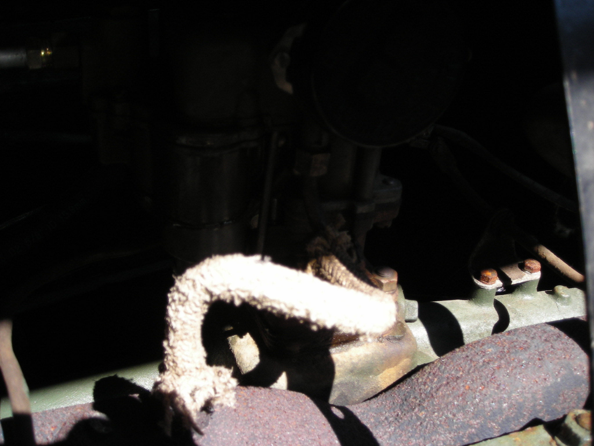

    The heat choke tube on my Packard goes tot he exhaust manifold, up close the motor.
