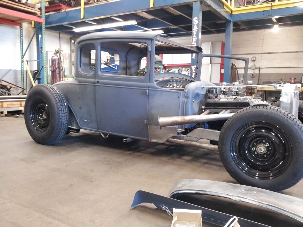

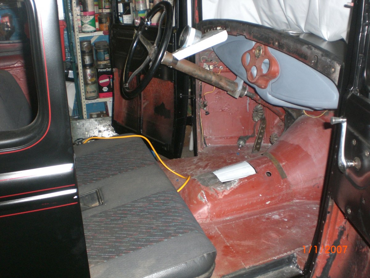

    Building a 31 model A coupe already channeled 4" and subfloor built now time to chop.
    I would like to chop it between 3"-4". At 3" I would have 2" of headroom. If I go to 3-1/2" then 1-1/2" of headroom. I am 5'-8" and building a bench seat, I realize I can install buckets if I have to pick up some room. My question is: How much headroom do you really need is 1-1/2" or 2" enough. Not too worried about passengers as I usually roll alone.
    Any help is appreciated

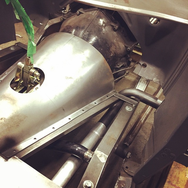

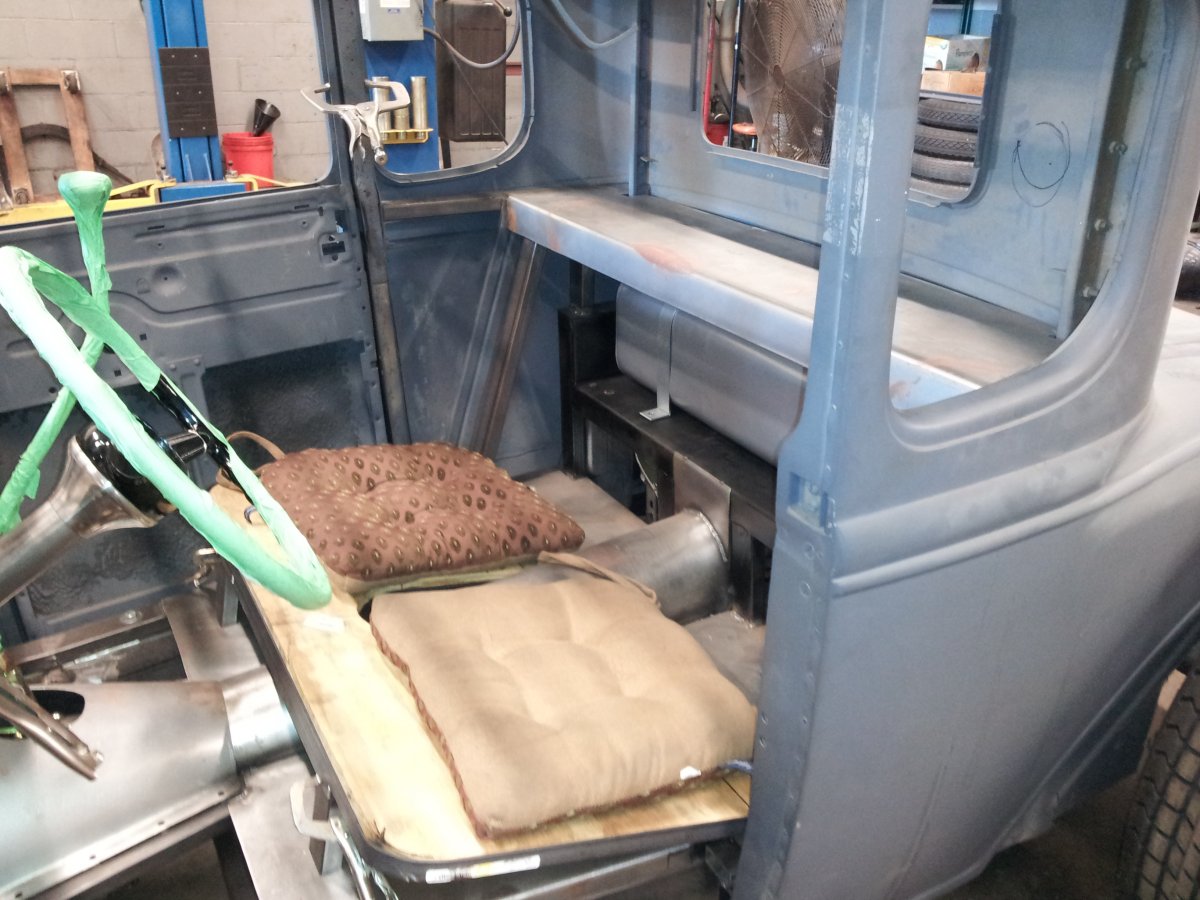

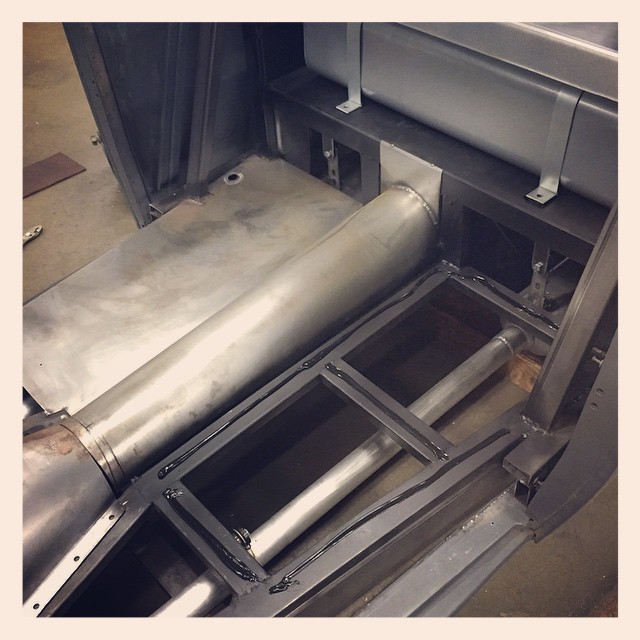

    It is looking great and will look better chopped. How about some more pictures of how you did the floor. Was the trans tunnel a kit or did you fabricate it? I am getting ready to do mine now.

    The floor and tunnel is fabed, still working it

    One other thing I have seen is to increase the angle on the seat back. lowers the head position, while still keeping some padding under your butt. Like it is said above, try and set up everything else before you cut it. I hope that exhaust pipe across the front of the firewall does not add too much heat to the floor.

    Thanks, Going to wrap the exhaust under the car and double wall the floor panels up front.

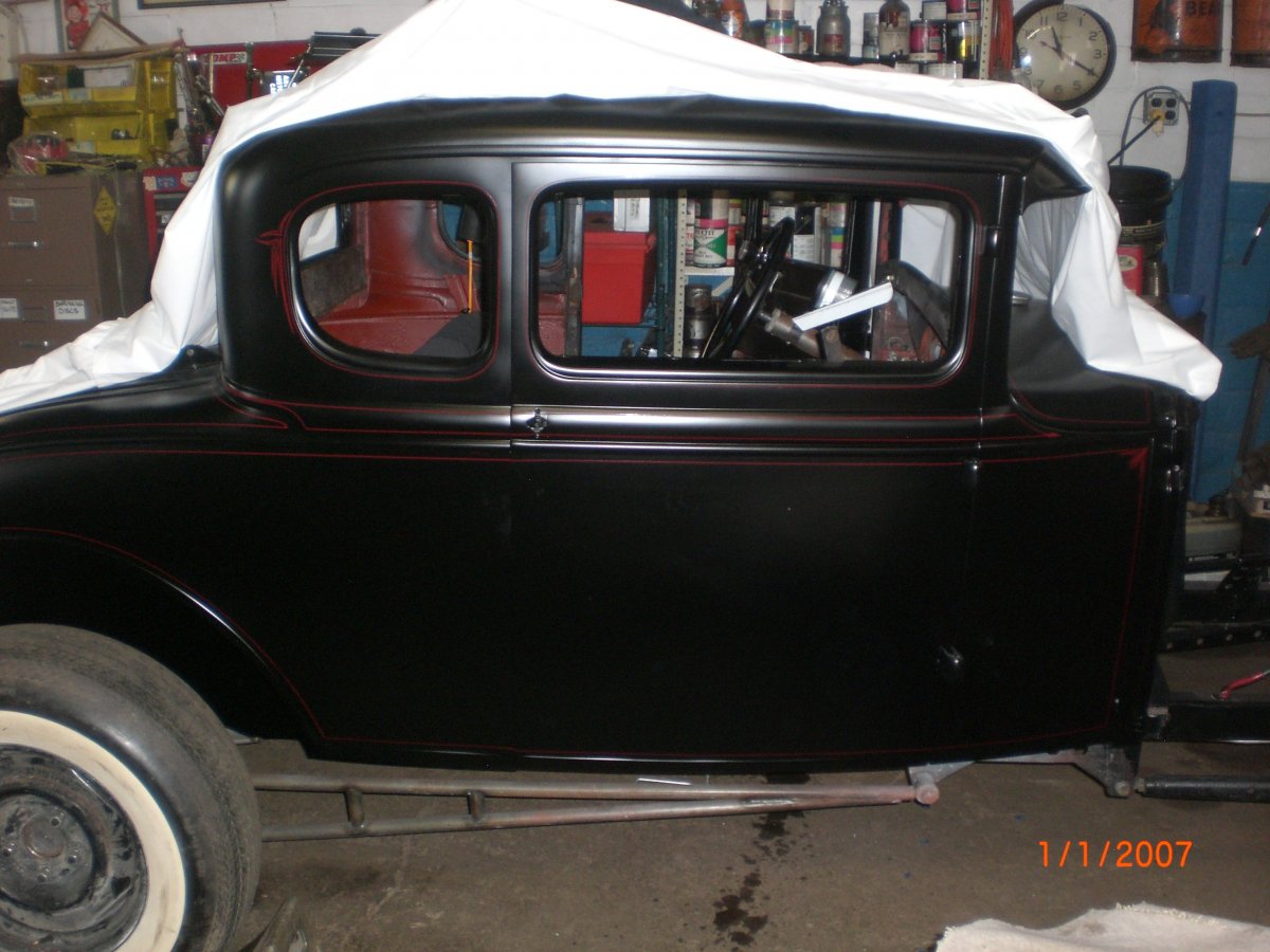

    my 30 coupe is chopped 3" and channeled 3". the floor is even with the top of the frame rails. seat is bench with 3 1/2 " risers and the seat padding is a bit thin. I am 5'6" and my head just barely touches the headliner. If you are the first guy at the light, you are leaning over to see it. it has a C4 trans, I doubt there would be room to work a clutch. I have a bad back and a bad left knee, and I have to "back" into the car to get past the steering wheel.

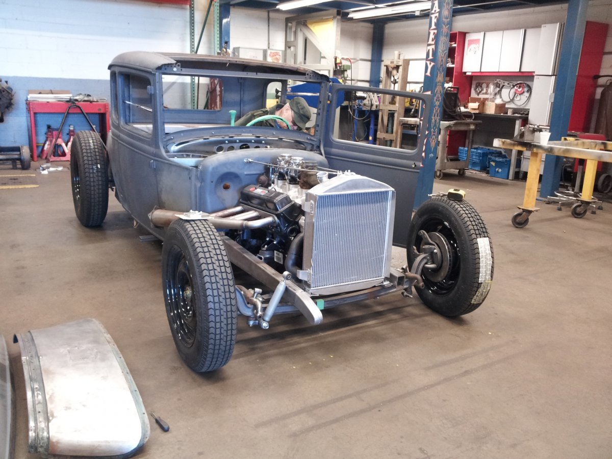

  20. Alaska Jim
    Joined: Dec 1, 2012
    Posts: 319
    Alaska Jim
    tried to post a picture, will try one more time
    Ed Angel and kidcampbell71 like this.

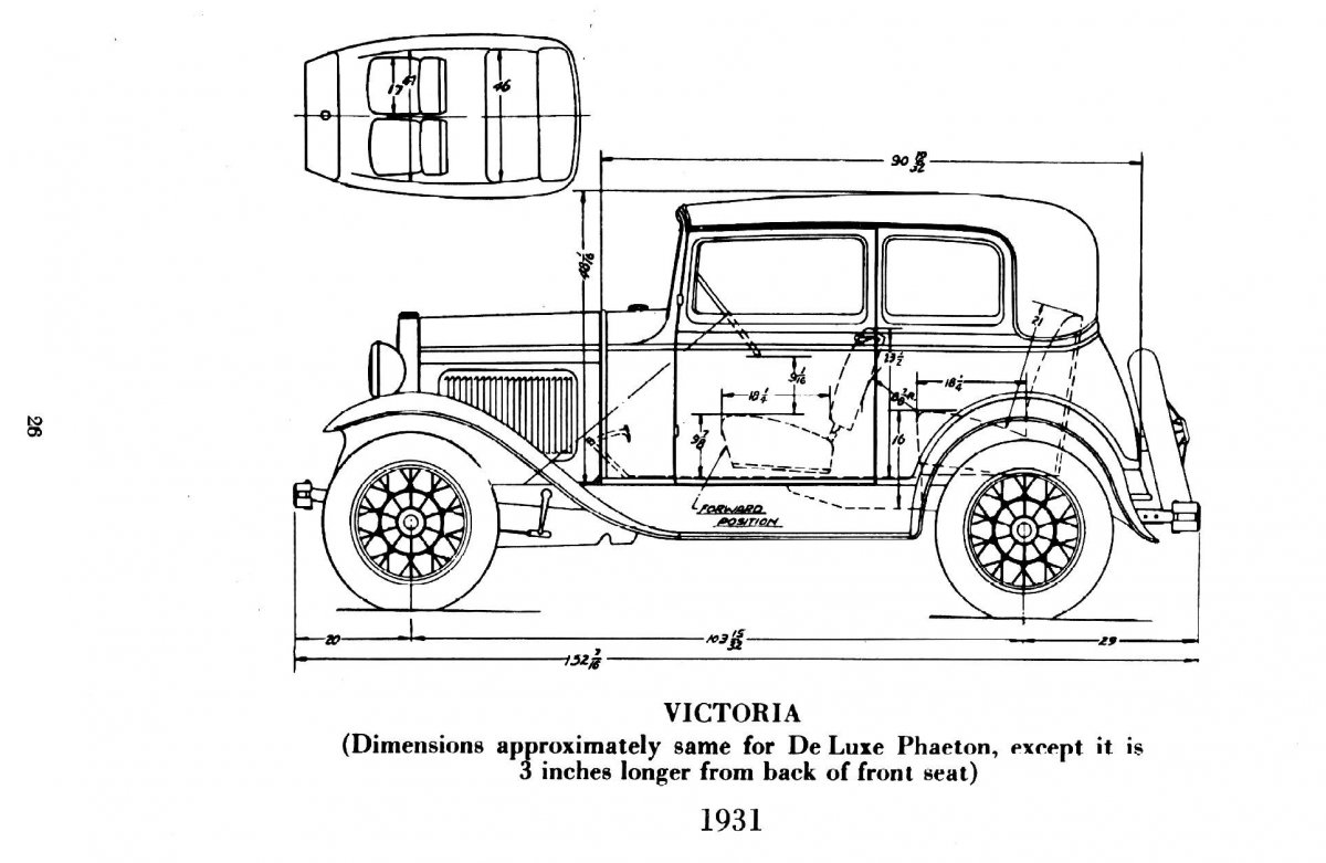

  27. Form follows function.
    That means that the function is primary and the form or look is secondary. It's easy get something that looks cool but just doesn't work.
    Chopping and channeling get the look (form) & it's a lot of work towards the form.
    Dropping the floor pan below the top of the rail make that look or form functional.
    Running 1" tube on top of the frame for a floor structure is easy and looks good (form) but that raises the floor and takes another inch of head room and vision which goes against the function.
    If you measure from the top of that type of floor to the bottom of the rail there's at least 5" of space. Lowering the seats into that space is also a lot of work, but it's work towards the function of your modification to the form.
    My model A Vicky has 9-1/2" (5" shorter than a coupe) side windows and measures 44"
    from floor to roof skin.

    Makes good sense, thinking I have to drop the floor pan to lower my seat height 2-2-1/2"

    Jim, That car looks familiar was it ever in New York?

    could you recess where the seat would go instead of the whole floor?
