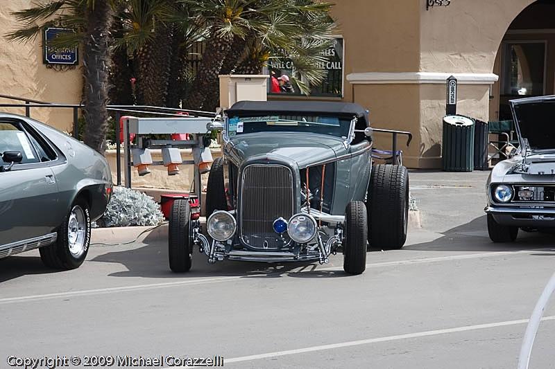

  2. How about this?

    Yes a little bigger headlight would fit nicer .But Id loose the fenders .That would look even nicer ..:D

    I'd vote for larger lights, too. There are plenty of Guide 682-C's out there in various states of condition (which I think would be nice on your ride). You see them here & a lot on EvilBay. They do repop the things, but they're a bit pricey.

    I'n the '60's Hotrods ran King Bee's or Deitz headlights.
    Guide lights would be a hold over from the 50's, but you saw them too.
    The big pre-sealed beam lights became the thing to have in the late '60's but mainly on "Resto-Rods", not "hotrods."
    Also, you didn't see headlights as low as Da34guy's lights on the streets in states that still had 25" minimum headlight height laws because it was an easy ticket to write.

    The aluminum headlamp stands were introduced by early makers like Cyclone in varying styles, smooth and ribbed...hmmmmmmm, in the 50s, a hot rod staple since then for open wheel cars.
    KingBee, Deitz, Arrow...all are period correct for the 1960s era, before and after.
    The Guides and B-L-Cs before that and even more now.
    Look for Ford headlights from 1940-47 COE or 3/4-1 ton trucks, larger in appearance than the "little lights" but still use 7" sealed beams too and the mount bolt is hollow for wiring entry.
    Like the fenders up front but how about some carriage bolts , button heads, or anything but hex head sheet metal screws to hold them to the brackets?
    Rears are fine too but need some inside offset wheels to get the rubber under the fenders. The forward ends might be tapered and beaded for a little style, maybe the rear too, can't see in your pic.
