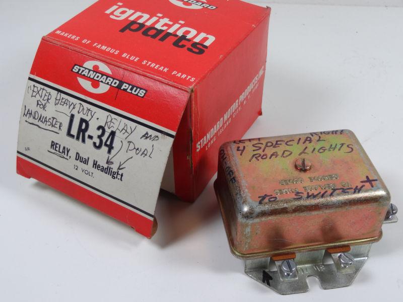

  19. I used old Standard Ignition LR 34 on my cars. Just don't tighten the cover screw too much, it will pull up on the point block.

    Do you have a part number?

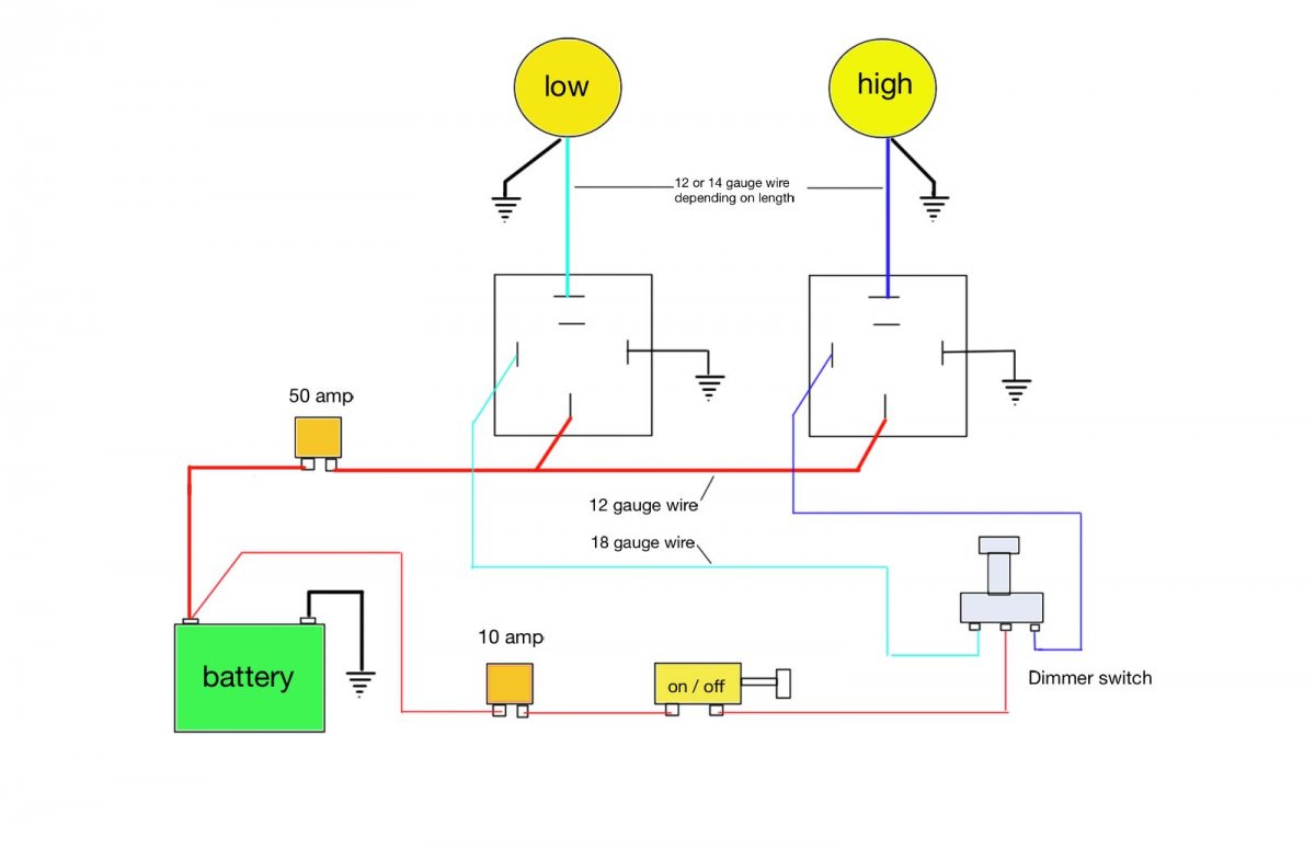

    EDIT: See the post below this post - The wiring diagram summarizes the above discussions - One criticism - The 50 Amp fuse is to big for 20 Gauge wire - A 20 Amp fuse (25 Amp maximum) for this wire gauge.

    For relays to be effect, the power source must come right off battery and be a heavy wire. The longer the wires, the heavier they need to be. The dimmer switch turns relays on and off suppling the head lights with direct from battery power. Headlamps should also have a dedicated ground wire to battery or frame, not sheet metal. Headlight relays.jpg

    lake_harley
    ^^^^That wiring diagram and plan make a lot more sense to me.

    A 50 Amp fuse is too big for 12 Gauge wire - a 20 Amp fuse is better - maybe 25 Amps maximum.

    Wrench97
    A 6014 bulb draws 3.5 amp why would you possibley use a 50 amp fuse or 12ga wire?
    Factory setups use 10 amp fuses for headlights
    Why use 2 relays when the 5 prong relay was designed to be a hi/low beam relay in the first place?
    There is not a lot of draw on these circuits the most common issues are poor connections and old headlight switches with poor internal connections.
    I believe the original op just wants to move the dimmer switch up to the dash and use the blue internally illuminated switch, unfortunately the switch does not have the amp capacity for the the circuit without using a relay as a buffer.
