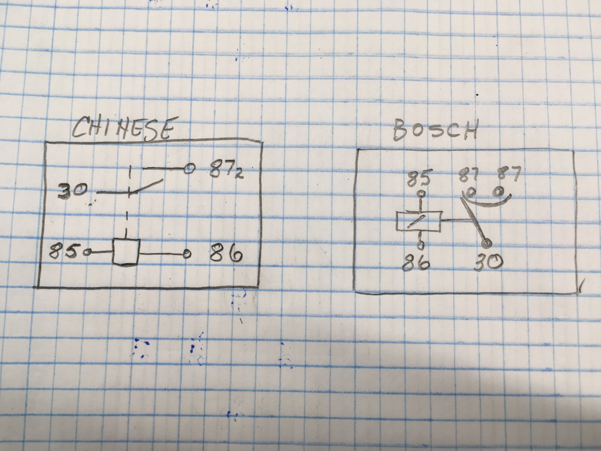

    Well, I received my 2 Bosch relays yesterday. Replaced the 2 Chinese relays with the 2 new Bosch. Turn on the lights. Nothing happens! DAMMIT! Start checking. Find nothing wrong, but no lights. Swap the Chinese relays back in. Lights! What the hell? IMG_0596.JPG This is how the relays are wired. I simply copied the Chinese harness using real 10 ga wire. I could not find a diagram on the net that was wired the same, but it works with the original relays. The system will work with both Chinese relays. It also works with a Chinese relay in position A and a Bosch in position B.
    There are 16 possible combinations. It being a nasty rainy day I tried them all. It boils down to this:
    C= Chinese relay, B= Bosch relay, Position A and B per diagram
    Position A, Position B
    C, C Both Lights
    C, B Both Lights
    B, C Low beam only
    B, B NO LIGHTS
    (I can't make this space out like I wanted)
    It appears that the new Bosch relays don't have the 30 and 87A connected internally so no power goes to the second relay.
    I have always wired my own cars, so I am not a complete noob, but never had to mess with relays. so I could easily be wrong here. There are 2 possibilities here.
    1. I have the wrong Bosch relays.
    2. Both Bosch relays are defective. (I hate to believe this due to there shining reviews.)
    If the Bosch relays are the wrong ones for this application, can someone give me a correct Bosch part number for this application? Or are they defective?
    I think I could power the second relay with a wire T'ed into the power wire from the starter after the maxi fuse, couldn't I? I would rather not do it this way, though. I would rather get the right relays.
    I did find numbers on the Chinese relays. JD 1914 12v/80A
    The new Bosch are 0 332 019 150
    Both sets of relays have a little diagram on them which I don't understand, but the diagrams are different. I don't really know what this means. Also the Bosch center pin is only marked 87 while the Chinese is marked 87A.
    I've learned a lot about relays while researching in the last few days, but probably just enough to make me dangerous. Can anybody shed some light on this for me? Thanks.

  9. jaw22w
    Joined: Mar 2, 2013
    Posts: 1,676
    jaw22w
    from Indiana
    I couldn't get a pic of the diagrams on the relays, so I drew them. Does this help?

    I see a couple of problems with this diagram.
    1. Does the Chinese relay have both a 87 and 87A pins?
    2. The Bosch pins should be labeled 87 and 87A
    Hold the Chinese and Bosch relays upside down and look at the pins. Are pins 30, 85, 86, 87 and 87A physically in the same location?
    With a multimeter, check the continuity between pins 85 and 86 (Testing for an open circuit in the relay coil)
    With a multimeter, check for continuity from pin 30 to both pins 87 and 87A (Verifying that the relay contacts are wired correctly)

    Thanks for that. The Chinese relay has a pin marked 87 and the center pin marked 87a. The Bosch has a pin marked 87 and the center pin marked 87 also. Both Chinese and Bosch look exactly identical except for the pin labels and the small diagram on each (2nd pic).
    Both Chinese and Bosch show continuity between 85 and 86.
    Chinese has continuity from 30 to 87a. Bosch does not.
    Chinese has no continuity between 87 and center pin 87a. Bosch has continuity between 87 and center pin 87.
    That confirms my theory that the Bosch does not connect 30 to the 87 center pin , but does not answer the question of defective or wrong application. Does Bosch make a relay that connects 30 to the 87 center pin?

    You are using the wrong Bosch relay. According to the part number you listed, you have a relay with dual 87 terminals and no 87a terminal. Thats why they won't work for Relay A in your wiring diagram.
    I think you can use those bosch relays if you connect the power wire (to Relay B) on Relay A from your labeled terminal 87a to the 30 terminal on Relay A, so that the 30 terminal on Relay A is jumped over to the 30 terminal on Relay B.
    The correct Bosch relay number would be 0 332 209 150.

    The Chinese relay switches power from pin 87A to pin 87 when energized.
    The Bosch relay "appears" (I am making an assumption here) to be designed as an ON-OFF only relay. If you apply power and ground to 86 and 86, you should have continuity from 30 to 87A.
    If so, the wiring diagram will need to be reworked.
    First, the HI and LOW beam relays get wired separately (eliminate the connection between 87A and 30)
    Both relays get 12 Volts battery power at 30.
    Each headlight gets connected to 87A (Assuming 87a gets power when the relay is energized)

    Thank you very much Hoptup32! I found the correct 0 332 209 150 relay on Amazon. Confirmed it is the 87A type, not the 87 type. 2 on the way. That will fix me right up.
