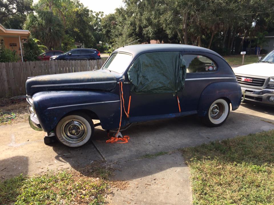

  1. She's get a heart transplant 350 to a fresher 283, and I'm tired of running VW bug size tires up front, so the fenderwell headers have to go... Since there isn't a lot of room with a Saginaw 525 steering box and under the floor master cylinder. How have you gotten the exhaust out of your SBC in a fat fender? Standard cheapo block huggers have to make a REALLY tight 90 turn to clear the steering box.
