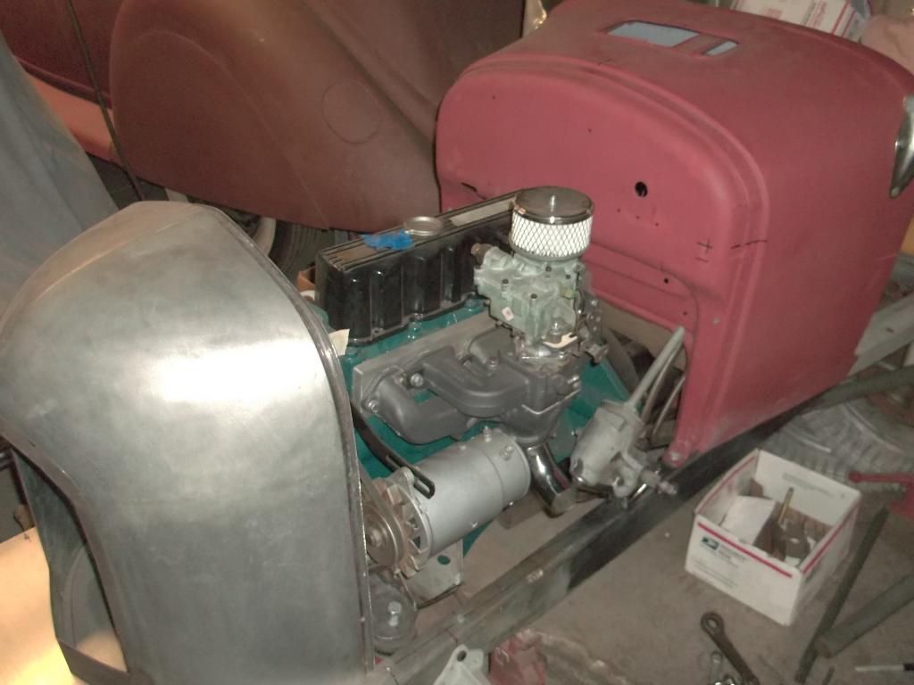

    My friend's old touring. Clifford intake and header flange and headers built to fit.

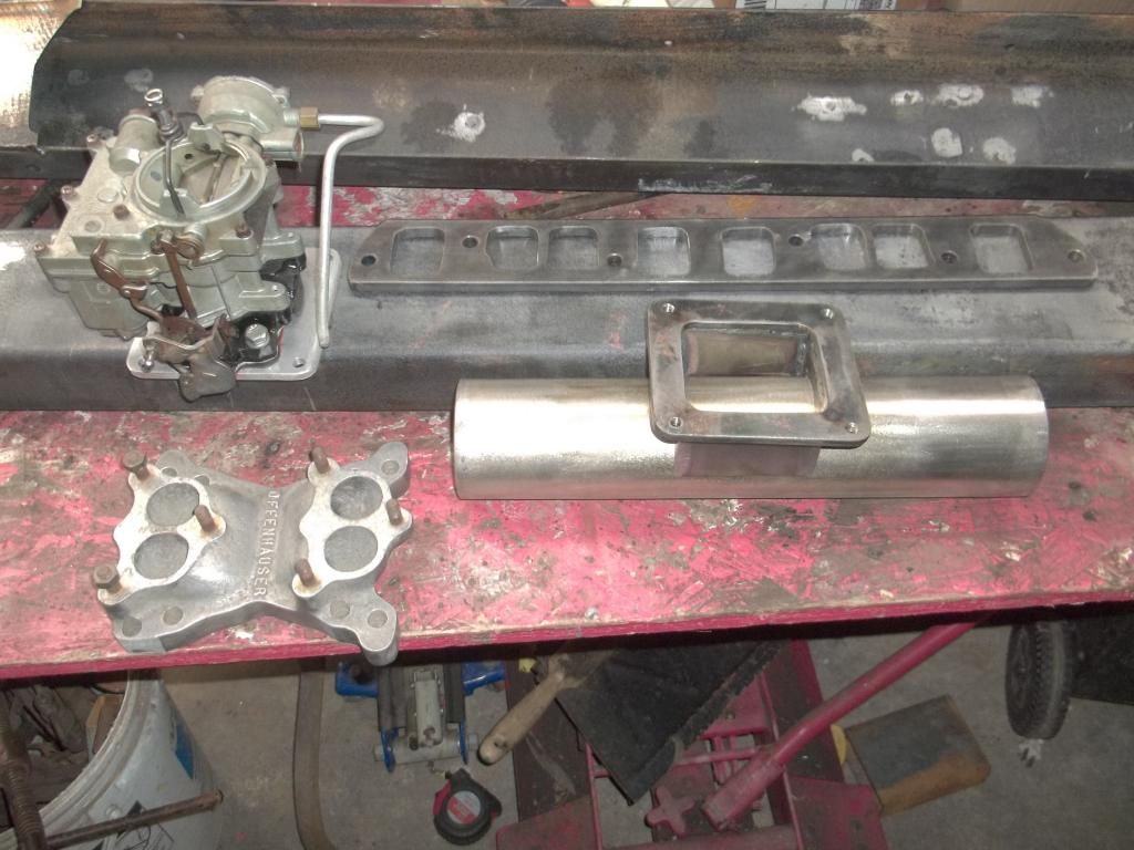

  9. I made a lakes style header for my old track roadster. Bought a flange from Hearders by Ed, a megaphone and a cheap pair of sbc circle track headers and cut one up and sold the other one. DSC00024.JPG

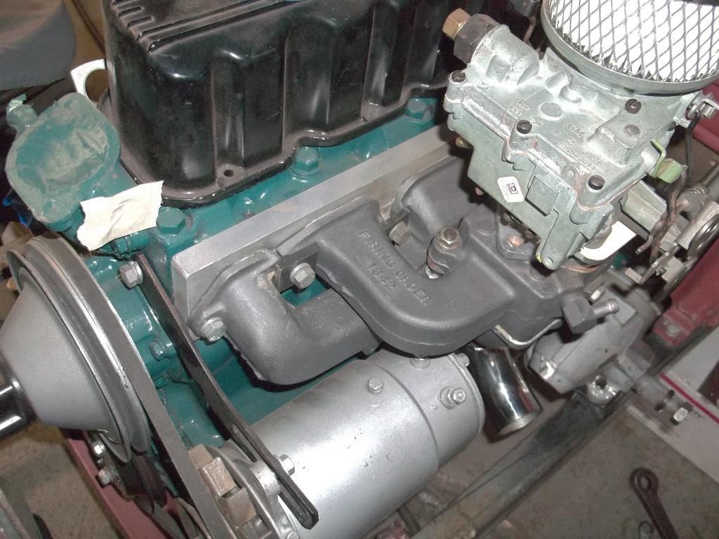

    Nostalgia, That looks like a fun project. I'd like to see more pictures of the adaptor and for sure the 2X2 Offey. Some day I want to build a duel Weber DCOE setup.
