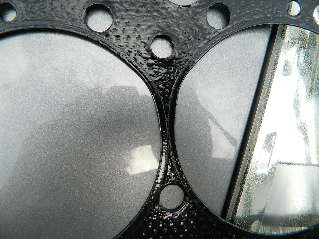

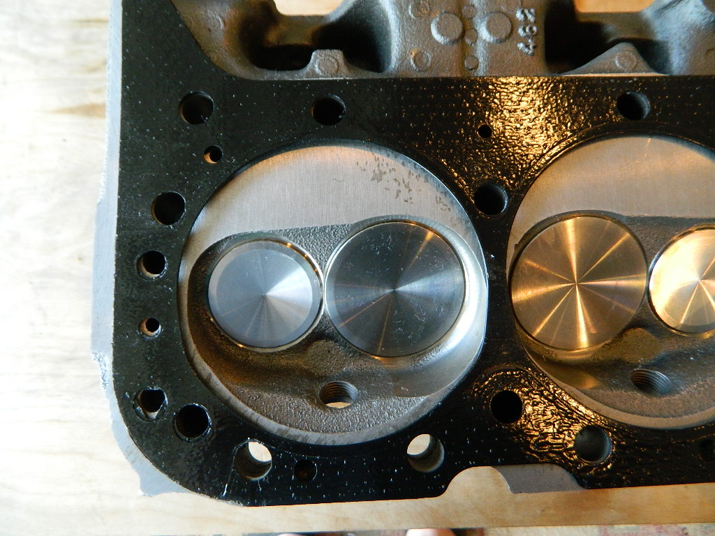

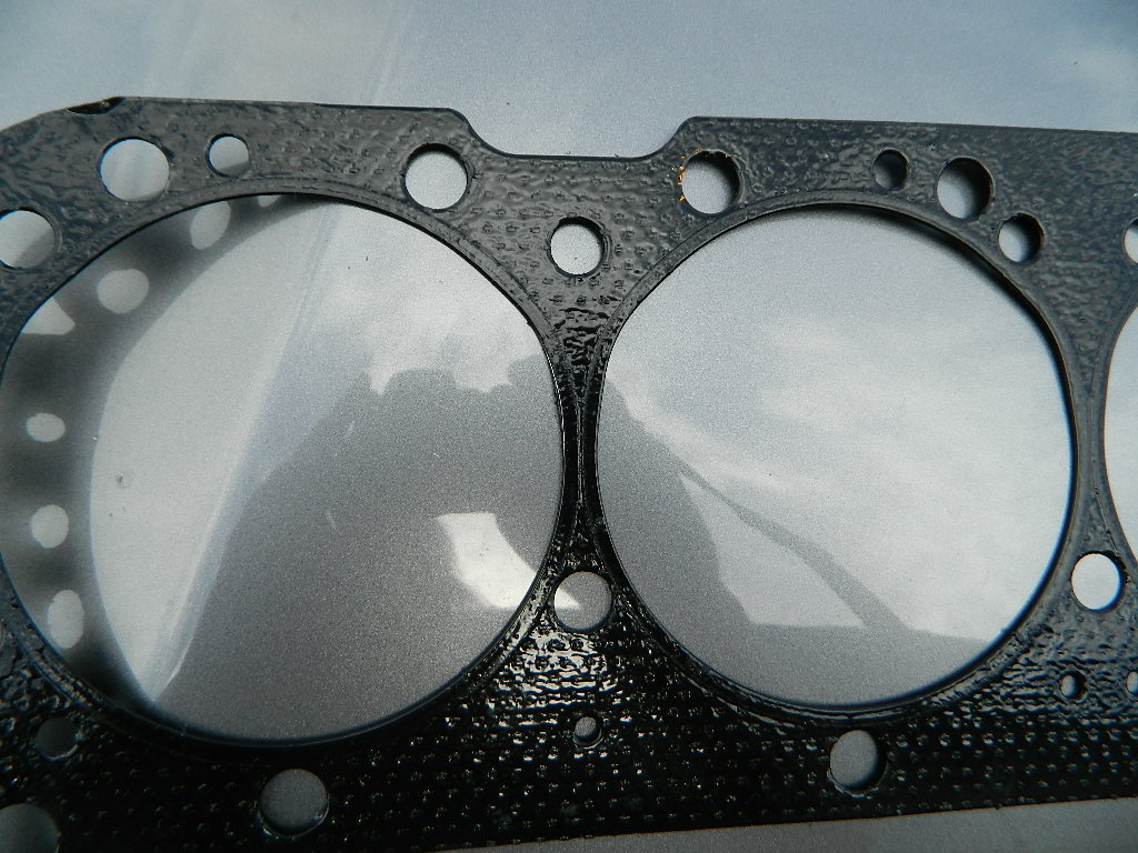

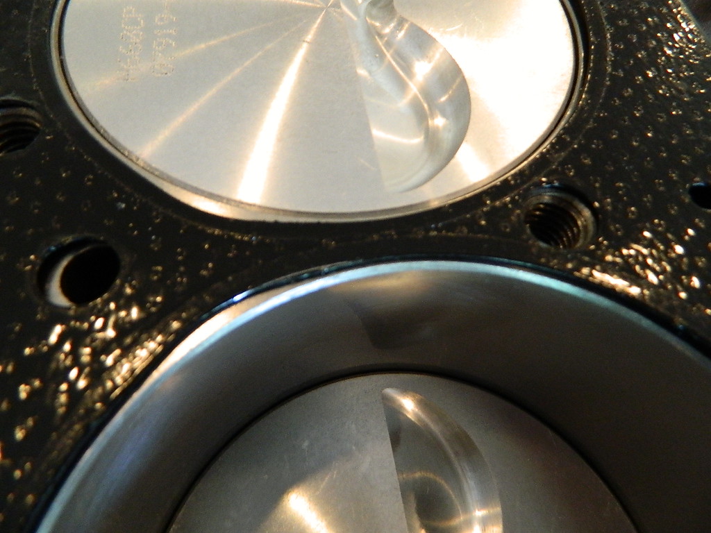

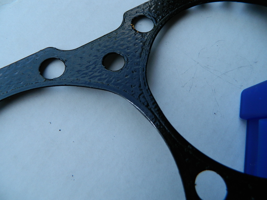

  1. I see the gasket edge is in the chamber. I scratch a line in the gasket material (rubber coating) shown as a silver line. And then lay the gasket back on the block. The bore is 4.030" the gasket is a GM 14096405. The combustion chambers have been modified. Do I modify it, or let the gods of hell fire modify it when I start it. What head gasket should I use?

    Well, you can't just cut or file the offending material away because the folded stainless armor edge isn't thick enough, you risk filing through it or making it too thin and weak to be durable.
    You choices are live with it, it will disrupt flow a small amount possibly but will otherwise be fine....or replace it with a gasket that has a larger bore opening.
    Somebody didn't check the gasket to head fit before modifying the head, or didn't check the gasket vs the head before deciding to put the engine together so they could get the correct gaskets.

    Not having pressure on the " fire ring" of the head gasket ,I would think ,would lead to early gasket failure ....JMO
  4. This gasket would have given me about 9.5 compression, I'm thinking of going to a solid gasket and see how it fits. Thinner at .015 compressed it will raise the c/r to about 10.1. 2old2fast is right you certainly can't trim the fire ring on a composite gasket but maybe it can be shaved if it's solid.

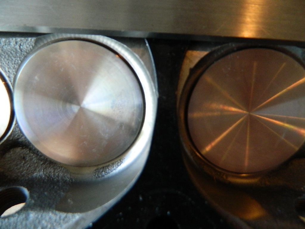

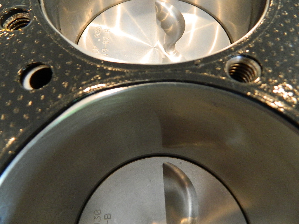

  6. This block has been decked and all the pistons and rings are in it. The depth of each piston in the hole varies from .007 to .017". The combustion chambers all measure within 3cc of 65cc. I'm waiting for the fel pro 7733sh1 gaskets.

    Mr48chev - The gasket fits the bore properly..!
    The O.P. stated the the chambers had been modified

    Mr Gasket Ultra-Seal #1134G - .028" thick x 4,130" bore based on thickness and needing a bigger bore than the 4.100" you've got, but I can't tell from the photos if .015" in bore size per side is going to be enough for your case.
    Personally, and if you are searching to maintain a tight quench, in this case with a flat block surface since it has been decked, I'd do two stacked .015-.016" shims with a mist of copper gasket spray between the sandwich. You can trim those easily with a Dremel. Same effect as a MLS gasket without the high price for having it riveted together
    The one 7733sh1 isn't going to be thick enough on the side that is only .007" down at TDC, that will put piston-to-head too close and you risk it hitting as rpm rises and everything flexes and stretches. It the rpm ever gets away from you like a missed shift or broken driveline part you really risk bouncing the piston off the head. The .017" side would be fine with just one gasket clearance wise but I don't know if I could convince myself not to do it the same as the other side.
    Closest I've ever been is .034" piston-to-head in a 7400 rpm 383 stroker with flat top pistons, cast crank and Eagle stock style rods, it would just polish the carbon off the quench section of the pistons, it was that close.

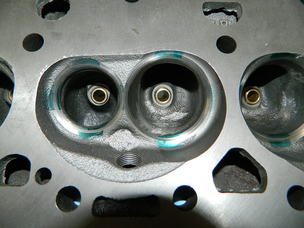

    His problem is because the chamber in the head has been modified, clearance cut around the intake valve area for flow improvement and that has made the chamber wider than it was stock. It is now wider than the bore of the gasket.

    Using block to score heads to create a limit line would have saved a lot on this issue.

    The only thing I don't like on your block is the .007" to .017" piston to deck height variation.

    I would call that a head problem, not a gasket problem. Valve relief that's outside the bore is useless regardless of whether the gasket seals or not. Don't mean to sound harsh, just my opinion.

  24. All true ^^^ this engine is being put together from a basket so to speak. A basket of parts I collected over the years and it's not working too well just yet. The heads I have given up on, they're both in plastic bags under one of my benches for the time being. I have another pair that are also vintage but were worked on by another shop and do not have the valves unshrouded. They are 291's also with big valves and they have been surfaced. I cc'd 2 chambers last night once I decided to use them and found them both to be 62cc's. I will check them all today and get them ready. And yes, the gaskets fit fine.
    The block finally measured 16, 14, 15 and 17 thousandths in the hole on one side and 07,10,13 and 17 on the other. Poor work by the machine operator to allow the taper to graduate from 7 to 17 tho' on one side. As much as I hate to say it I may live with this.
