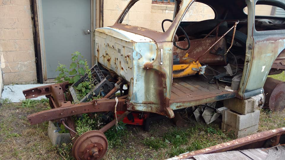

    not much there, he said that he wants to wait until it dries up a little to get his forklift out there.

  12. Lower body and floor looks pretty good after all those years.

    that's why i'm jumping on it...and it has a Ford frame
  14. looks like a decent body and frame. I would leave it up on the blocks, get everthing out from underneath and back the trailer from the rear. should get you more than 1/2 way loaded. hook up the winches and start pulling. bring some wheels and tire to make the chore a little easier. even if the front drums are locked up, adding a set of wheels and tires will give you a lot more ground clearance for dragging it up on the trailer.

    What crate engine is that? Doesn't look familiar to me.

    On that one chained or strapped (with 3000 lb straps) at the front and chained with Boomers or strapped with ratchet straps at the back and you should be good, A strap though the door openings might be insurance.
    Clean out any loose crap that might blow out that isn't part of the car before hitting the road. It isn't fun to roll up behind a guy towing a parts car and have trash blow out of it and bounce off your ride when you are behind him.

    Two Ford wheels and tires that hold air, and a trailer axle with wheels & tires and you have a roller. Attaching the trailer axle is your deal. :) Bob

    Looks like a super rare Hosereel Rotary to me :D
    That's a really nice parts car!

    Please, 2 come alongs not enough for that shell! He's not hauling from Cali to Maine! He probably doesn't have chain binders and large tarps laying around either, may have ratchet straps and come alongs, and they will be more than enough to handle that car. If its questionable throw a chain on the front and rear. Sheesh he isn't a professional trucker for heavens sake just a guy wanting to pick up a parts shell from what I can see.
