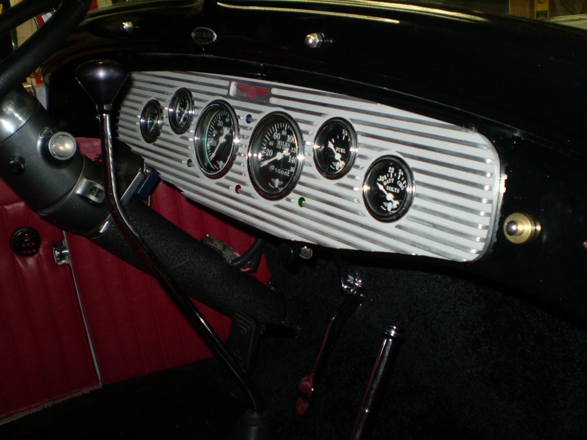

  10. new dash 001.jpg all pics 169.jpg Here's what I did. Wire ties and grouped the wires in three main groups and installed plug ins to make it easy to pull the dash if needed. The dash is from a 31 or 32 Studebaker modified to fit. new dash 001.jpg all pics 169.jpg

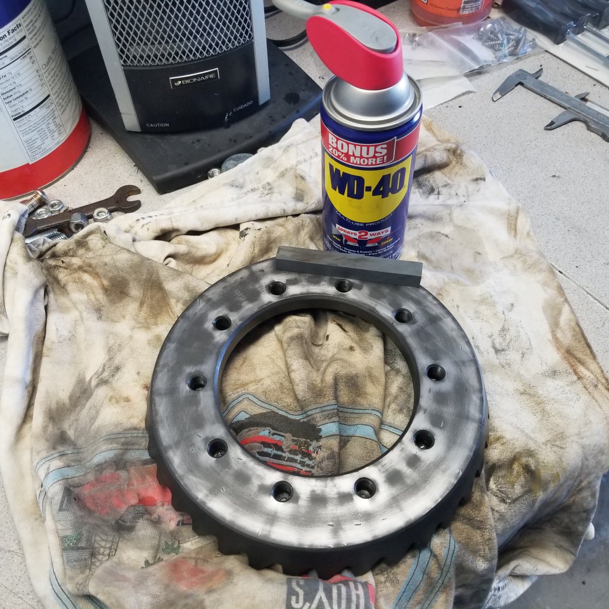

    I really wouldn't enjoy doing this without a press, but glad I don't have to.
    First step is take a carbide stone to the face of the ring gear and spool to make sure there's no nick, burrs, etc. Glad I did.....
    Pressed the bearings on the spool and mounted the ring gear.
    Checked runout and I don't think I can get much better than under .002".

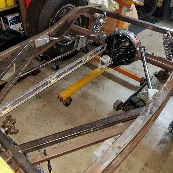

    End of the first real weekend of work. Diff is set up and installed, eng/trans is in position and 2 hours spent removing the rear brake drums the PO PRESSED on the axles. The oxy/acetylene set paid for itself today. I'll be going rear disc sooner than planned.
    This week will be fine tuning drive height/angle and cut/trim motor mount brackets and tack them in place.

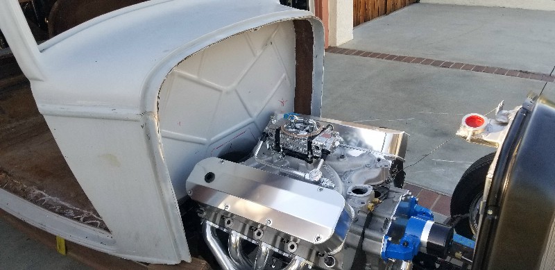

    Got the brackets tacked last night and put the motor down on the frame. The right level, but crank centerline is off 1/16". I'll do the finish welding tonight but I'm already starting to itch just thinking about cutting out the firewall......
  30. Mr T body
    Joined: Nov 2, 2005
    Posts: 2,153
    Mr T body
    Alliance Vendor
    from SoCal
    Done! Engine is on the frame and sits exactly where I want it. I'll tack the brackets to the frame and do the finish weld when the engine comes out again.
