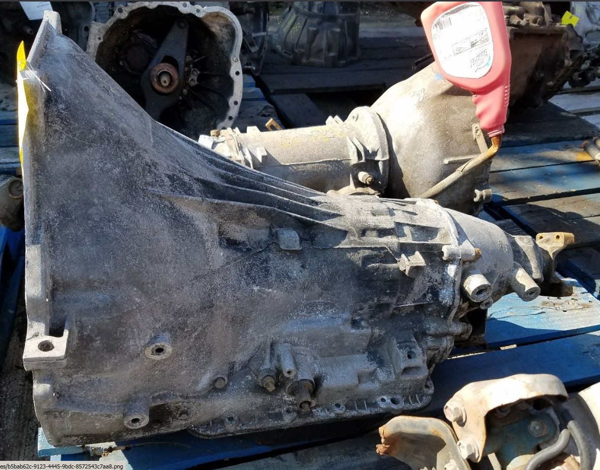

    If this trans looks vaguely familiar, it's the C6 equivalent of the short shaft C4 I put in the '31. It's SO much easier to get a good driveshaft angle, though this one will require a larger diameter splined driveshaft for the additional horsepower.

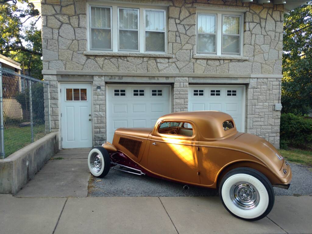

    906dc65a91f35e6b2bcc4fe82fc26198.jpg There's nothing wrong with glass. I wouldn't have the car I wanted if I had to pay for steel. It would have been at the very least a third more money. And I like it. And I don't have to fuss over it.
