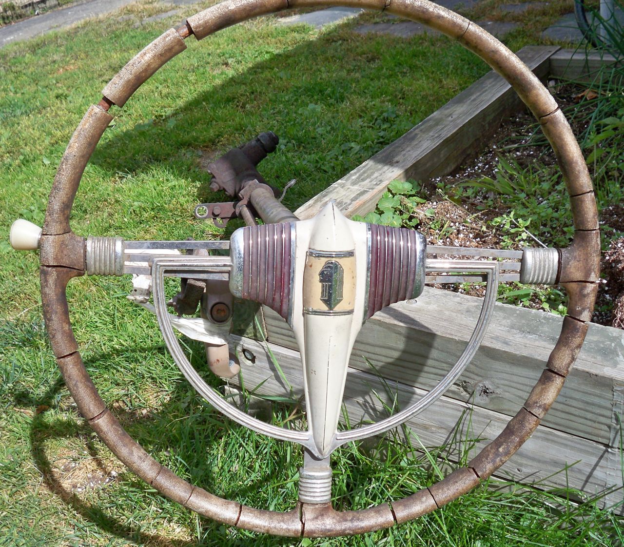

  14. Mr 42
    Joined: Mar 27, 2003
    Posts: 1,215
    Mr 42
    from Sweden
    whats this wheel from???

    1941 Pontiac Woody only ...........................
